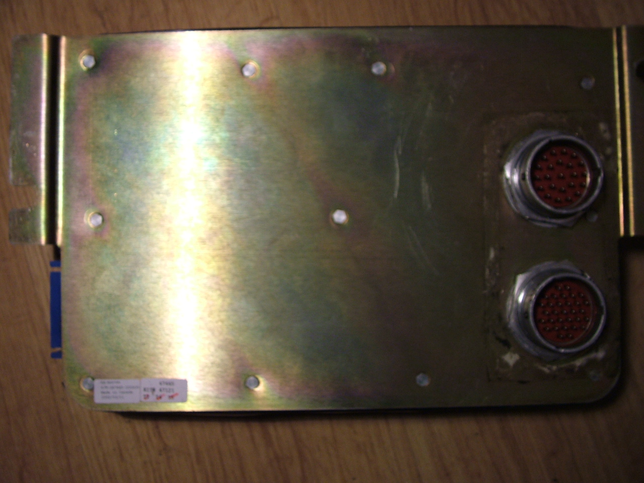

Hello .About transmission module to New Holland 8870 or New Holland 8670 I have gearbox module in 100% working . ( I could give starting guarantee) Part number is Mdl: 86027395 If anyone from forum members need that unit send me a private message . DSCF6773NR 1.JPG

Hello AMARTHA.Check (replace with another from gearbox) reverse valve (on gearbox ) . If its not help, I can repair that module or send You used one (good working at 100%). Send me message on priv
   / Help please! 8870 stops moving and won't go back into gear #8
where do i find the reverse value?
   / Help please! 8870 stops moving and won't go back into gear #9
On the casting of the gearbox is the inscription REV near revers Valve (between MC1 &Mc2) .When You sitting on driver chair ,valves are under Your right leg On gearbox
