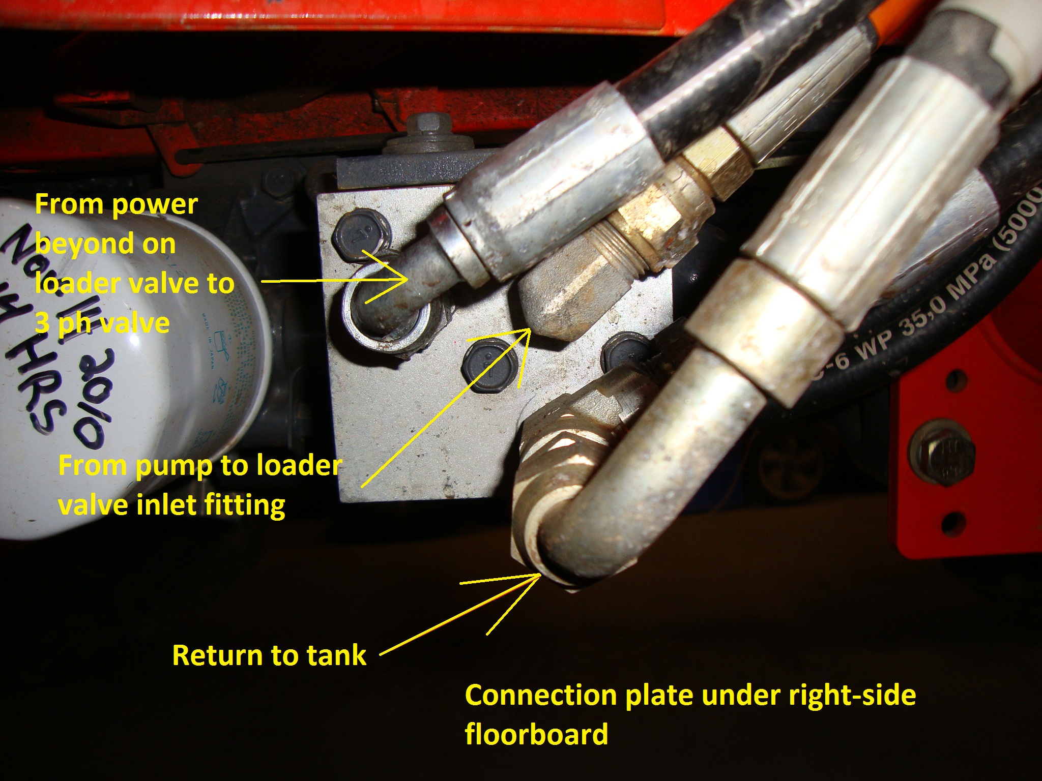

   / Help on plumbing in front remote into loader on a kubota L3130 for a FEL Log splitter #4
The PB from the FEL feeds back to the block, and a port from the hyd blk goes back to the 3pt.
You could do this.
Take the PB from the FEL and run it to the IN port of the new front remotes.
Take the PB from the front remotes and run it back to the hyd blk.
All tank/return lines can be teed together.
Your hyd blk may look like this.
