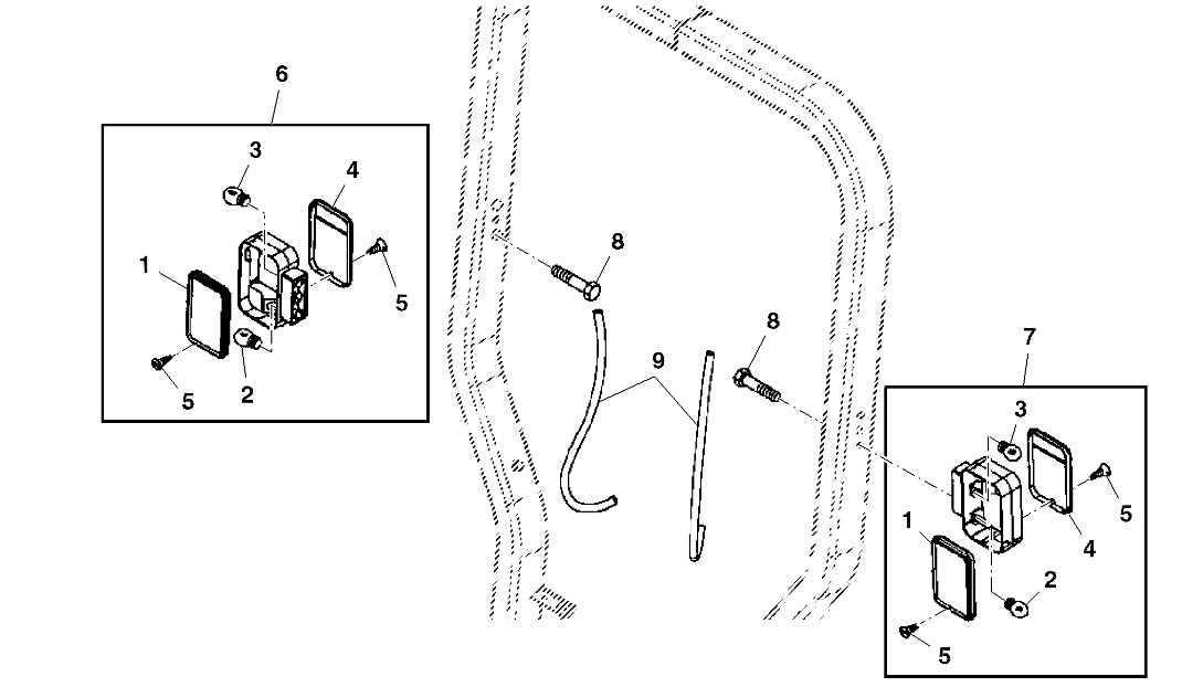

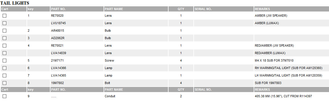

Anyone know the part number for the yellow flasher assembly on the ROPs? A tree branch broke one of mine today. I sure could use a diagram to find the connection as well.
   / Help on 3720 part number #2
This should help...
