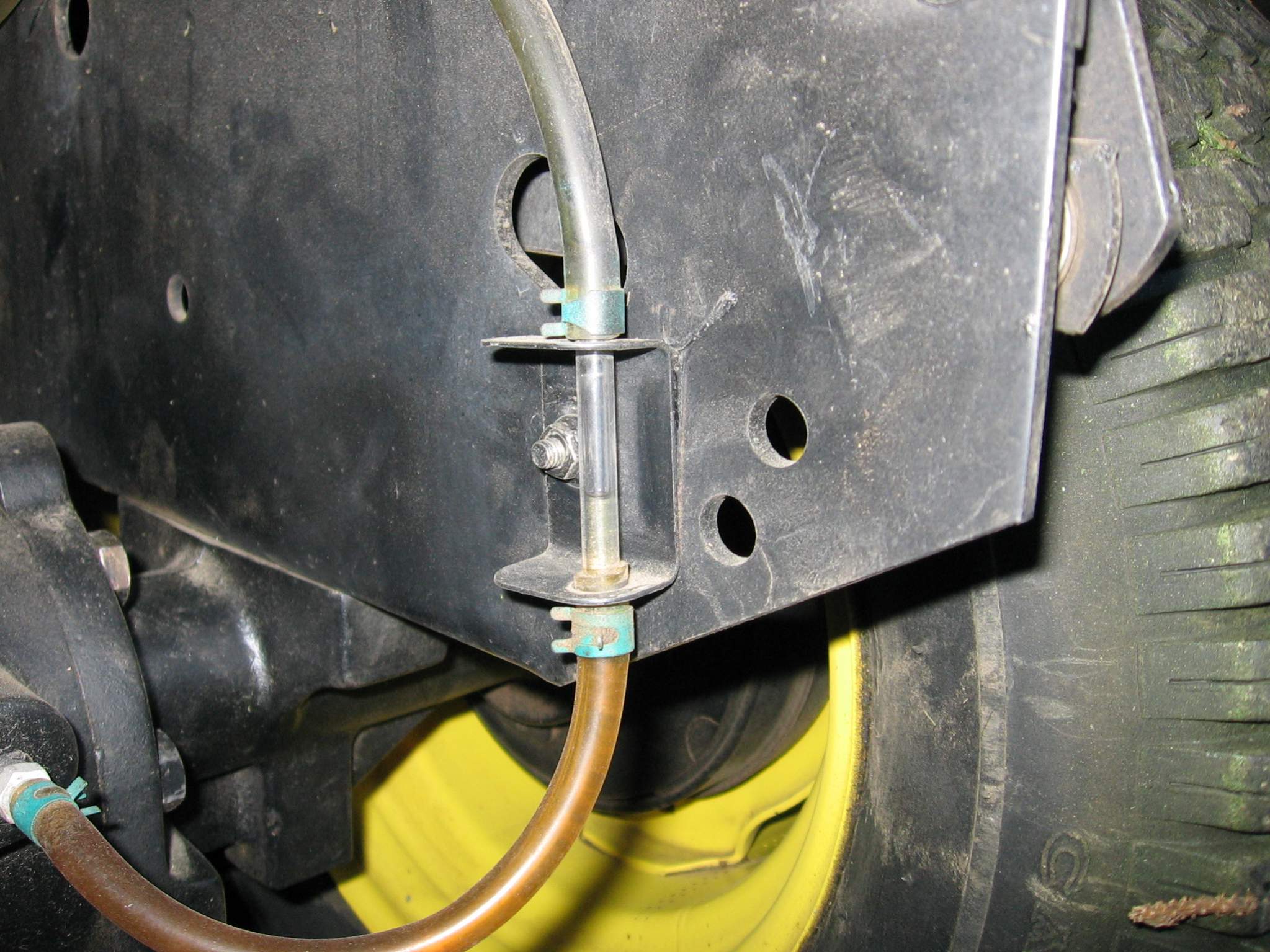

Ok first off the hose on the back should have a clear tube so you can see if the hydro is full of fluid. It should be in a bracket on the right hand side as you are standing in the back looking at it. Fix that first. Now to fill it up with fluid , open the hood and on the left side by the battery there should be a cap. Take it off and very very slowly pour a little hydro fluid in. It does like to take it fast at all. More like syrup in the winter time. If after doing that it still will not go in reverse remove the fender deck and on top of the hydro you will see 2 hydro release valves on top. More then likely one of those are stuck or need to be rebuilt or fixed. Hope this helps some...........KJD

This picture shows what KJD is talking about. Like he stated,you definitely need this fixed first so you know where you are with the fluid level. Obviously,it is low. The fluid level should be within the sight glass.
The two little "pistons" that you referred to are the pressure relief valves. When you want to tow or push,normally you would move the lever to depress the two "buttons". If they are depressed already,when the machine is started and pressure is made,they would normally pop up. If they are froze,you may want to take them out and try to free them up. New ones are still available from LJ Fluid Power in Denton Michigan.

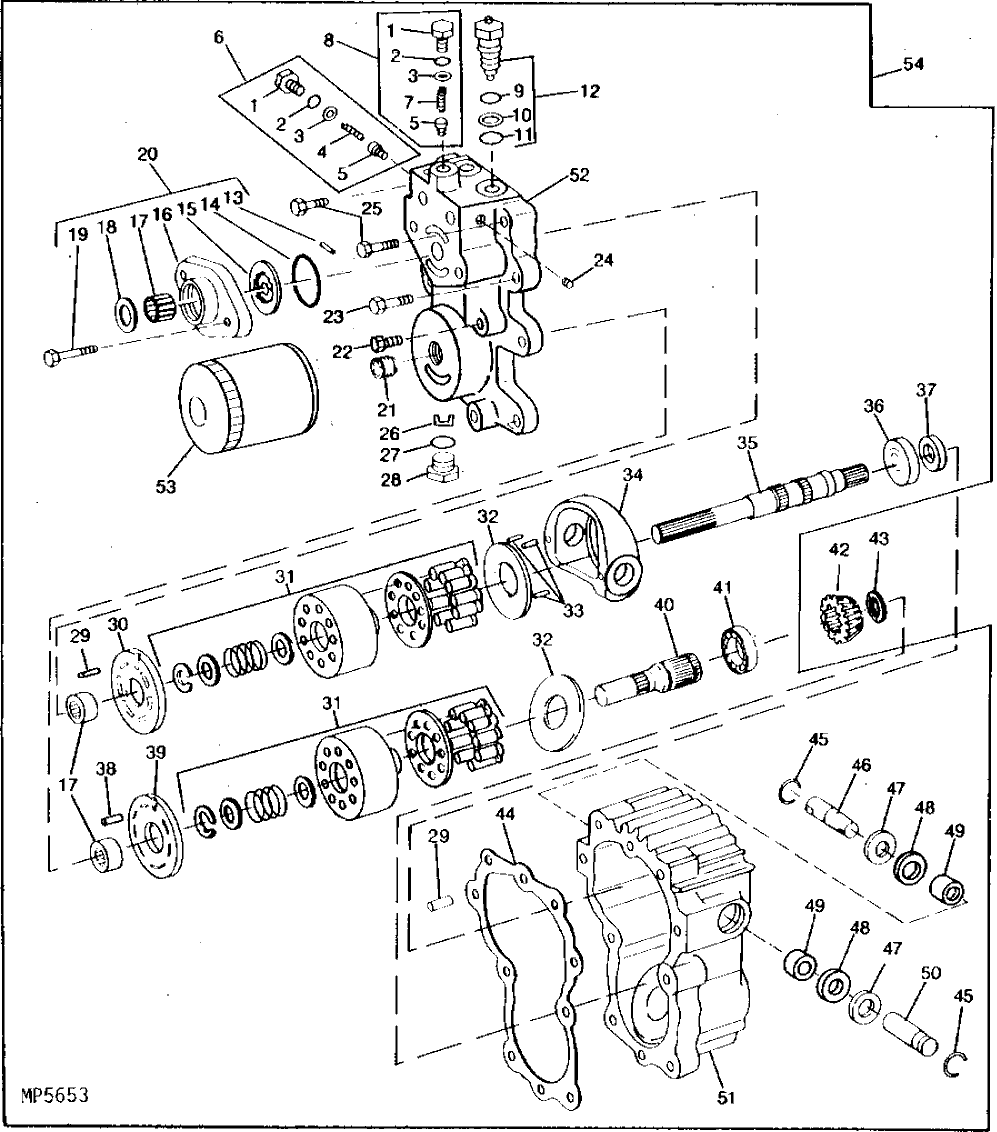

You probably need to change the hyd filter also(part #AM39653)

Thank you to all who replied to my post. I was working on the tractor last night for about four hours and noticed what you are all talking about. The upper pistons are free and moving, but were not pushing up before while the engine was running. The sight glass in the rear is intact, but someone installed a splice made from a plastic nipple and that is what broke. I will repair to the original format.
Thank you for the picture,that is a big help on knowing what it should look like. Is there a special hose material that I need to use if I replace both in the rear hoses as shown in the picture? It appears very similar to hose I can pick up at a local hardware store by the foot. Can someone shed some light on this topic for me? Thank you
   / HELP! Old 318 will not go in reverse #6
That hose should work, as long as it is the same id for the fittings.
