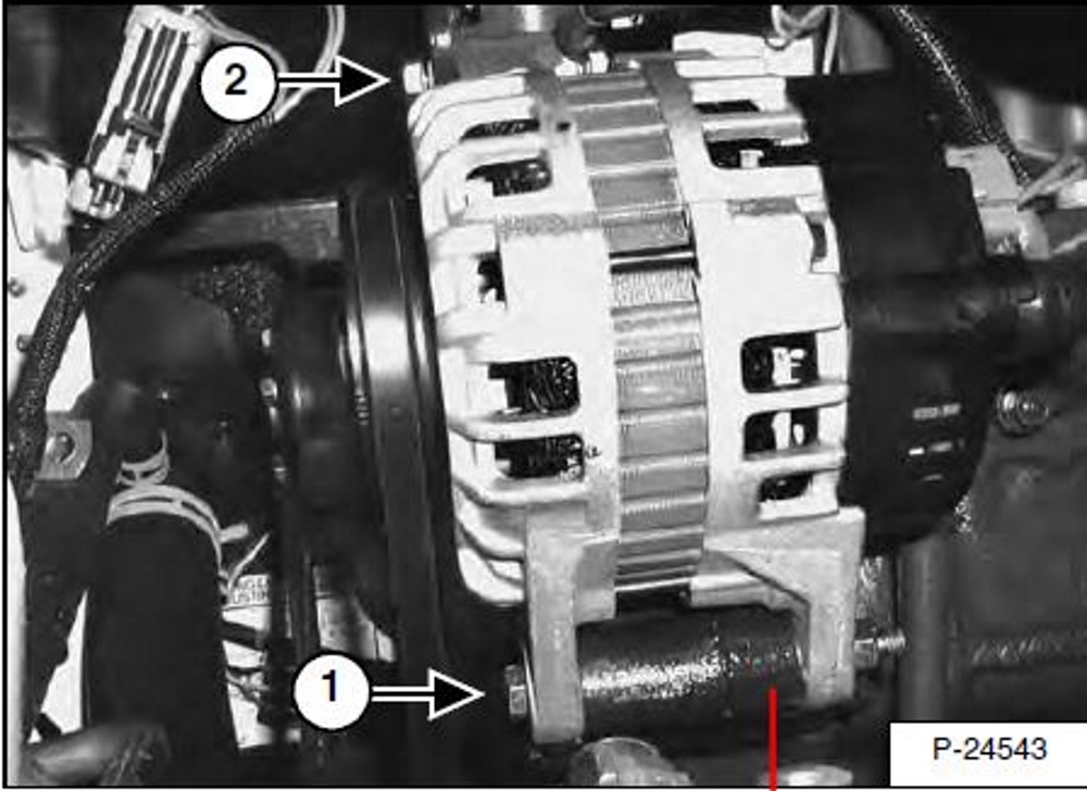

The bushing tube the parts guy gave you comes with the alternator, you also need bushing part number 6817556. Here is picture of it mounted.
   / help new to me s175 alternator mounting problem
SSdoxie thank you. I was missing all of that meaning not on the machine. the bottom bolt both bushings and the nut where all gone.
Is there a way I can blow that picture up bigger besides clicking on it? the ear on the gear cover is worn a bit so I might have to replace that cover. My next question: It looks like I might have to undo linkages to the injector pump? will the injector pump need to come off or will there need to be something timed? I guess what I am asking it whats enolved

You'll still want the dampening effect of a bushing on both sides of the alternator to keep the diodes and other critical parts from being vibrated to dust. That's why they're there in the first place. And not just between the ears but to suspend them from the entire hole section the bolt/sleeve passes through.

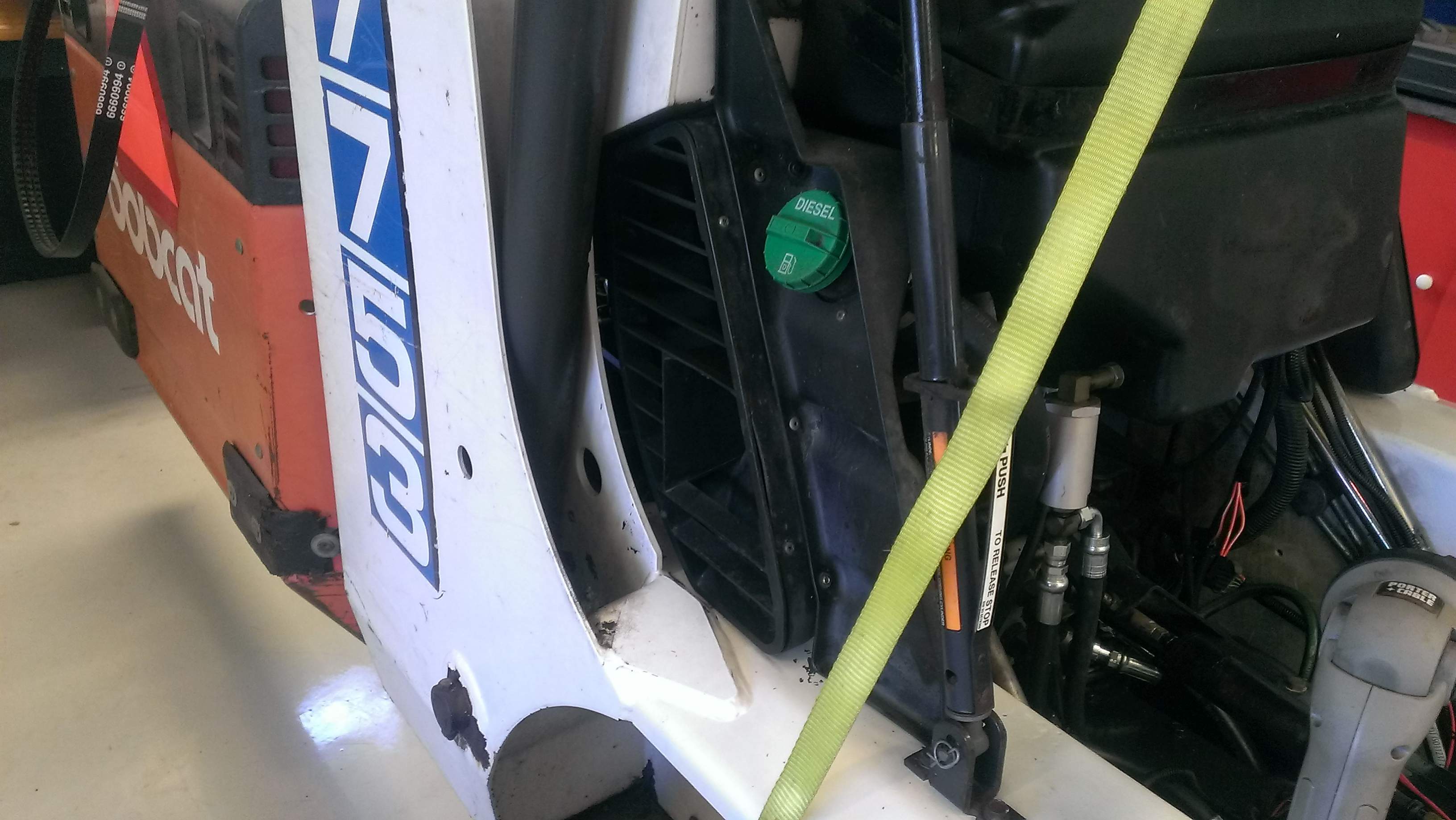

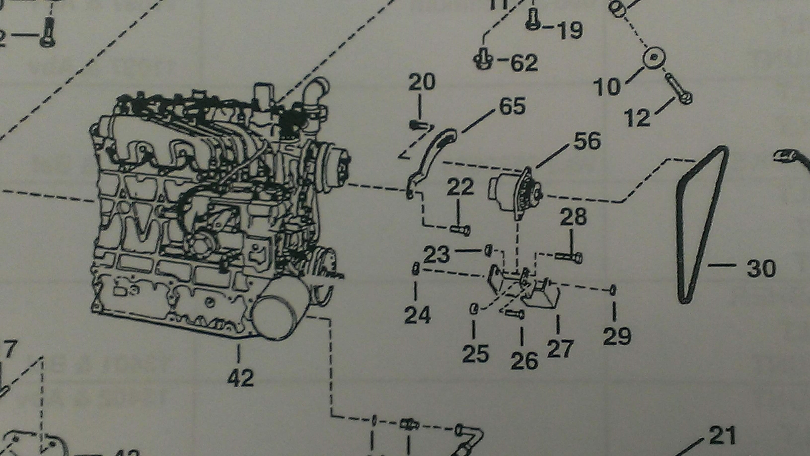

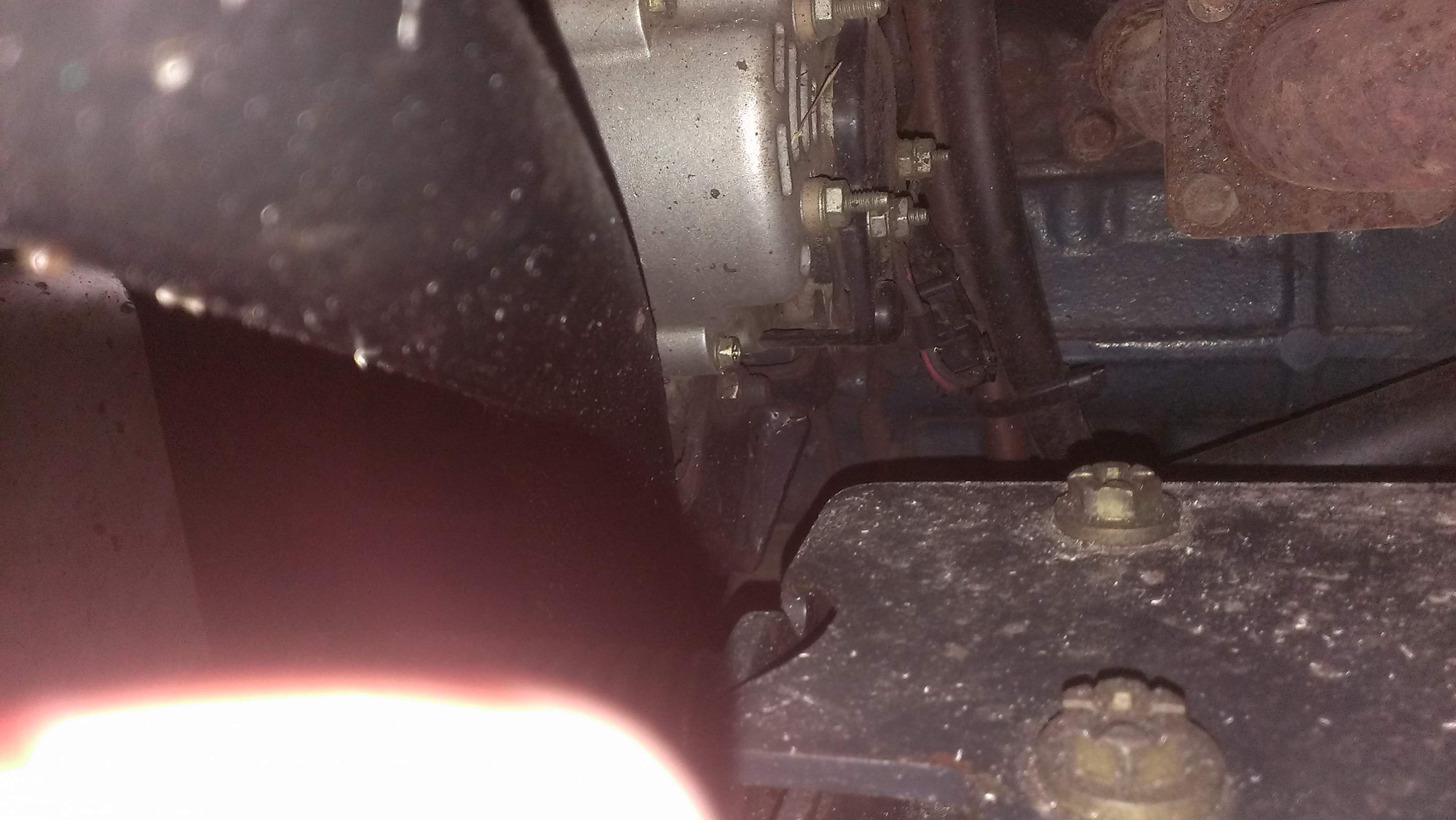

Took some pics and here is a page out of the manual for mine anyway. They should be the same but different. Looking at it the alternator mounts to a steel bracket then the bracket mounts to the front gear case cover. I would not want to have to replace that cover.
If you remove the fan duct and the plastic bracket for the fuel fill you should be able to get to a bunch easier. First time will bite, they are riveted together.
if you look close you can see the steel bracket.

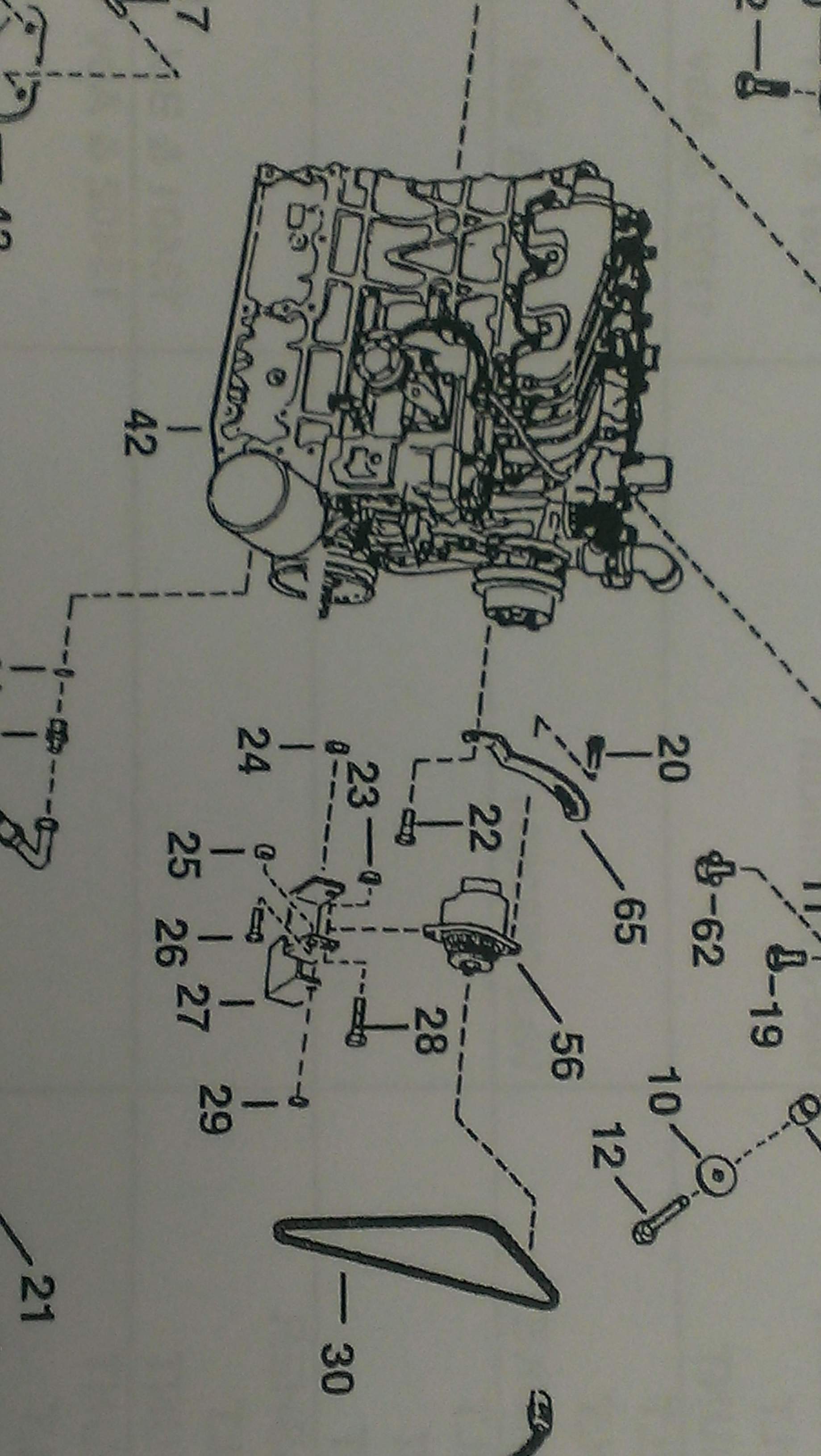

Here is the page out of the manual for a 7753. The alternator and mount has been a battle for me also. If you do go in there and mess with the bracket, might I suggest having the alternator rebuilt. Throw a set of brushes and clean the slip rings, while it is out.
