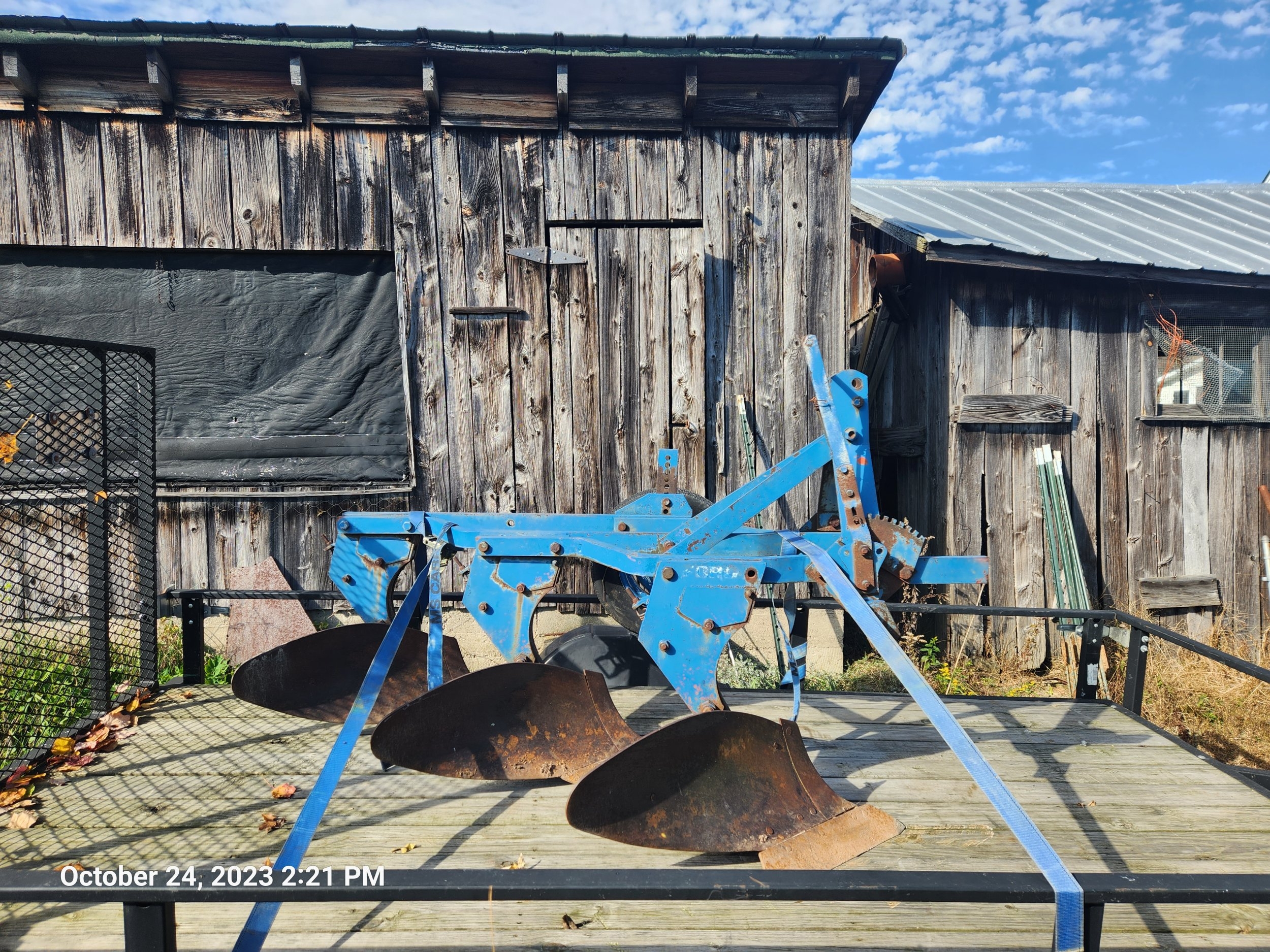

Kubota M7030SUDT LG mt352pct
It says ford on both sides but I can't find any that looks the same. What model do I have???

No tag anywhere?
Bottoms, 10-404 or 10-405 look like this:
Frame 10-458 or 10-459

I agree. The Landing Lever is the primary clue. The resettable Trip Mechanism is the second clue.
I bought a two bottom Ford 101 series plow from Ken Sweet (above) several years ago. In excellent condition, with Landing Lever and reset trip mechanism, I paid Ken $1,200 including shipping.
Many plowmen consider the Ford 101 series plows the finest ever produced for compact tractors. Vintage three bottom plows are usually sell for less than vintage two bottom plows. None of the Series 101 plows were produced by Ford. There were several contractors who produced plows for Ford, Oliver being prominent.
Here is how the trip mechanism looks internally. Mine needed coagulated grease and dust removed.
