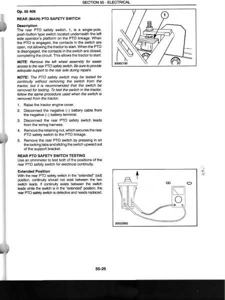

Don't know for sure, but I'll reply with the service pages for Class III tractors - switches may or not be the same as Class II. Rear PTO attached.
Even though the plungers may activate, the electric connectors may not be working. Did you test for Open/Closed connections with the switch?

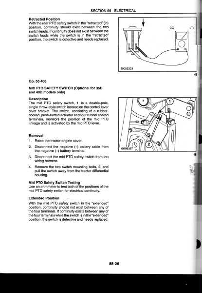

Mid-PTO switch position and testing.
