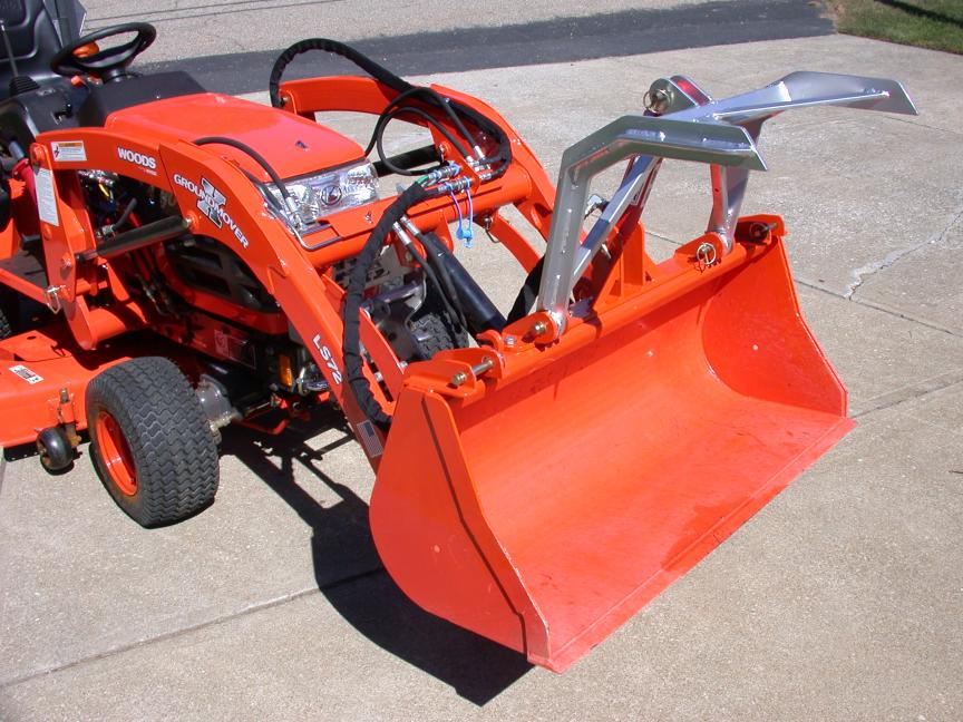

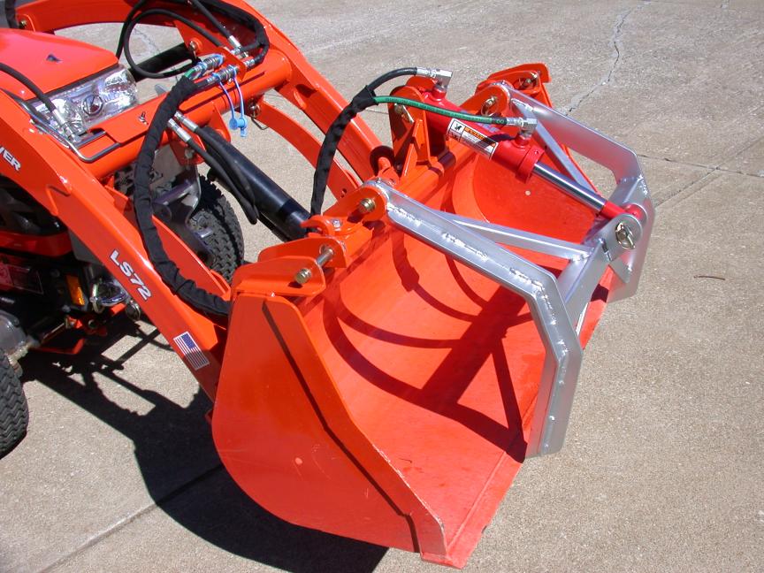

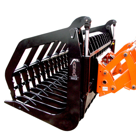

It is going to be trial and error. If you already have the cylinder, then you know the stroke. You now have to find two points on the frame and the grapple, that will raise and close the grapple to your satisfaction. You could put the cylinder on top of the grapple or behind the bucket, pushing or pulling a short leg past the roll over point.

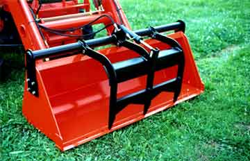

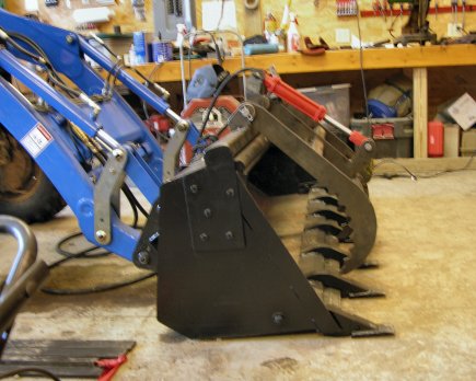

4440, I know what you are going through I just did my grapple. I can tell you what I did. For me it was like JJ said trial error. Get some 1" X (3-4") wood, use the same width as your cylinder dia. when test fitting it will make sure you do not have any clearance problems with the cylinder hitting the grapple. Cut one piece to 26" and drill three 1/4" holes or what ever size bolts you have. One at each end 1" in this will be your open length 24" and another hole 6" in from either end hole this is your closed length (18"). Cut another piece of wood so the pivot hole will be about 3" (starting point) higher than the grapple mount pivots, then one more piece for the cylinder mount on the grapple. From there you can test fit your mounting locations open and closed. I was also having trouble getting the grapple to open far enough, I found that the height and location of the front mount on the grapple itself made the biggest difference in how far it opened. I know this seems low tech, but wood is a whole lot easier to cut than steel.
