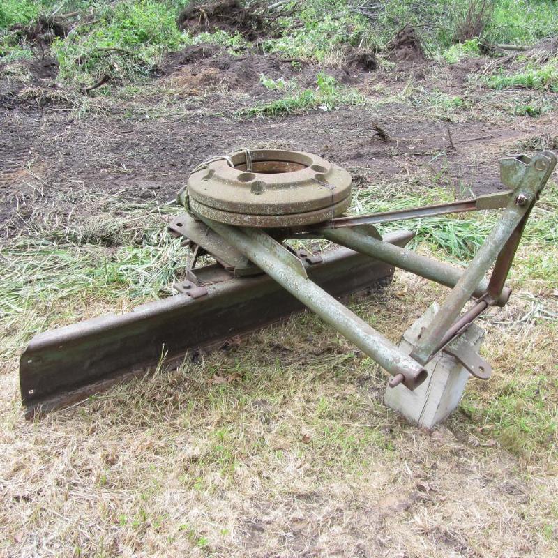

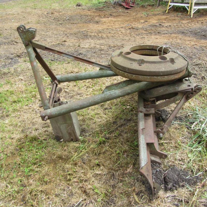

This blade is for sale about a 90 minute drive from me, I'd like to see more of it before driving all that way, and since it just dumped a bunch of snow here, I doubt I'll get better pics from the seller any time soon. Wondering if anyone recognizes the make of this, it looks older, and more sturdy than the "typical" Tractor Supply type you see a lot these days.
I'd like to find an older unit with a well-built blade with more actual metal in it than the affordable new ones (which this seems to have, but I can't see how the mechanism functions from the pic.)
Thanks!
Scott in Penfield NY

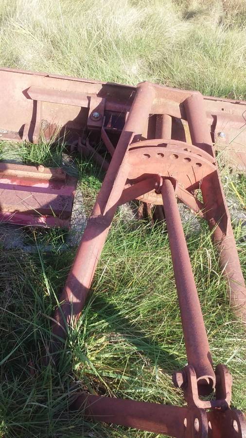

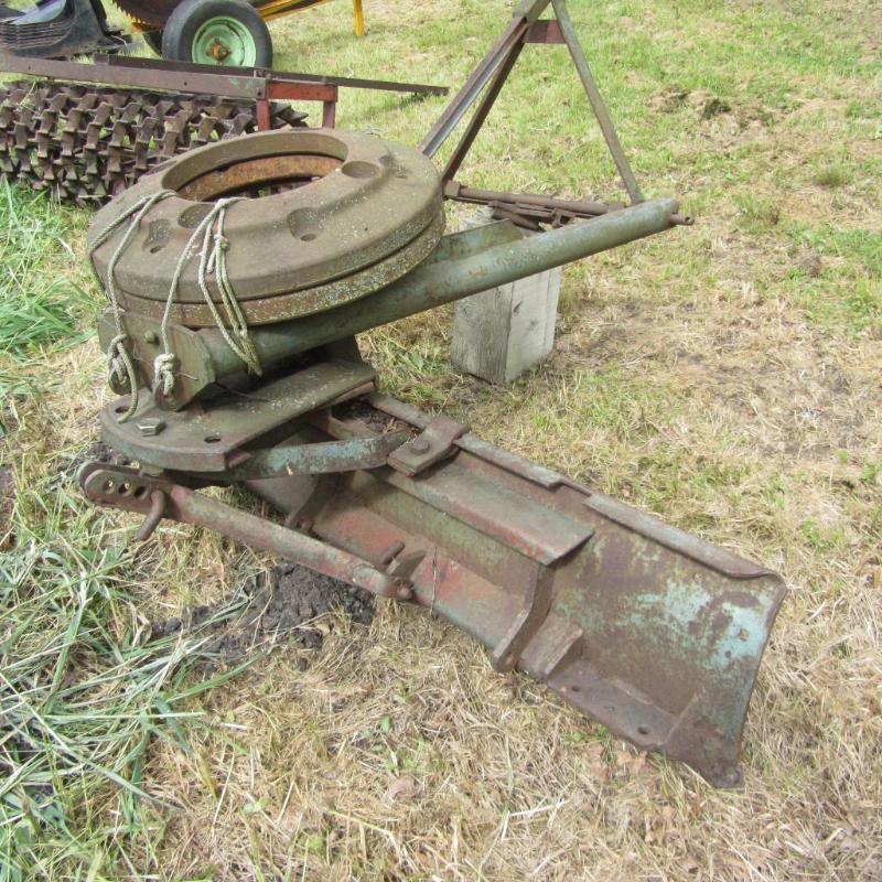

Well, this looks like maybe the same model, gives me an idea what I'd be looking at. The one for sale appears to have some welding on the frame sides, though.
   / Help me identify this old back blade? #3
Some of the older fords were built like that one! You have tilt with the vertical part and you have to loosen some bolts for the offset if you need it.
   / Help me identify this old back blade? #4
I just saw one that looks just like your pic on our craigslist, it's a massey-ferguson
