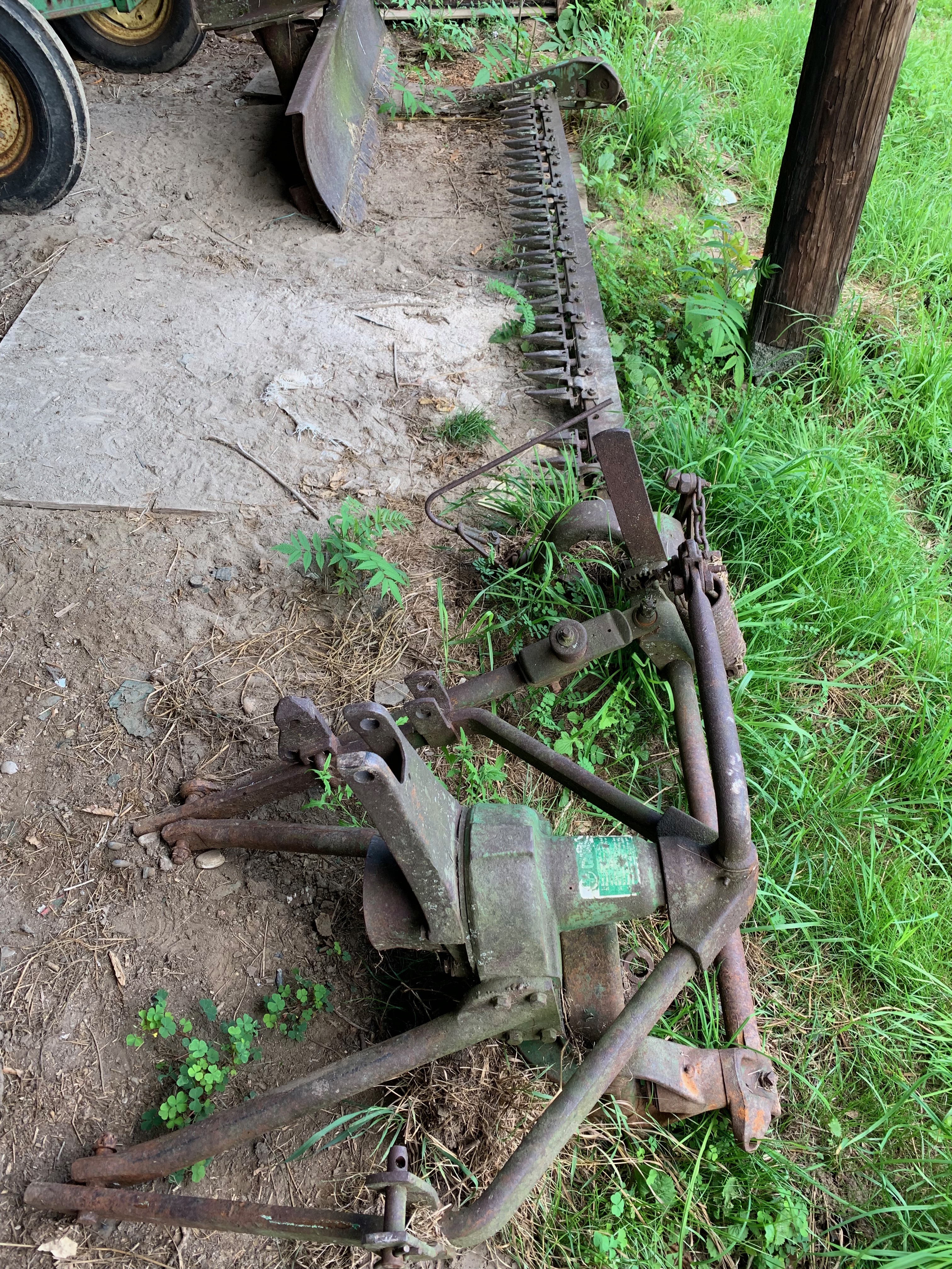

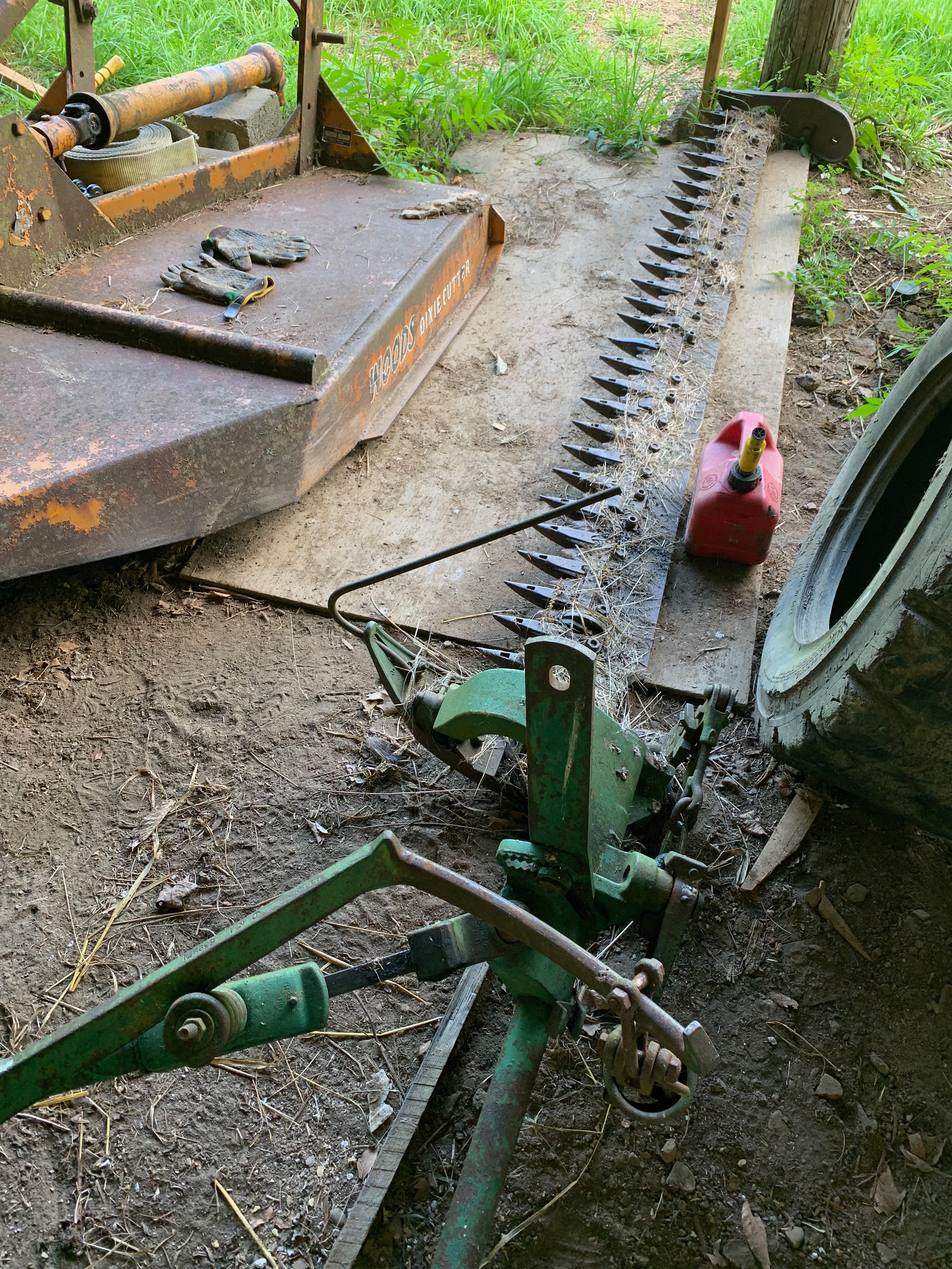

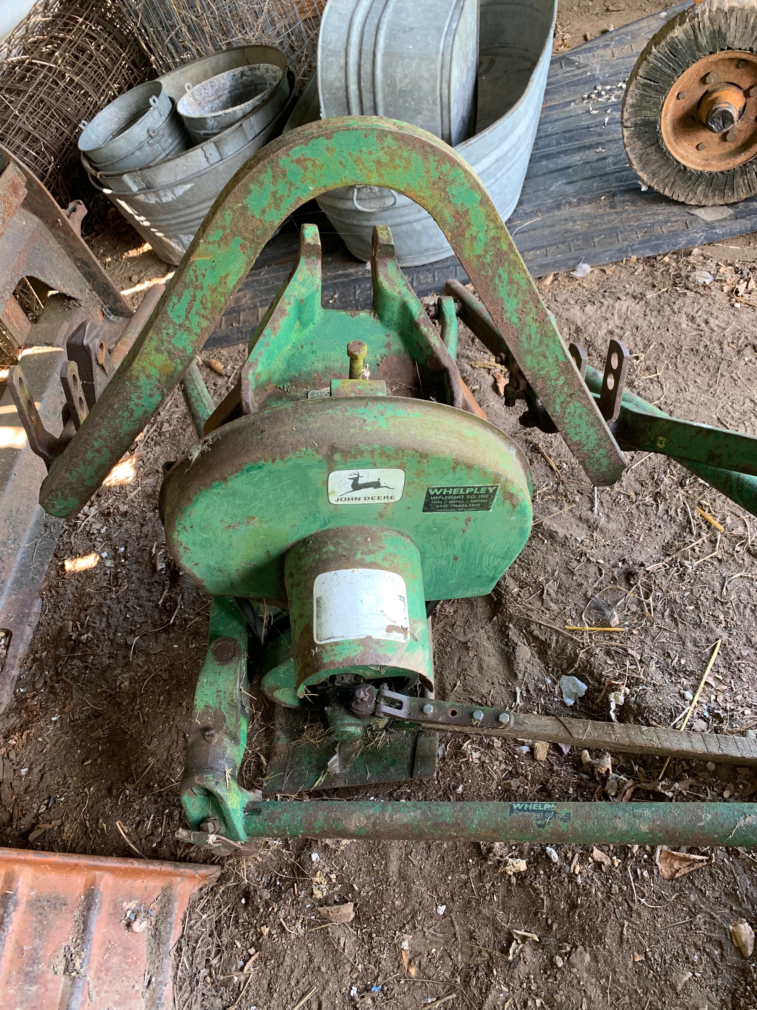

I'm new here, and hoping you can help me find my way around some old equipment on the family farm. I specifically need help identifying the models of two sickle mowers. The first one is a John Deere 7 Ft. Sickle Mower, Serial #252224. I can't find any info on the model. I haven't had ANY luck finding serial/model numbers on the second, smaller one.
I've included some pictures below. Any help is appreciated!
   / Help me identify a couple old attachments #2
The bottom picture looks like a #9 mower. The model and serial tag was riveted where you see the two holes in front of the green safety sticker. It's missing the knife and sections, they can be purchased from Your one-stop cutting parts source, Webb Cutting Components . Can't ID the top 2 pictures. Look on inner shoe, or any other pieces, for cast part numbers. Go to JDParts: Homepage and enter the part number. Should be able to help ID it. I've got a #9W that shares most of the parts of the #9. Bought it cheap enough to bring home and rehab it enough to use. Found a #9 dirt cheap that I bought for spare parts. Hope this helps. Welcome to the forum.
