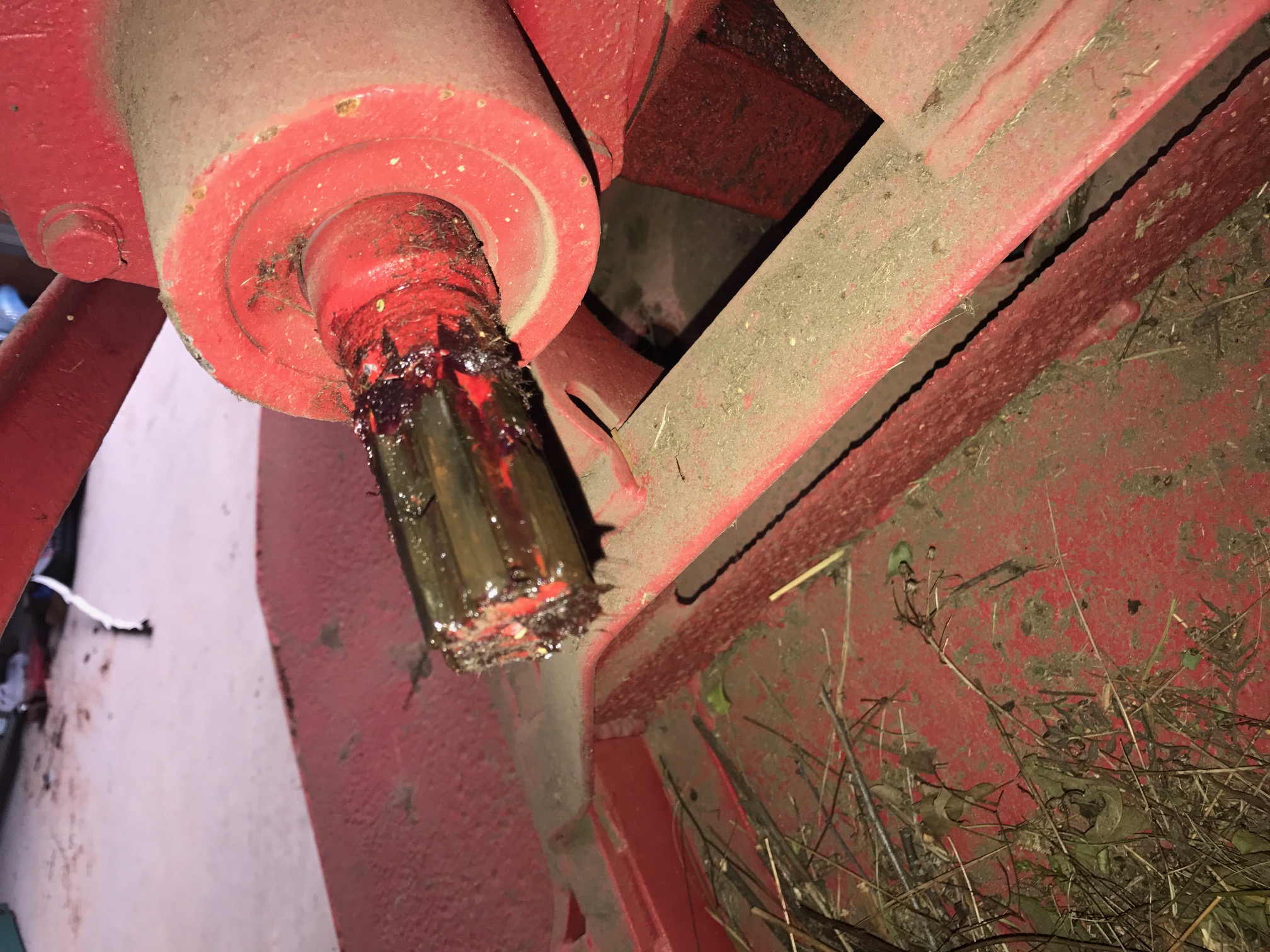

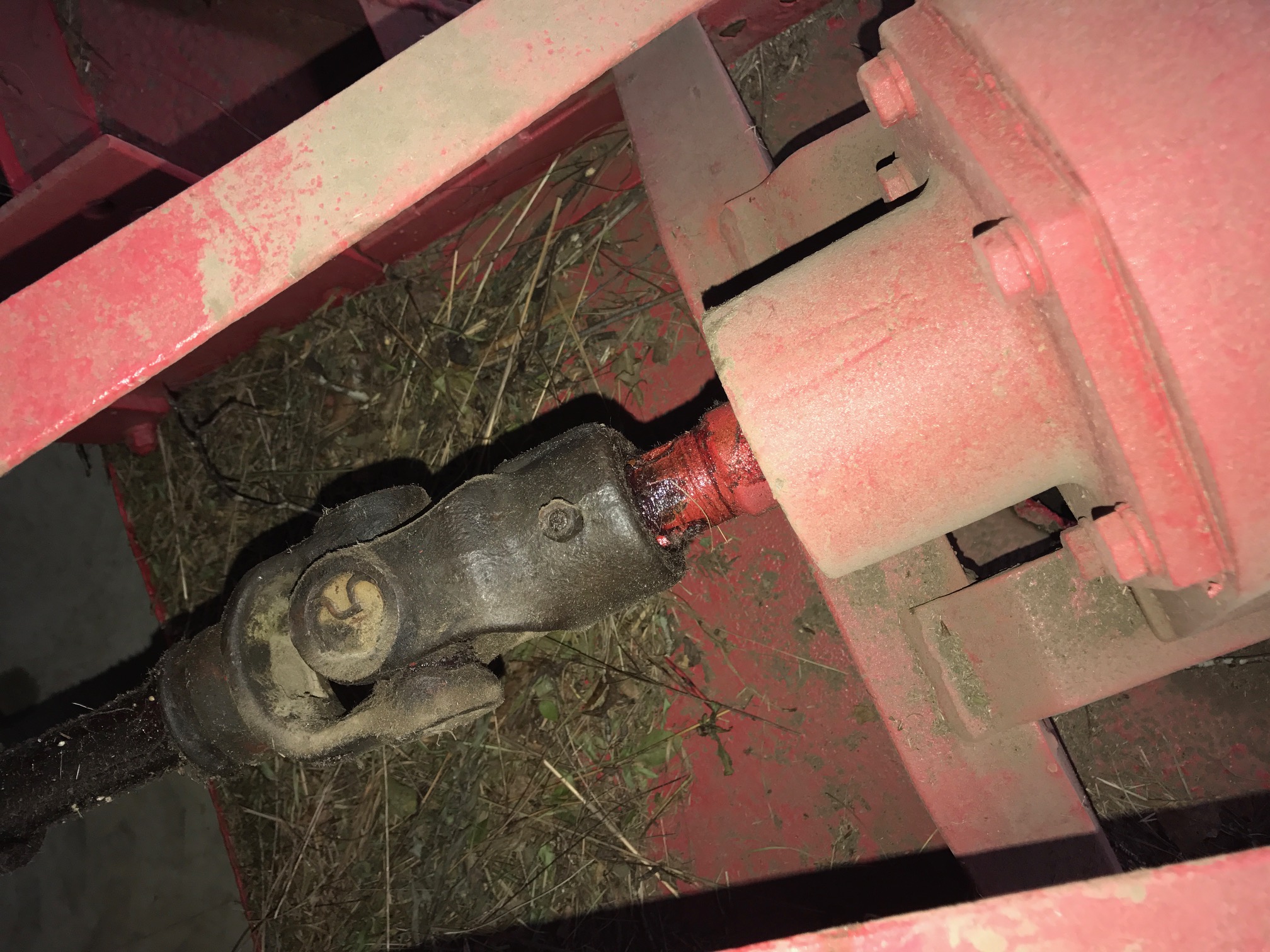

Hello,
I want to put a slip clutch on my Bush Hog 305. Right now its just straight spline shaft. My problem is the male shaft on my 305 doesn't have the recessed ring on it to where most slip clutches connect with a wedge type bolt. Instead, mine just has a small(1/4") hole drilled in the shaft for you to put a small bolt(not shear pin) in there to hold the PTO shaft to the 305. Can you help me locate a slip clutch to work with my configuration or help me come up with another solution?

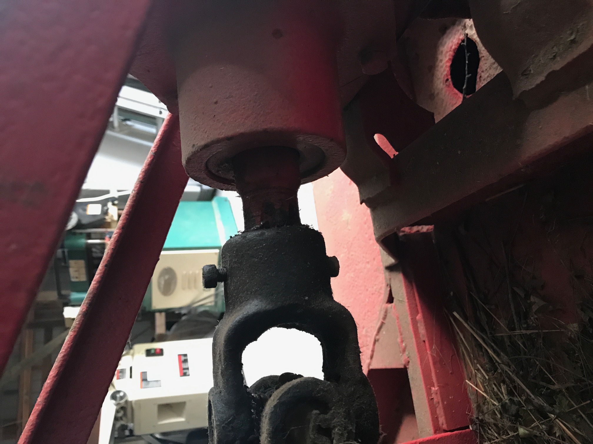

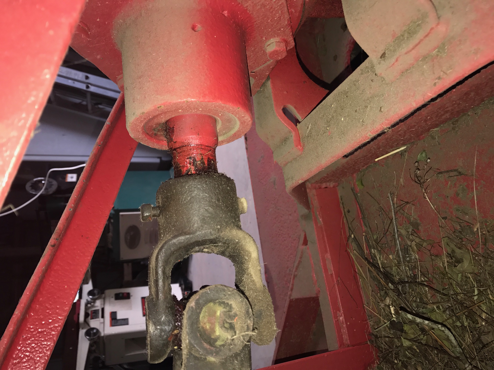

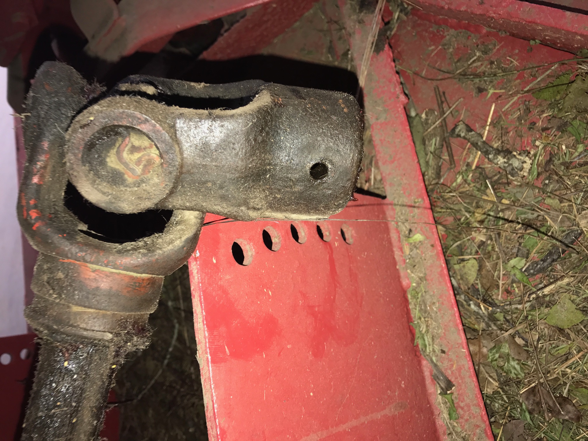

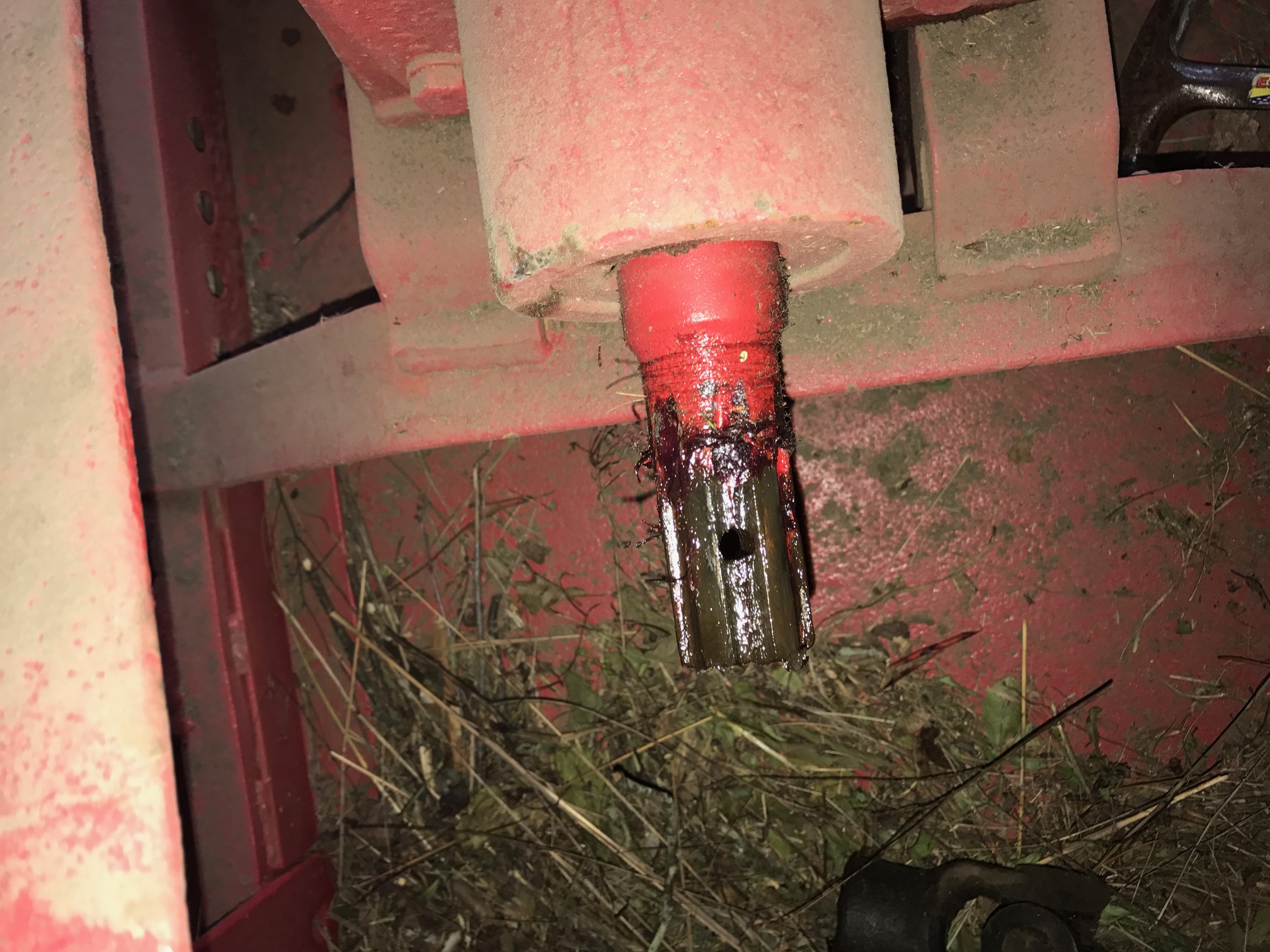

ok so here are some pictures of the current configuration. As you can see the BH shaft does not have a recessed ring, and the PTO shaft is just held on with a bolt, I'm not sure if the clamp on or wedge type connectors will work with my BH shaft. That PN that you gave me even if it will work is kinda pricey at 500$+, with is 2x as much as i have seen with other shafts. If the clamp on type will work even without the recessed ring like what is on the tractor shaft let me know. IMG_0695.jpgIMG_0696.jpgIMG_0697.jpgIMG_0698.jpgIMG_0699.jpgIMG_0700.jpg

You appear to need their clutch assembly - #11 on that post AND you also appear to need the Taper Pin Kit #76064 shown in the picture below the shaft assembly picture
Call the Parts Support people at (855) 667-0970 and they can probably give you better answers than I can...:)

Making a mountain out of a mole hill here.
I'll give you 3 simple options,
1. It the slip clutch you buy don't have the 1/4" hole to retain it to the bushhog shaft.....Drill one. Its not under any extreme load. The splines do that. The bolt is to just keep it on the shaft.
2. IF the clutch you buy dont have the bolt but has the pin designed to be in a groove in the splines (like most tractor side PTO shafts), then just grind the little groove in ONE of the splines on the bushhog.
3. Put the clutch on the tractor side PTO shaft.

I have this type setup on my JD baler. First off it's under a protective cover. Second I remove the bolt and slide it around every few years to apply some grease on the flange. Last I don't tighten the bolt, using a self locking nut and leaving it slightly loose.
I do the same with my regular "hole in the shaft" shear bolt installations allowing for a little slop which allows a little vibration which keeps the interfaces worn slick, ready to shear when needed.
