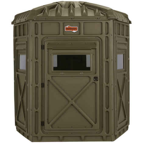

Over the last couple years, I've wanted to build a tower-box blind that is portable. I have a couple sets of wagon running gear that I believe will make a good portable base. I've thought about just hammering together some simple walls with windows but I've started to look at the commercial box blinds that are available, and for the price, I don't think it's worth going any other way. Something like this:
Now, what I need help with is thinking of a way to be able to raise and lower that blind up to maybe 10 to 12 feet off the ground. I could build it right on the running gear but that would only be about 2.5 feet off the ground, and what fun would that be (insert Tim "The Tool Man" Taylor grunt HERE). I'm thinking that the ability to lower the platform will be crucial to being able to move the blind through the woods.
Help me out TNB'ers! How can I build a platform (with the blind attached) that can be raised and lowered?

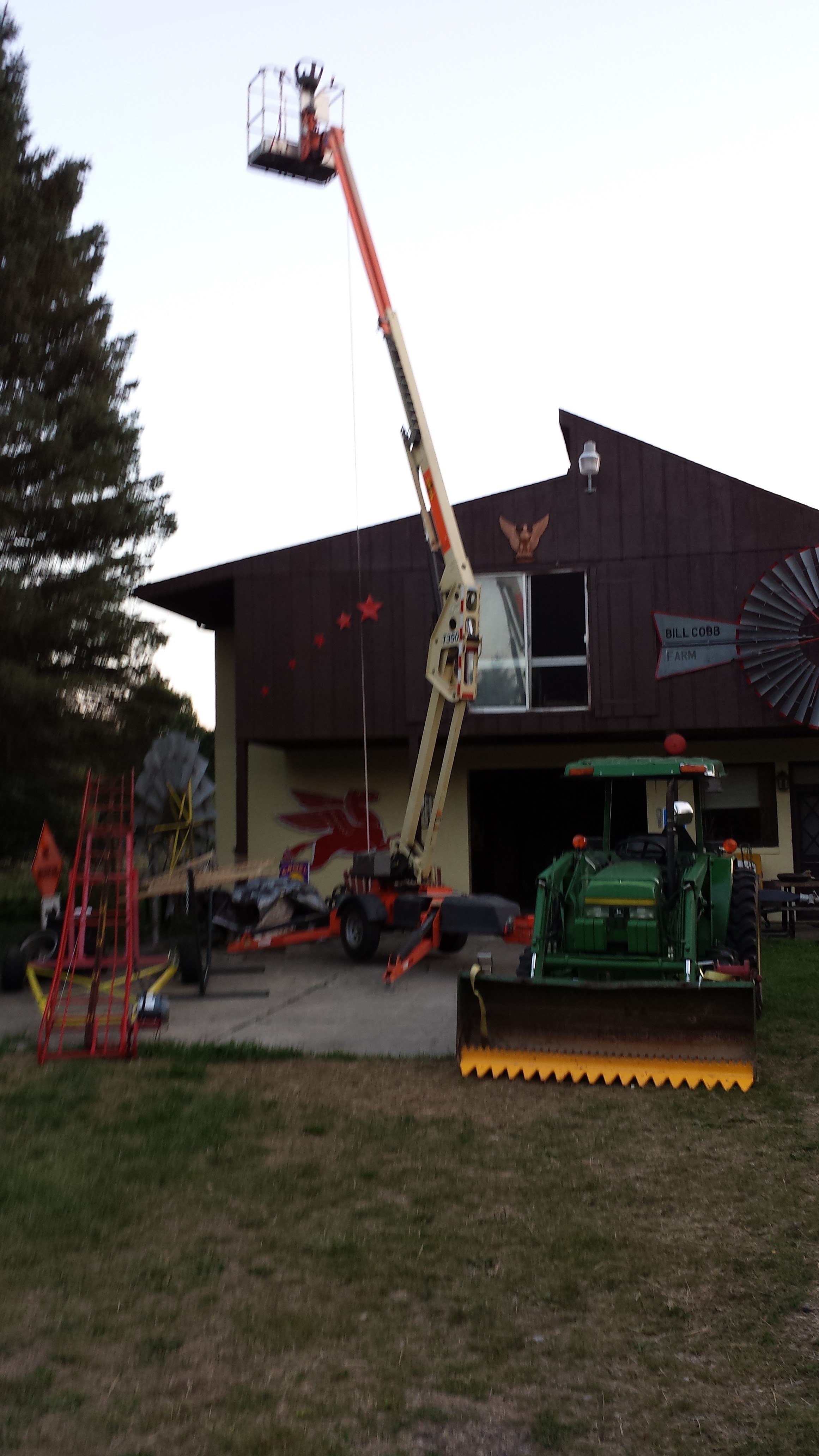

I bought that same Terrain two man five sided tree stand, last winter the snow collapsed the roof. I never saw that coming, now I will put a light weight jack post in the center and a ratchet strap around the very top of the walls after season is over. The blind wasn’t cheap, $700.00 at Fleet Farm. The roof is now 6” lower and the top of the side walls are bowed out.
We had an unusually heavy snow last year here in central Wisconsin, but still didn’t expect that.

$700 for basicly a large outhouse size building and the roof collapsed? Sounds like there not made very well.
