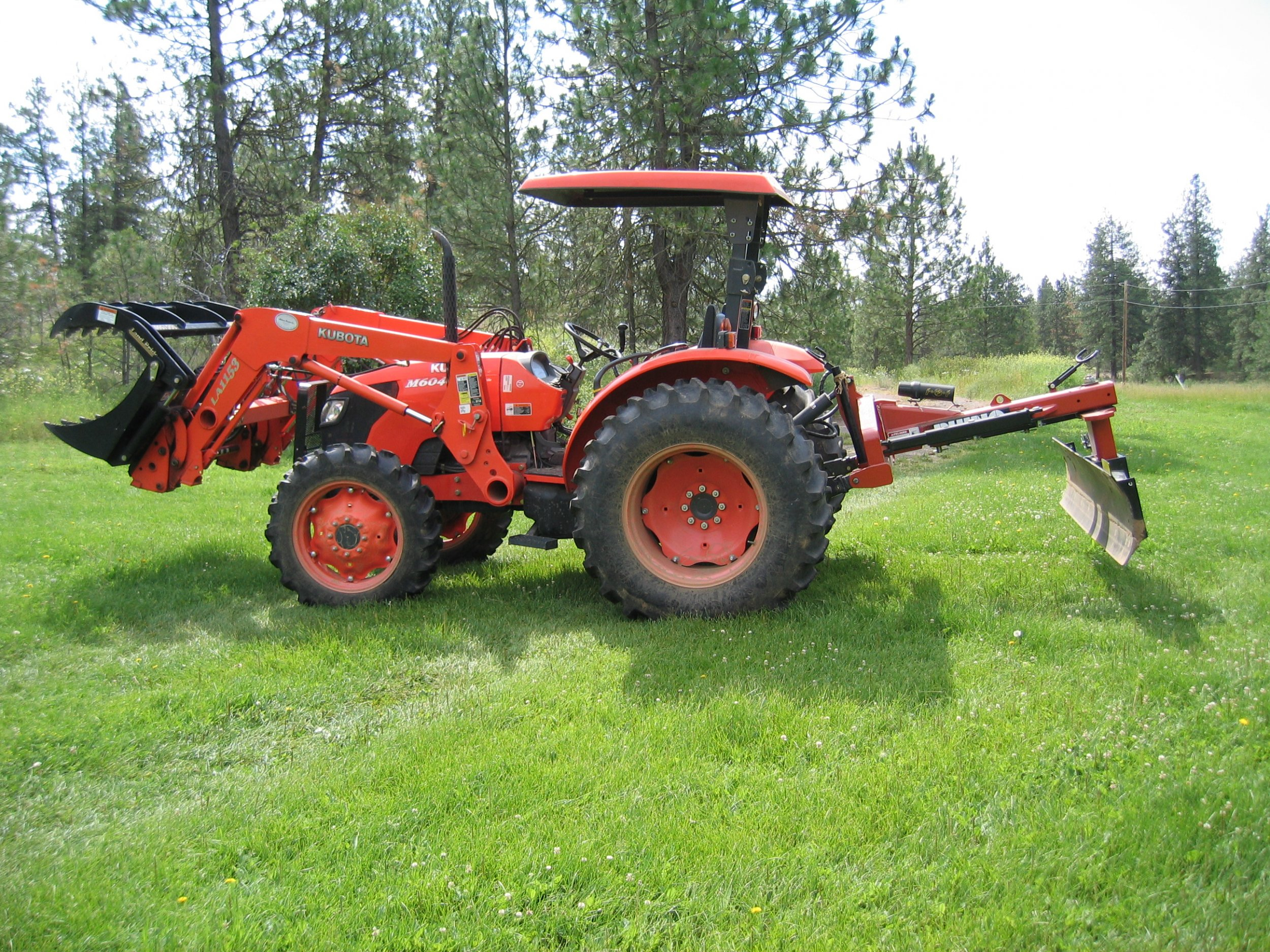

My Kubota M6040 has R-1 tires. The rears are filled with 1550# of RimGuard. I need the added traction of R-1. I don't need the added strength of the R-4. My first tractor lasted 27 years with R-1's and they still had over 50% of the tread when I traded it in.
I do maintenance & plow snow on my mile long driveway. Use the grapple to move large rocks and chunks of pine logs - etc, etc.
My OEM R-1's are six ply. The only concern - my basaltic lava rocks DO take small chunks out of the chevrons on the tires. This would be no different or, perhaps, even worse if I had R-4's. This "chunking action" happens when I let the tires spin.

The R-14's are so new - I didn't even think of them. If you are the "normal" homeowner you will, most likely, average around 100 hours of tractor use per year. I seriously doubt that in this use - you will ever wear out a set of tires - no matter which type you choose.
I seldom run my tractor on my lawns. It WILL leave chevron marks. So would R-4's. The way my tractor is set up in the picture above is it's normal operating configuration. It weighs - 10,100#.

Thanks so much for the info. Beautiful set you have there, that looks like about exactly what I am planning to run on my tractor majority of the time. I like the looks of your grill guard especially.
My original thoughts were to lean toward the R1 like you, but of course the dealer questioned my decision very hard so I'm forced to dig into it more. They sell pretty much all their tractors with R4.
