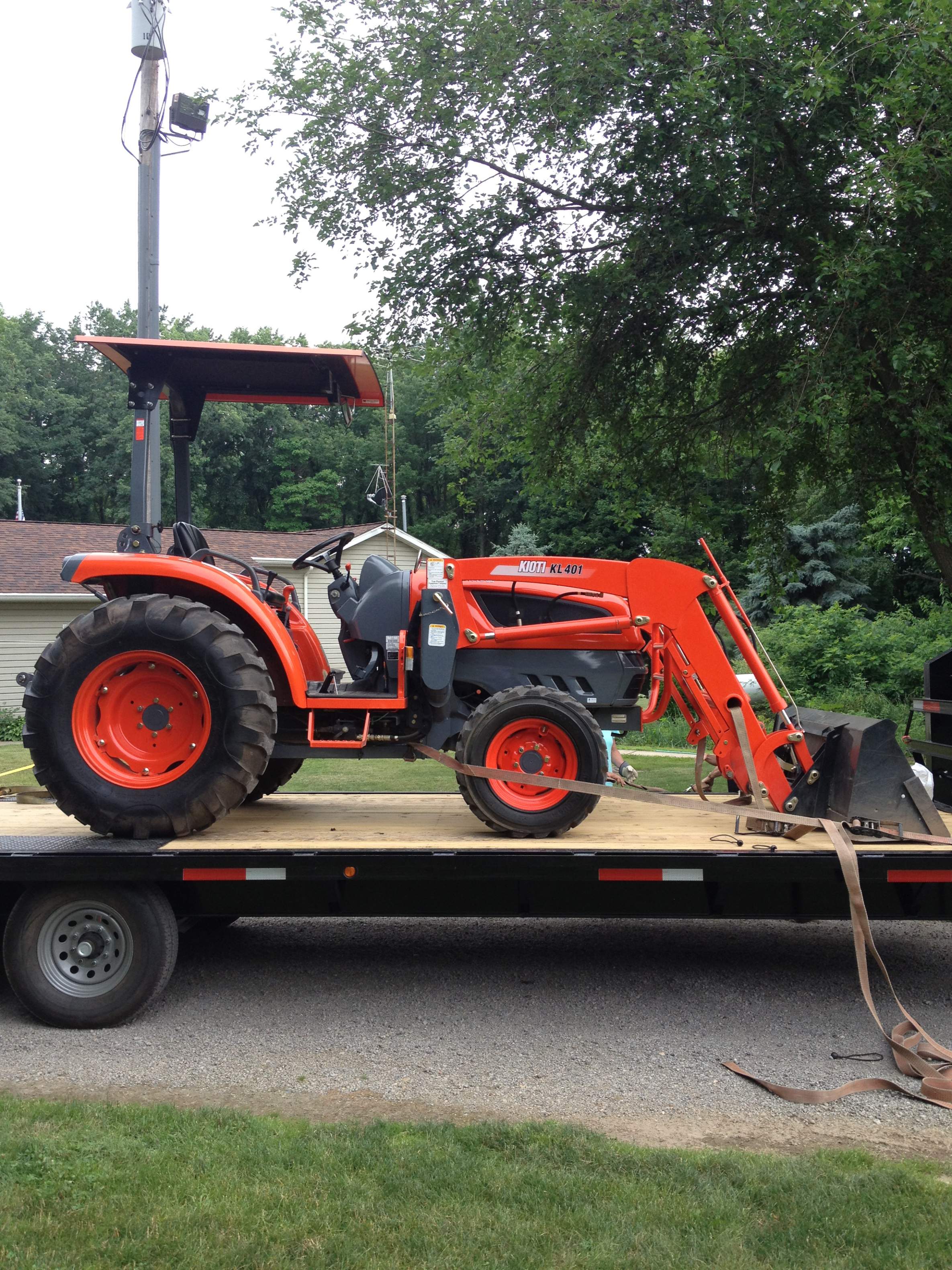

From what I have read & experienced LS & Kioti both make very nice tractors.My experience is from owning 2 Kioti tractors one open station one Cab model.Both have operated flawless.I am sure both LS & Kioti would serve you well.
