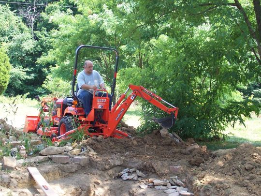

I have the bx23, and also would not trade for something without a backhoe. I have under an acre, but have put in a couple of ponds, see projects, and dug up plenty of stumps that were in the way. Have not dug the drain lines for my downspouts yet, but that is coming soon. here is one photo, others are in pond remake (?) in the projects section.
