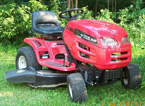

Here's my last year's purchase, that has mowed ~ 4-5 acres of lawn about every week (sometimes every other) during the mowing season, still on the same belts, and blades (3 with 46" deck), and every now and then tows a 15 cu ft. trailer with misc. garden paraphernalia galore... /forums/images/graemlins/smile.gif
With a twin B&S 20 hp, 46" deck... Automatic... Nice! (never owned a rider before, let alone an Automatic...)
My very own hydro... I feel just like RaT!... /forums/images/graemlins/grin.gif
Oh... with 40% OFF... I paid a grand total of $629. /forums/images/graemlins/wink.gif
