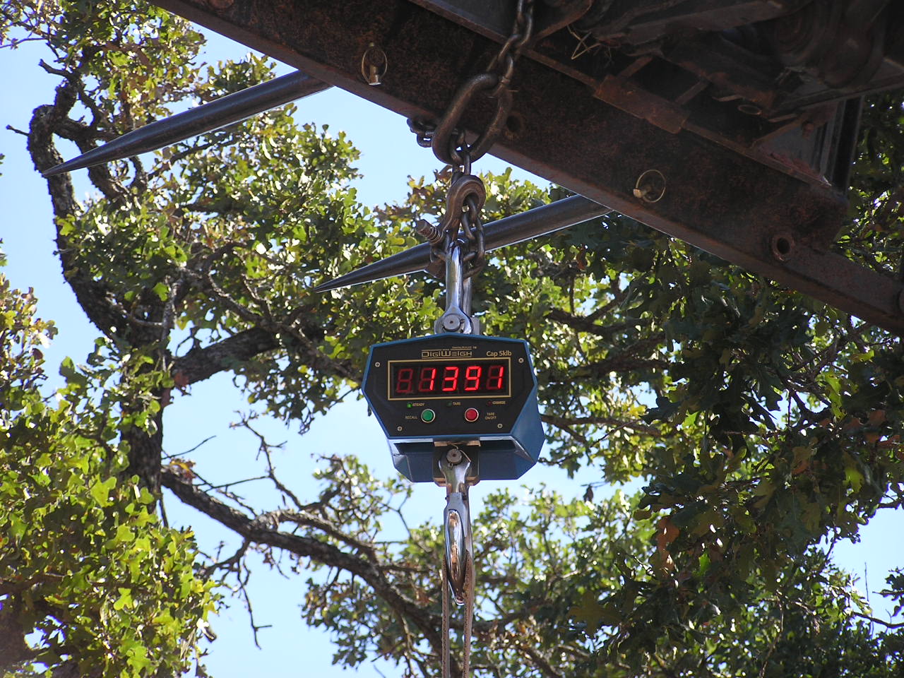

The 5x6 round bales that I deal with weigh from 1100 to 1500 pounds.
