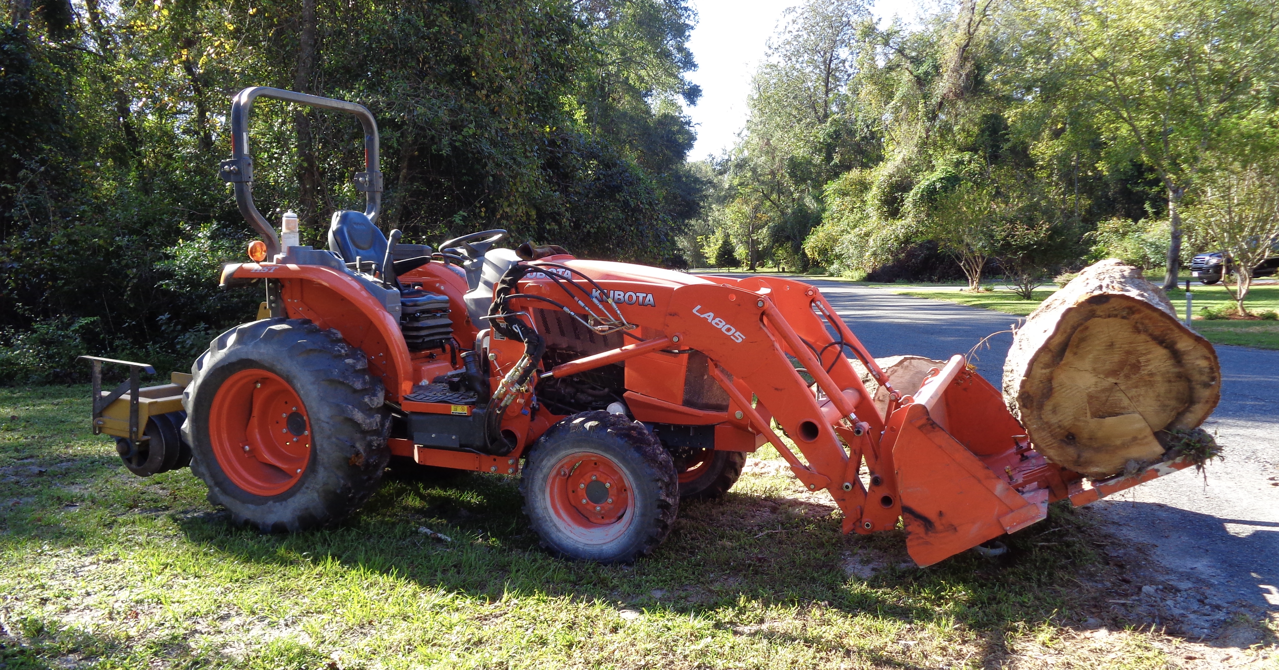

I own a Kubota L3560 open station tractor, with LA805 Loader. HST/PLUS is a wonderful transmission. LA805 is powerful.
Ample weight for ground contact work. Optimum Box Blade width with R4/industrial tires is 66". Optimum weight 650 to 800 pounds. You will need 650 to 900 pounds Three Point Hitch counterbalance to max LA805 loads. Cab weight = loaded tires.
Marginal power for PTO powered implements.
Cab adds 500 pounds. AC uses some engine power. You will be limited to a 60" Rotary Cutter/Bush Hog. I cannot speak to the snowblower.
L3560 is too tall to enter typical residential garage.
$28,700 is a very, very good price for the cab tractor and implements.
Where is PETERBOROUGH?
