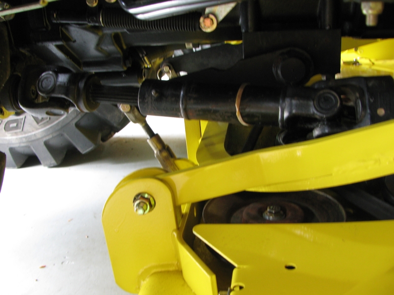

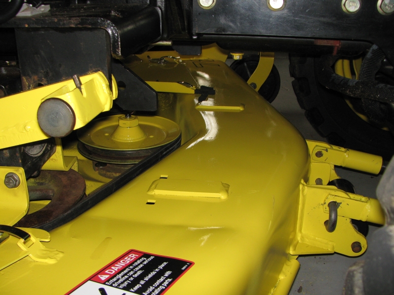

Thanks for the help. The local (60 mile away...) mechanic stopped by on the way home from another call today, and said all looks good. I'm still curious as to when you get yours on it this spring if it looks like this. I'm probably worrying about nothing. You maybe can see in the pics that the deck stops don't line up 100% with the deck reinforcements, but if I put the two swing arms in the rear holes they do. But then the PTO is too tight, and I have to unscrew the threads almost all the way on the front adjusters to make it level.
Here I hope is a pic or two to see it better.
Wayne

Wayne,
I finally got the mower hooked up last night. The angle of the linkage that connects the deck to the rockshaft appears to be pretty much the same as in the picture that you posted.
