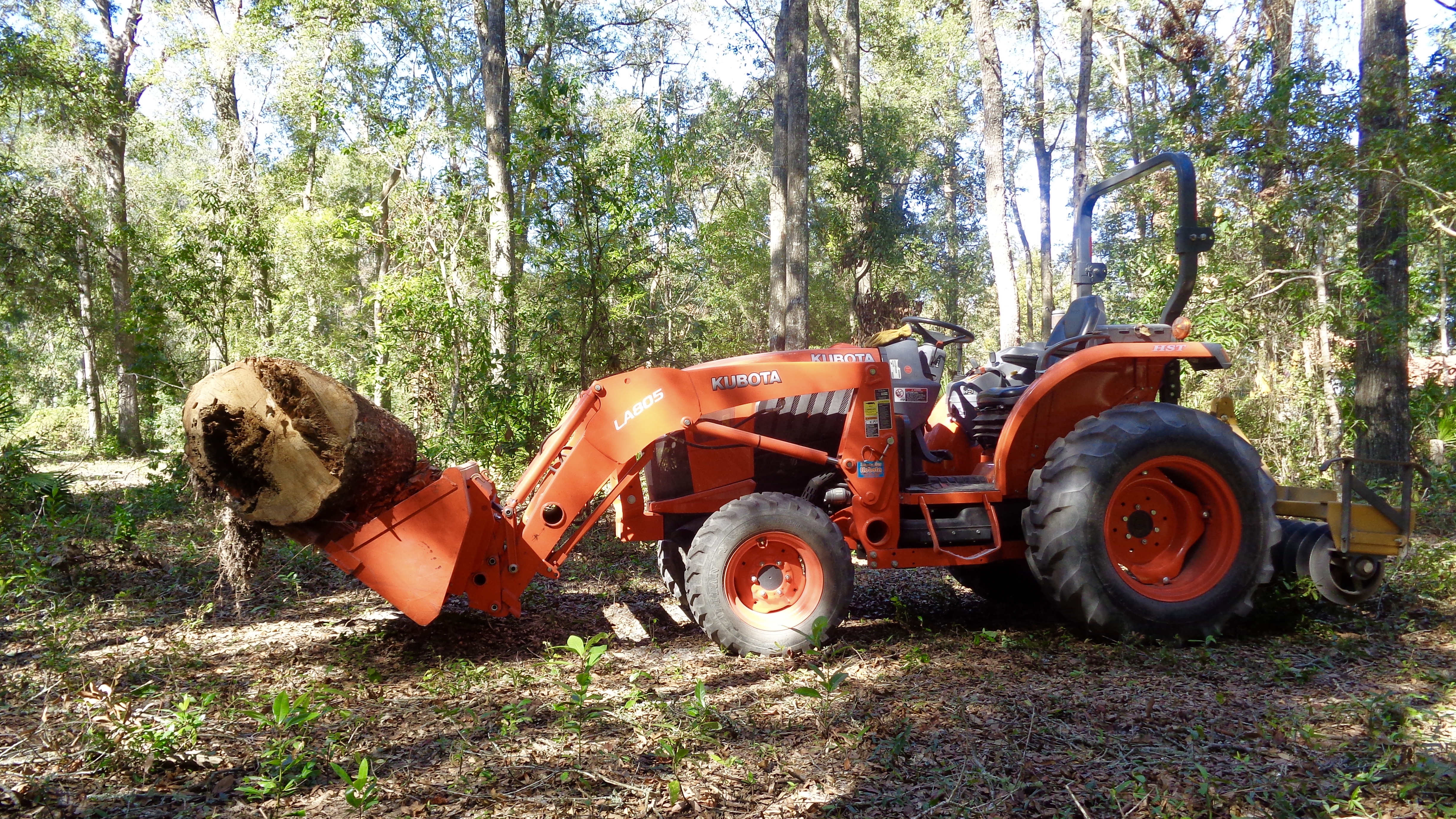

In my opinion neither Kubota
L2501 nor
L3901, both with a bare tractor weight of 2,600 pounds, has enough weight to accomplish your tasks SAFELY. You need a tractor of whatever brand with a bare tractor weight of 3,500 to 4,000 pounds.
In Kubota this would be the utilitarian MX series or the superbly outfitted 'Grand L' series. Same heavy chassis; different kit.
Heavier tractors have greater wheel spread making them more stable. Heavier tractors have larger wheels and tires better able to bridge holes and ruts without the tractor rolling over. Larger wheels and tires provide a much smoother ride over rough ground. Heavier tractors have greater inertia to resist rollovers when moving heavy loads in the FEL, the most hazardous of routine tractor tasks, especially hazardous on sloped land.
For your tasks greater tractor chassis weight is far more important than tractor horsepower. This is difficult for people new to tractors to realize.
Horsepower is more important operating PTO powered implements.
