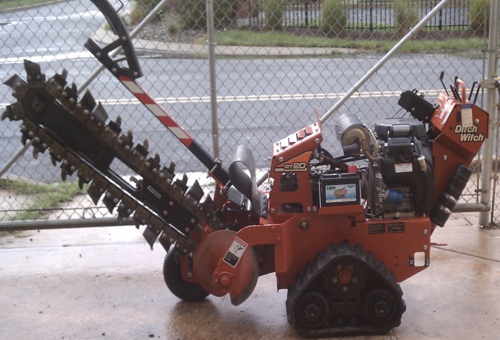

Why tear up 4 times more of the yard than is necessary? Depending on how much drain and wire he has to install, I would sure rather spend a couple hundred to rent a trencher than deal with a 16 inch trench settling for the next 3 or 4 years.
   / Help! I've got a 16-inch backhoe bucket and need to dig a 4-inch wide trench... #12
You will have to wheel roll it to keep this from happening
   / Help! I've got a 16-inch backhoe bucket and need to dig a 4-inch wide trench... #13
You can roll all you want, it's still going to settle. All I am saying is, better to have a 4 - 6 inch wide area to rehab, versus a 16 inch wide area to rehab.
   / Help! I've got a 16-inch backhoe bucket and need to dig a 4-inch wide trench... #14
Make sure to get a bucket full of dirt or gravel then roll it in with your front tire along the trench. Swing your backhoe to help add weight if possible. Go back for a final pass slightly above grade. Maybe 1-2". Good luck!
   / Help! I've got a 16-inch backhoe bucket and need to dig a 4-inch wide trench... #15
I am not certain that is the case. I have a plate compactor which fits inside the trench my 16" bucket makes. Cures the settling problem completely.
Would not work at all with a 4-6" trench.
   / Help! I've got a 16-inch backhoe bucket and need to dig a 4-inch wide trench... #16
Most trenchers I've seen for rent will not dig a wide enough trench for 4" pipe which is actually close to 4 1/2" wide to fit into.
- An earlier poster mentioned a banana bucket. If it is a curved piece of flat metal without sides, but rather has re-enforcing on the back side so it will not clog up, it would be ideal. One made out of a length 6 or 8" wide flat would be fairly simple to make up. It would be narrow enough you wouldn't need teeth so you could get a flat bottom out of the trench & the sides of the trench will keep the dirt on the scoop. Another option would be to take a pair of chisel plow shanks without the shoes & use them on the back of the curved flat. They are tempered, strong & ready. They will made it easy to form the flat with. Tack weld one end of the flat an inch or two past the bottom of the shanks then draw the flat down to the shank with pipe clamps & and a hand sledge hammer, tack welding as you go.
