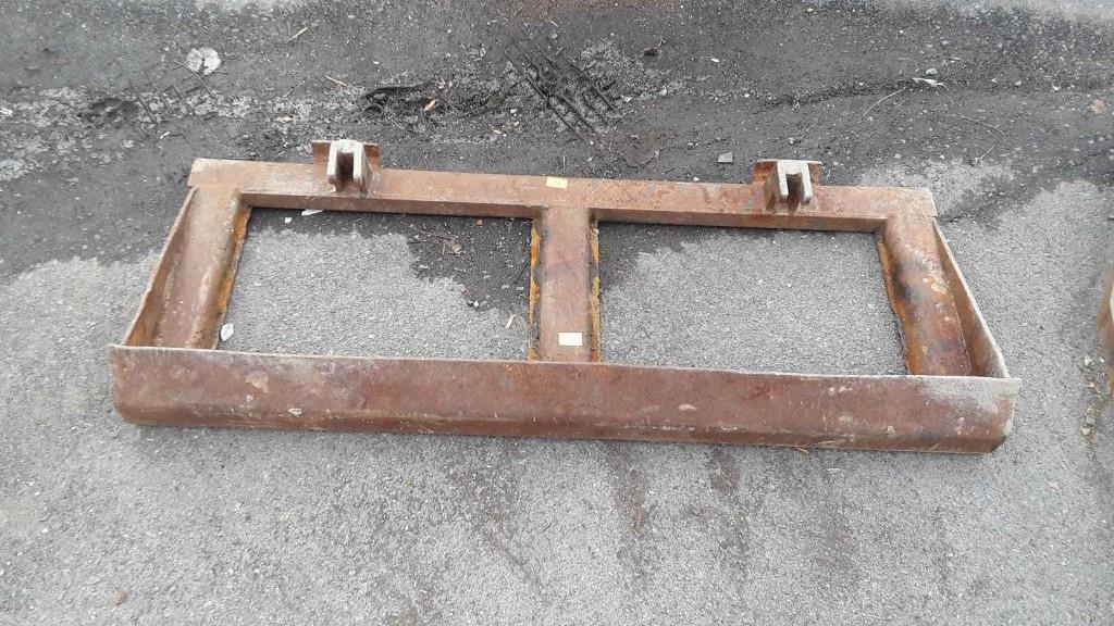

I got this as part of an auction lot. it is 44 by 17 and I think it is some sort of quick hitch. any insight would be appreciated.
https://i.imgur.com/RNnhFpi.jpg

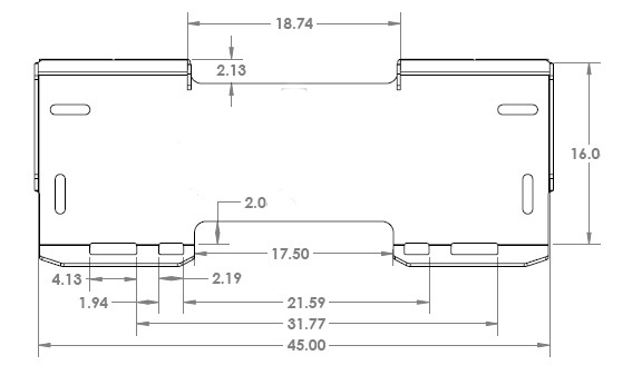

And the SSQA dimensions:
This shows the top angle:

Awesome. Thanks so much for reposting it and for the detail provided. So.......any idea what it is and what type of equipment it should be mounted to?
   / help identifying #4
Looks like an attachment mount for either an older Case skid steer (1835, 1845, early 1840 etc) or same for a New Holland L553, L555, L783 or similar vintage before the universal mount became universal.
