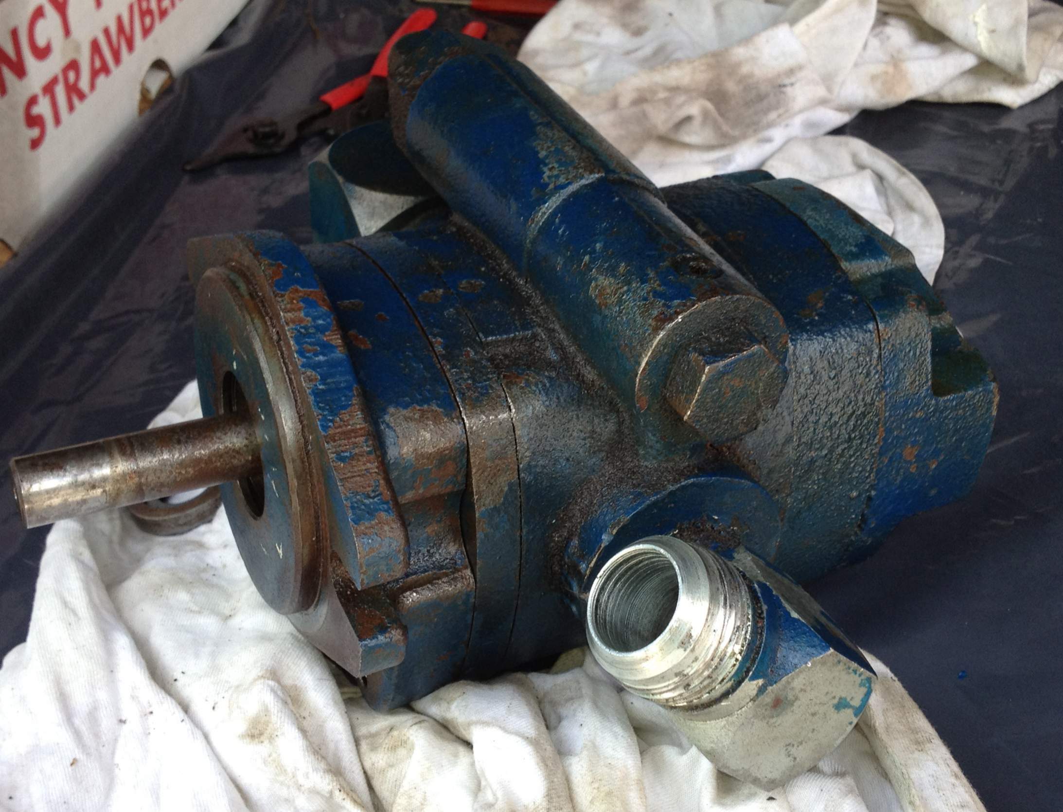

Hi all-
Could anybody identify this hydraulic pump? It is a 2-stage pump that was installed on a log splitter. The only markings I could find are on the back of the unit. I think the marking reads 'CC 251 L'. I am in need of a seal for it.
Thanks,
Joe

Looks like an old MTE (Mechanical Tool & Engineering, Rockford, IL)
Good Luck finding parts on that one.....:confused2:.......Generic shaft seal will be tough enough to find....

Thanks for the info. I've sent an email to the contact they have listed on their support/service section. We'll see how it goes.
