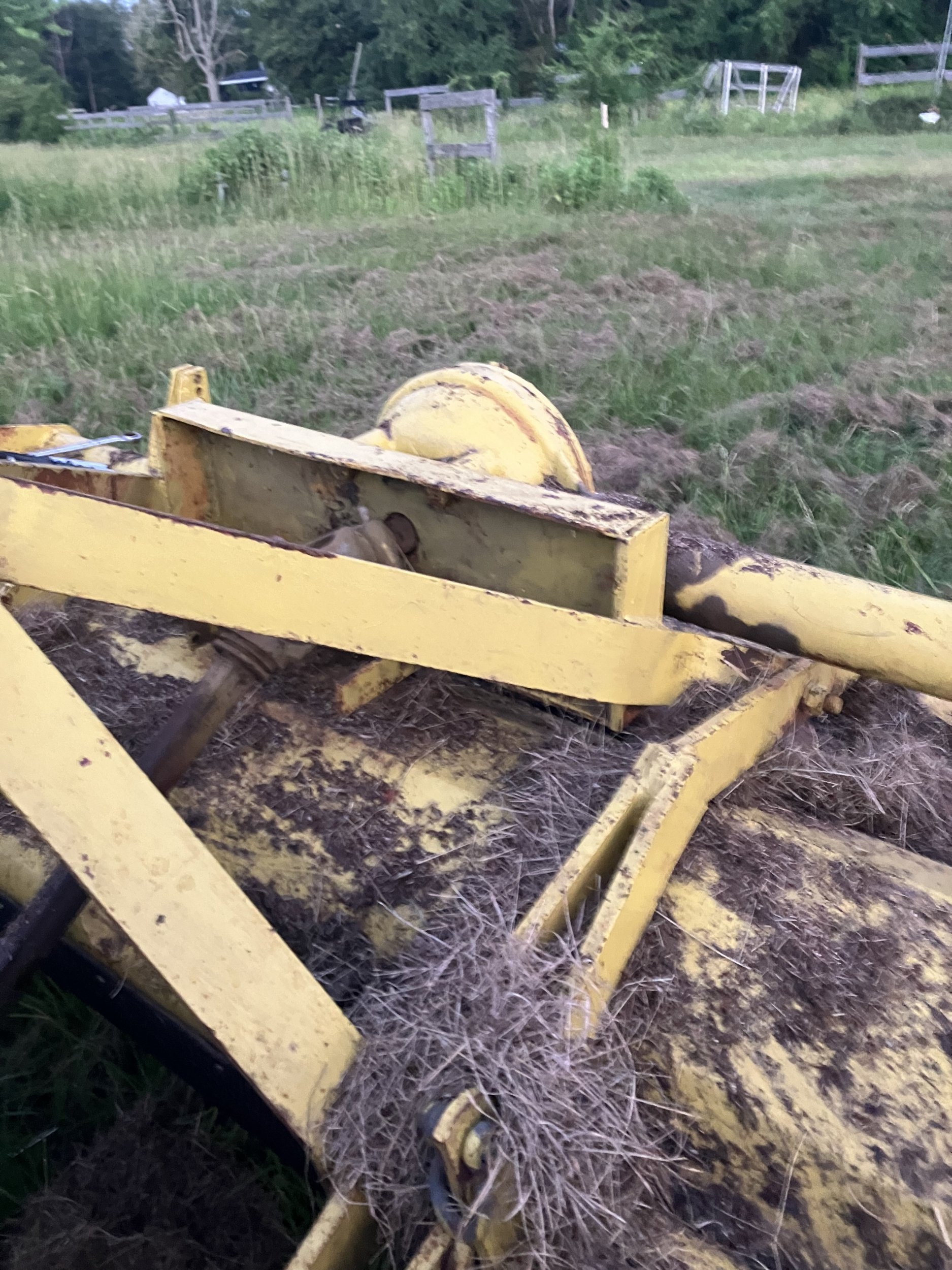

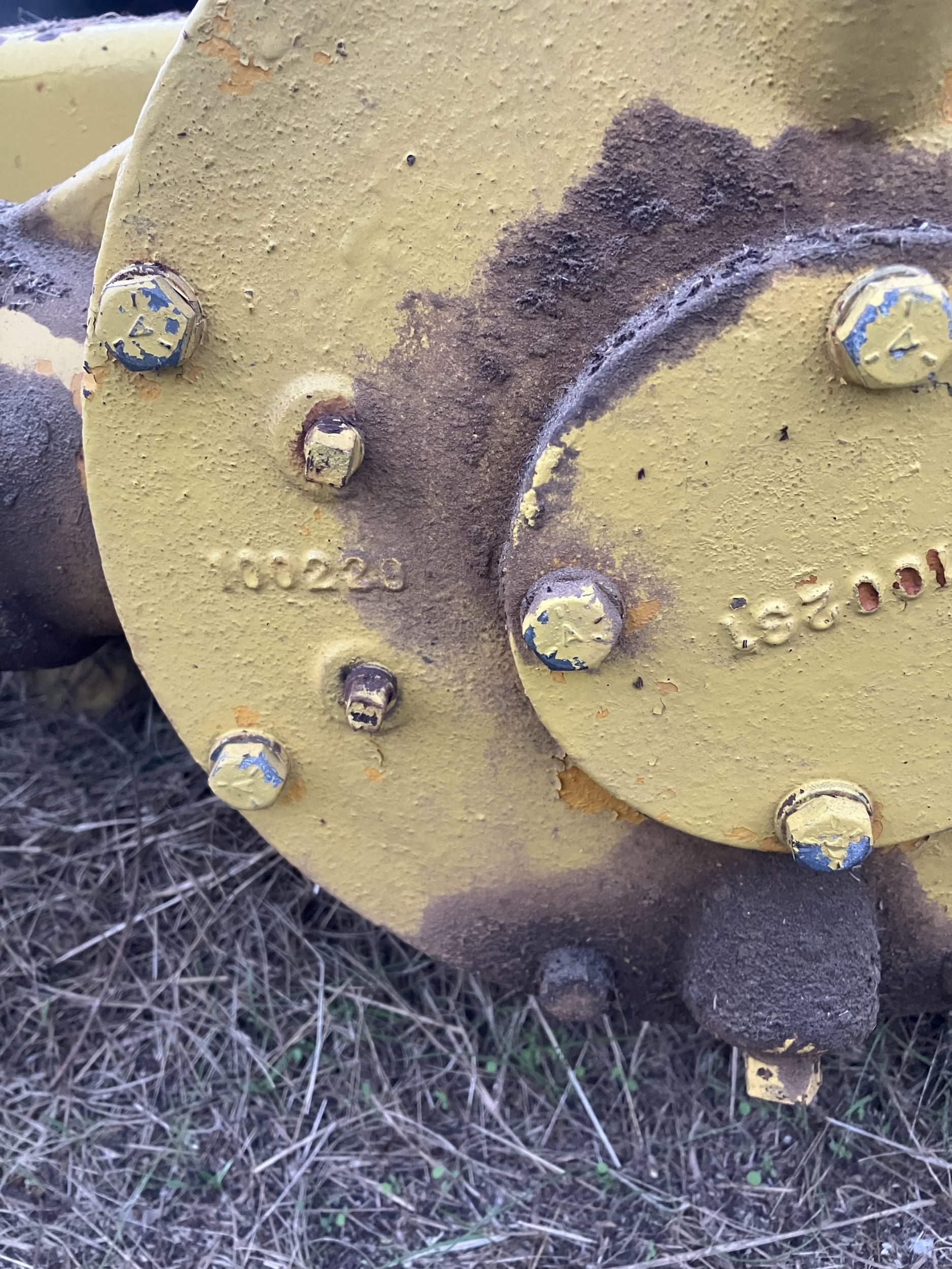

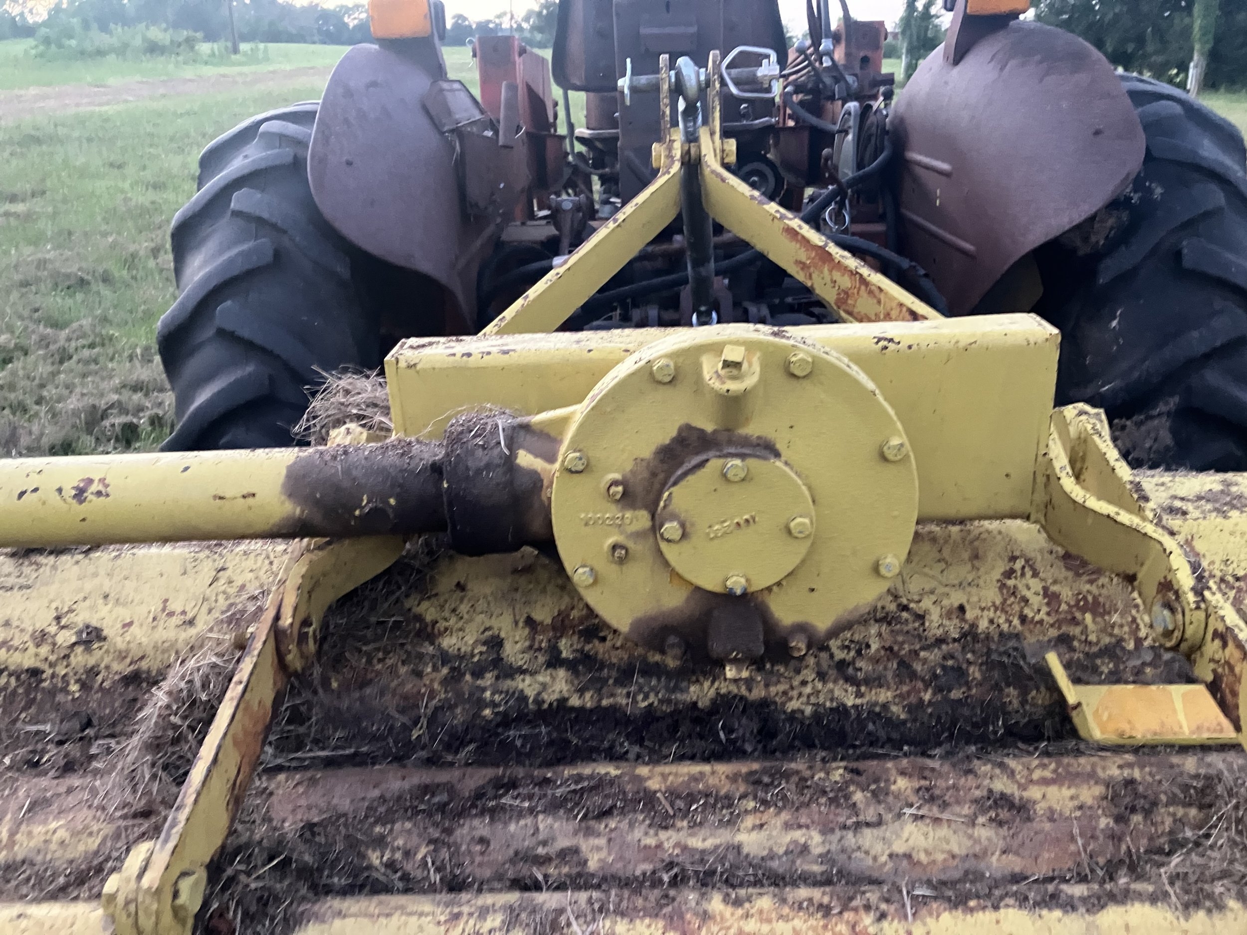

Good evening friends! I recently purchased an older 7ft flail mower from an older lady who cold not remember what brand it was. I can not find any markings. Now the cutter shaft bearings need replaced and I can not find the corrent ones please help if you can

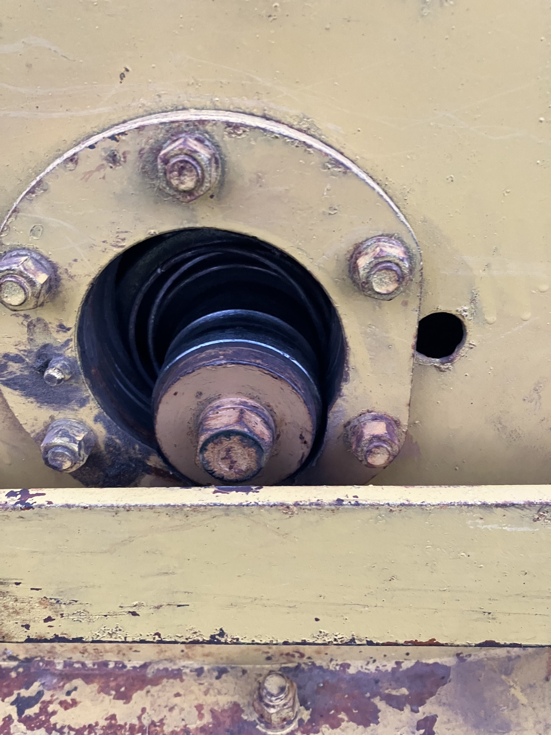

I would think if you pulled off the plate and looked at the outer race of bearing there "may" be some numbers on it that will relate to bearing specification and finding replacement...

Got it off and can not find any numbers?

The mower is an Alamo or Mott. Alamo bought Mott so they are the same. The flail is most likely a model 72 or 74. FlailMaster and Montage most likely have the parts you need.
Flailmaster
Montage
Page 6 of the Flailmaster catalog has some data on how to ID the bearing.
