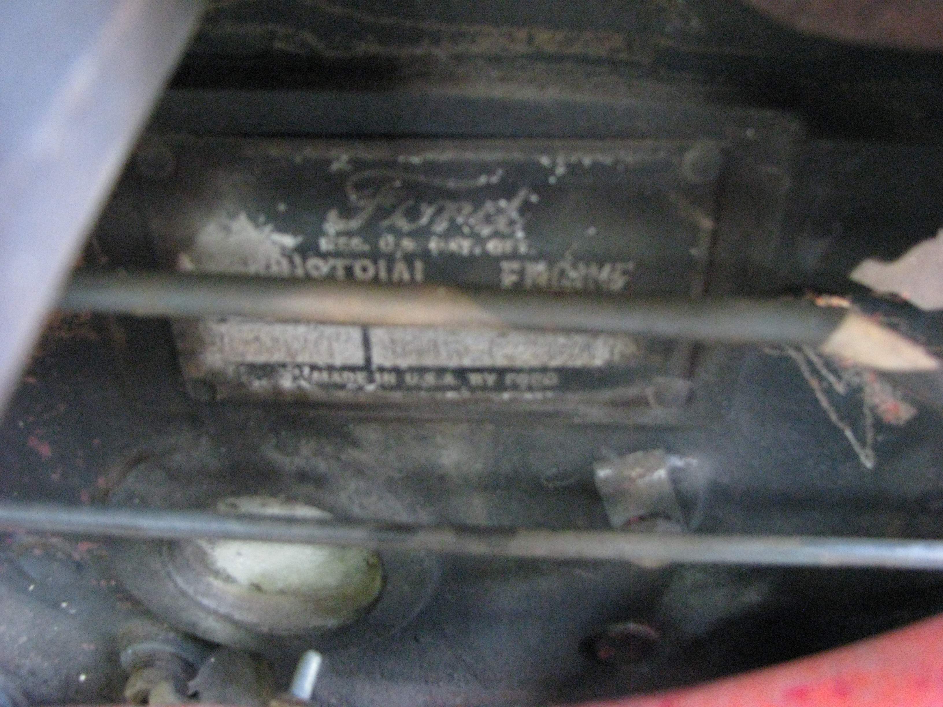

Hi, I am a new owner of a 1957 Ford 860 tractor. I was told by the previous owners that they replaced the 40hp engine that came in the tractor with a 60hp engine. I cannot for the life of me find anything on the numbers I have pulled from the engine. Please help! The metal tag on the block says Ford Industrial Engine, model # JD1020, Serial # 3643-C28CA. Any and all help would be appreciated! THANKS!!

I attached a picture of the tag, sorry it is so blurry! I was hoping maybe the style of the tag might help in identifying how old it is. Thanks again!
   / Help identifying Ford engine #3
that's an industrial engine tag.
why not post us the casting numbers off the engine instead of that hard to read tag :)
ps. i'm not aware of any 40hp engines.
the 172ci made about 48 the 192 more like 55.
you can bolt any of the 134/144/172 and 192 ci engines into all the bellhousings.
