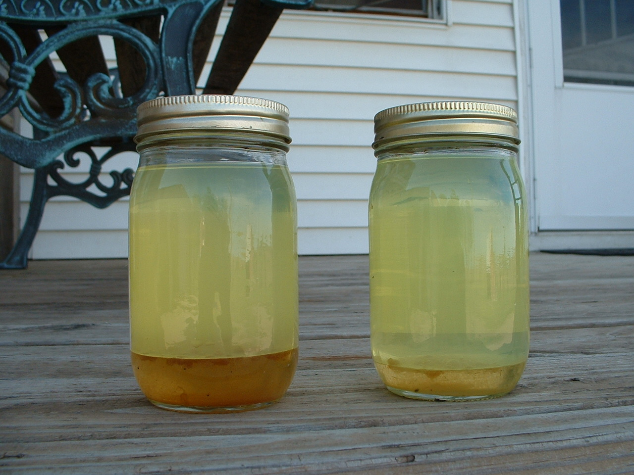

Hi All,
So I have encountered my first real diesel fuel problem. This weekend after I filled up from empty, my tractor began to have some power loss while doing some chores, most notable while tramming down the highway cresting several hills. At one point I thought I was going to stall out. To make a long story short, I was able to get the tractor back to the barn. So today I decided to filter a 5 gallon container of the last batch of off-road diesel that I purchased using a Mr. Funnel filter. The attached pictures are a result of my filtering. Also the fuel appears cloudy; more of a pink color than the normal red that I am used to.
What is your interpretation of the substance at the bottom of the jar? I honestly don't think it is water because it looks creamy. Is that gel, wax separation, or something else? And if you are wondering, I did treat this fuel directly at the fuel station with the white bottle of Power Service.
I suspect this fuel was already degraded from when I purchased and by me adding the Power Service would not have much affect. Our winters in South West Virginia are fairly mild, but we did hit a single digit temp a few times this year.
I plan on taking this fuel sample back to the dealer and ask that they make right by this. It is sad because I have dealt with the fuel station for quite sometime and for our area has a decent turnover of diesel fuel.

I would say that you got about half water in your load. I assume you have some sort of home storage tank from your post. You may have gotten a contaminated load and then again your tank may be contaminated with water and needs to be drained off. It may not be possible now, but a bottom drain in your storage tank with a valve so you can take a bottom sample now and then would be my suggestion. Tip your tank so the pump side is an inch or so higher than the drain side so any water will flow to the low point drain and keep your pump suction a couple inches off the bottom of the tank so it doesn't suck up any water or rust.
   / Help identifying diesel fuel contamination #5
That is water at the bottom.
   / Help identifying diesel fuel contamination #6
Could be flakes suspended in water. Hard to say. Wax if it was colder could be an option.
Get yourself some water finding paste like Kolor Kut and dip it. The stuff is cheap and will change colour if water is there.
Side note... Glad to see the Mr Funnel is working for you. I swear by mine now. Those pics and your story should be posted whenever somebody asks if "they're worth it" or if they work:thumbsup:
   / Help identifying diesel fuel contamination #7
If I may add one thing to the pot about buying fuel is to never buy fuel when you see a fuel truck dumping fuel at the station. It mixes up the trash and such in the bottom of the storage tank and then pumped out to your vehicle or container if your pumping at the time.
   / Help identifying diesel fuel contamination #8
Water and diesel oil DO mix, and they make a bad-looking muddy mess like you have.I wouldn't use that fuel at all......except to put on a controlled brush fire. Sometimes when the water has emulsed into the fuel or vice-versa, the water detecting paste will not give you a definite red indication,but a speckly red indication.Still, the fuel is bad. don-ohio :)^)

Thanks for all your responses. Lucky for me I only purchased 10 gallons worth of this fuel. I wanted just a enough to get me through until my area switches over to summer blend. I am pretty happy with the Mr. Funnel filter. I didn't know until yesterday that they recommend adding a fuel supplement after you have filtered the fuel. I guess I didn't take into account that some of the water could potentially pass through by the aid of the supplement. The ironic thing is the fuel was filtered three times before it got to the engine. I use the Mr Funnel filter on top of the drop in filter at the mouth of the fuel tank, and then it gets filtered by the tractors paper filter. I honestly think this fuel has more problems than just water.
That being said...I decided that I am going to drain the fuel tank completely on my tractor and replace the filter. I can use the waste diesel for brush as you say and I hear it might take out some poison ivy.
Now back to the drawing board to find my next fuel supplier.

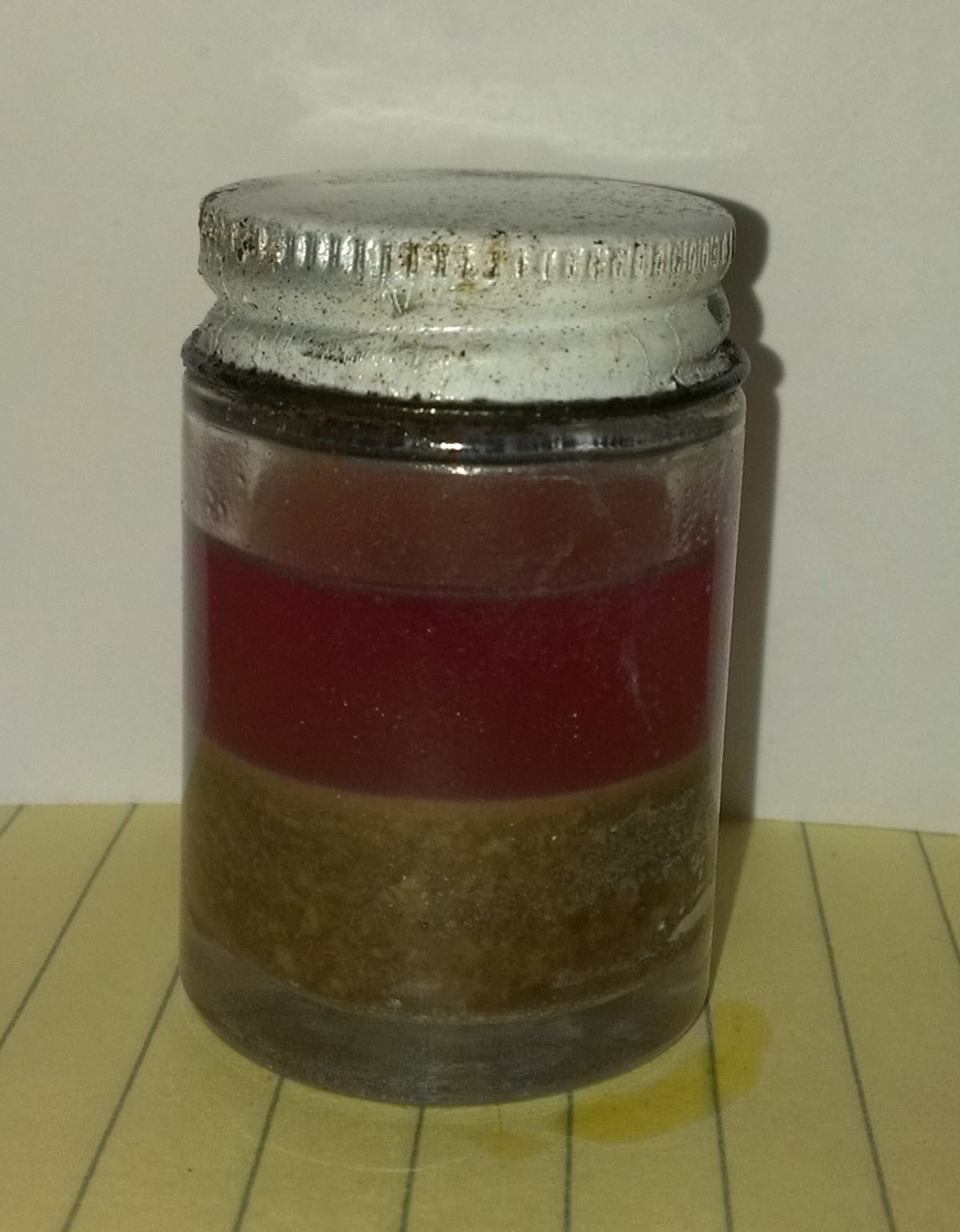

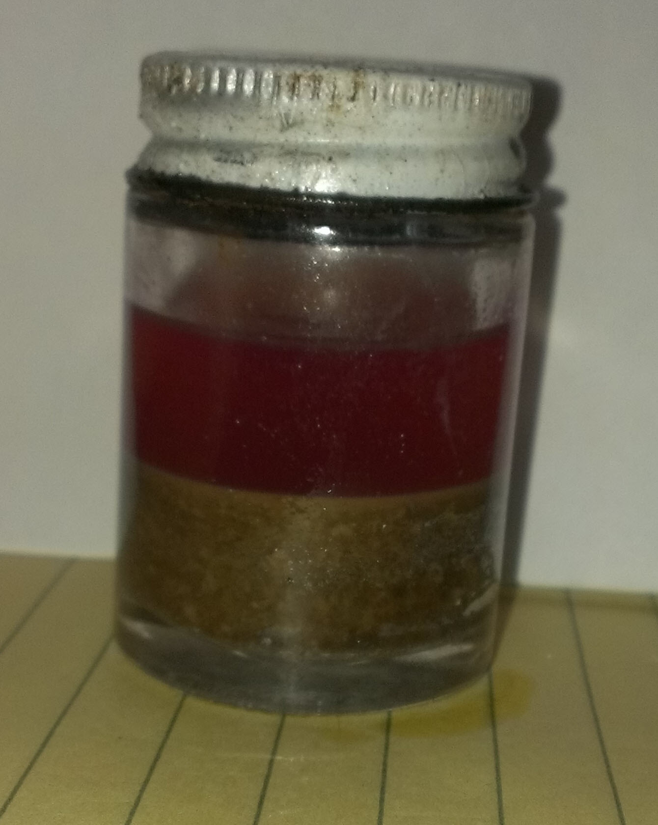

It looks an awful lot like this:
Get it out of there ASAP as it will immediately start to corrode fuel system. This cost a local gas station around $10,000 to replace the fuel system in my last diesel pickup. I normally ddn't buy fuel from there, but was on empty on the way home. I didn't drive the truck for 2 weeks before I found out I had purchased bad fuel. It was too late and too much damage was done from sitting with water in fuel.This was the 4th and 5th draining of the water separator.
