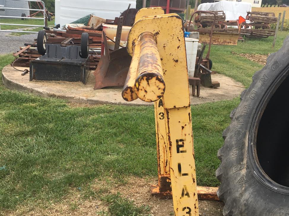

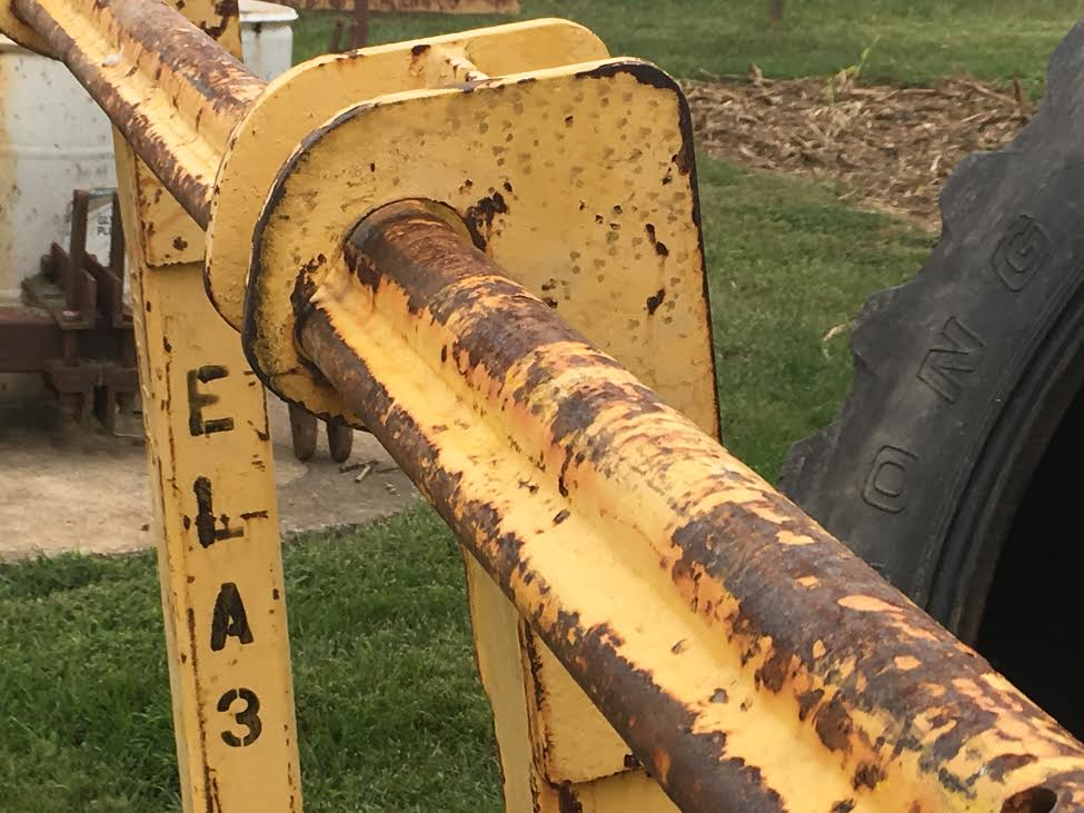

I've recently acquired a second hand set of pin type over the bucket forks of which did not include the mounting brackets. The machine in which the forks were used was previously sold and I have no way to identify the style of brackets that were mounted to the top of the loader bucket.
Unlike many sets that I've seen, this particular set has the standard 2" solid pin with a 1" solid pin welded along the entire 2" pin. The top bracket on the forks is cut out to except this oblong type shape.
Can anyone help determine the bracket style necessary to mount these forks? I'm afraid that with the standard 2" style bracket I won't be able to latch in and rotate on the pin when hooking up the forks. I'd rather purchase a set of the pre fab brackets for ~$100 if possible since I don't have an easy means of cutting heaving material.
Any suggestions are greatly appreciated!

I did an image search and didn't see any made like that.
If the bracket angle is right, the double pins should still work, since the 1" pin will be at the back and the 2" pin will be in the bracket.

Thanks guys; appreciate the responses. I see what you're saying and I'm probably just overthinking it. I might as well order up a set of the brackets and figure it out along the way. Worst case scenario I cut out sections of the 1" pin where I want the brackets to be placed. Thanks again.
