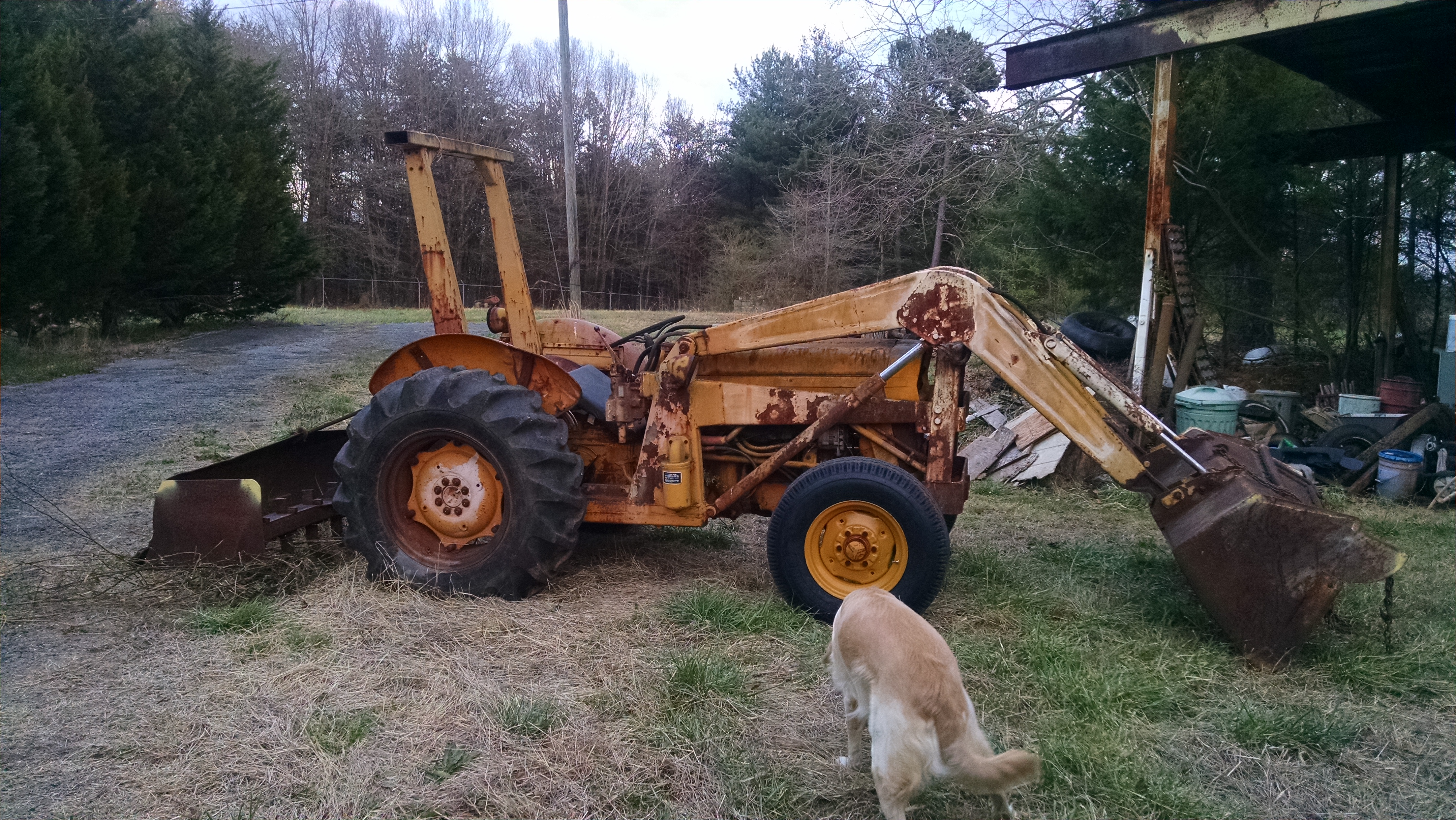

New to the forum, I need help identifying this tractor I inherited. It does not have a model painted on the side (Not visible) and the tag is missing from the dash. I think it is a Industrial series. Perkins 3 cylinder gas, 3 shifters (F/R, H/L, 1-3 or 4). It also has a loader. I did find a tag but, I dont know if it goes with this tractor 9A 87590. On the back side of the oil pan it has the following; 11 6 69, 24866 N, 37172320, D.A.21900 3. Thanks for any help you can provide.

I would say a 2135.
Look for a steel plate attached on the steering column brace below the wheel.
The 20C had a steel grill loop. It was about 3/4" x 4".

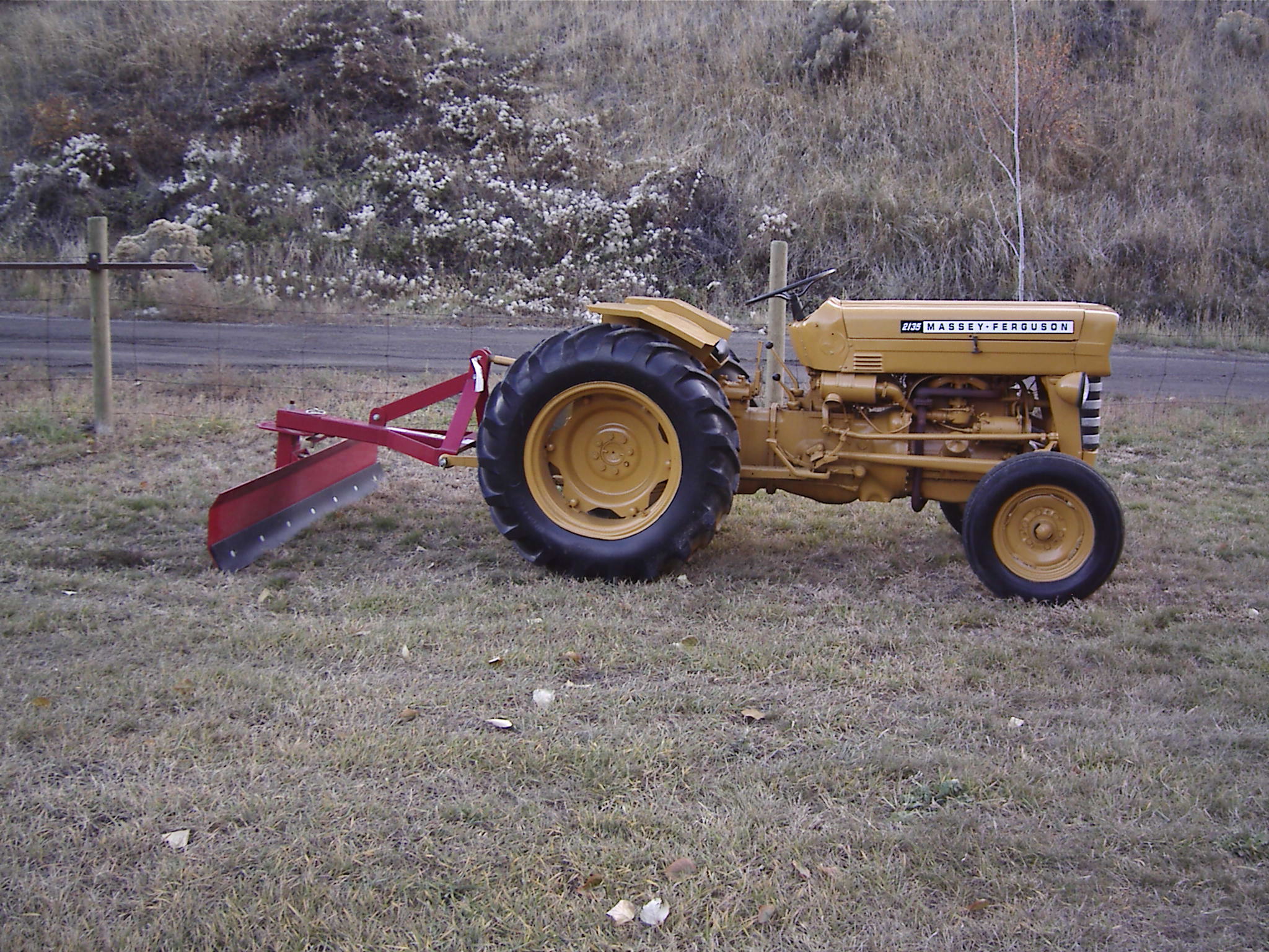

I owned a tractor similar to that once, MF2135. it was an industrial version of a MF135. iirc it had a 3 speed trans w high and low range, an additional foot throttle, and the exhaust routed out below and the the rear of the tractor. and had power steering. I think pretty well everything else was same as a 135. mine was +/- 1967 model. fenders were not original.
