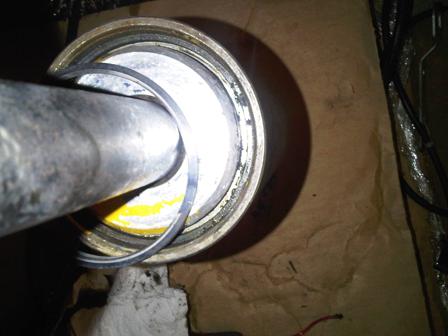

So removing the fitting on the side and driving the gland down did reveal another heavy duty spring/ring. After removal pulling the cylinder apart seems to be a bit difficult. At first I was hooking to to a chain and dropping it (see pic) after a hundred or so drops with slow progress I decided to get more aggressive (see pic 2). So this is where I'm at.
There does not appear to be any more clips / parts to remove ... Should I apply a little more force? :confused: Right now I have it suspended between the truck and tractor and standing on the chain to apply more force does not seem to pull it out any more... I have been trying to apply slow pressure. Should I get more physical with it?

It will come...But because you are not pulling in a straight line with that setup it's probably getting cocked slightly in the bore causing binding. Another way to do it is to apply air pressure to the bottom port and "shoot" the piston out. That method is not for the faint of heart though...it can be dangerous.

I'm on that. I have on-board air in the truck. I will rig it up right where she stands.

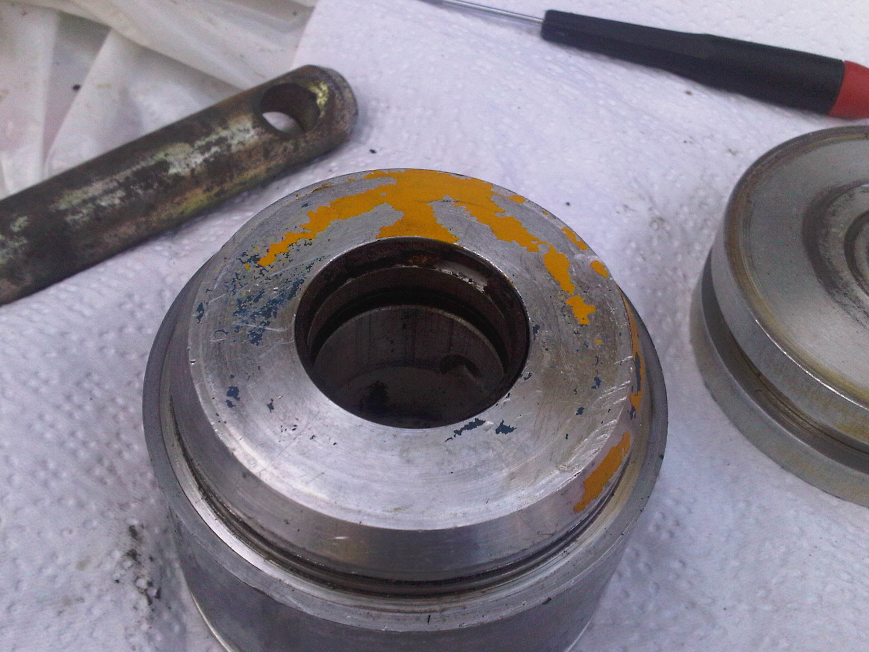

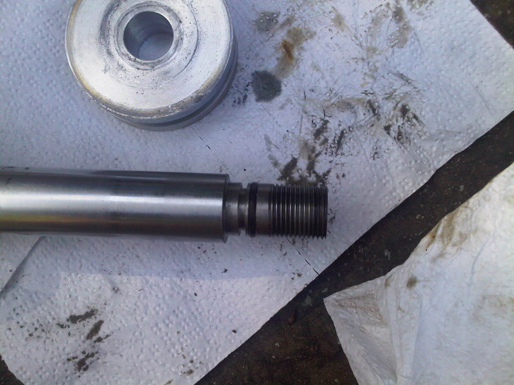

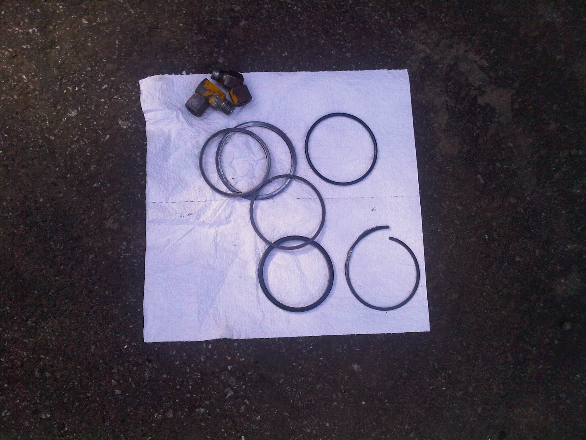

OK.... So I rigged up the air.... and it came most of the way... until the inside section made it to the end port. So another re-rig using the chain and some quicklinks to keep from torquing it sideways worked. Getting the nut of the ram took some doing. The impact wrench came in handy for that one.
On to the next... ID 'ing the parts and procuring them.
How does one measure the o-rings / seals to spec them? Measure the metal parts that they mate to and figure the difference?
Laying on the towel are:
Two metal springs, an o-ring from the outside of the gland, two plastic spacers and a flat bottom o-ring that goes between the spacers on the seal inside the piston.
The shaft appears to have one o-ring around it to seal the inside of the piston. There is another groove here ... with nothing in it?
The gland appears to have one o-ring inside with two very small plastic spacers and possibly a decomposed fiber wiper? on the outer edge.
Any comments on how to spec theses?
