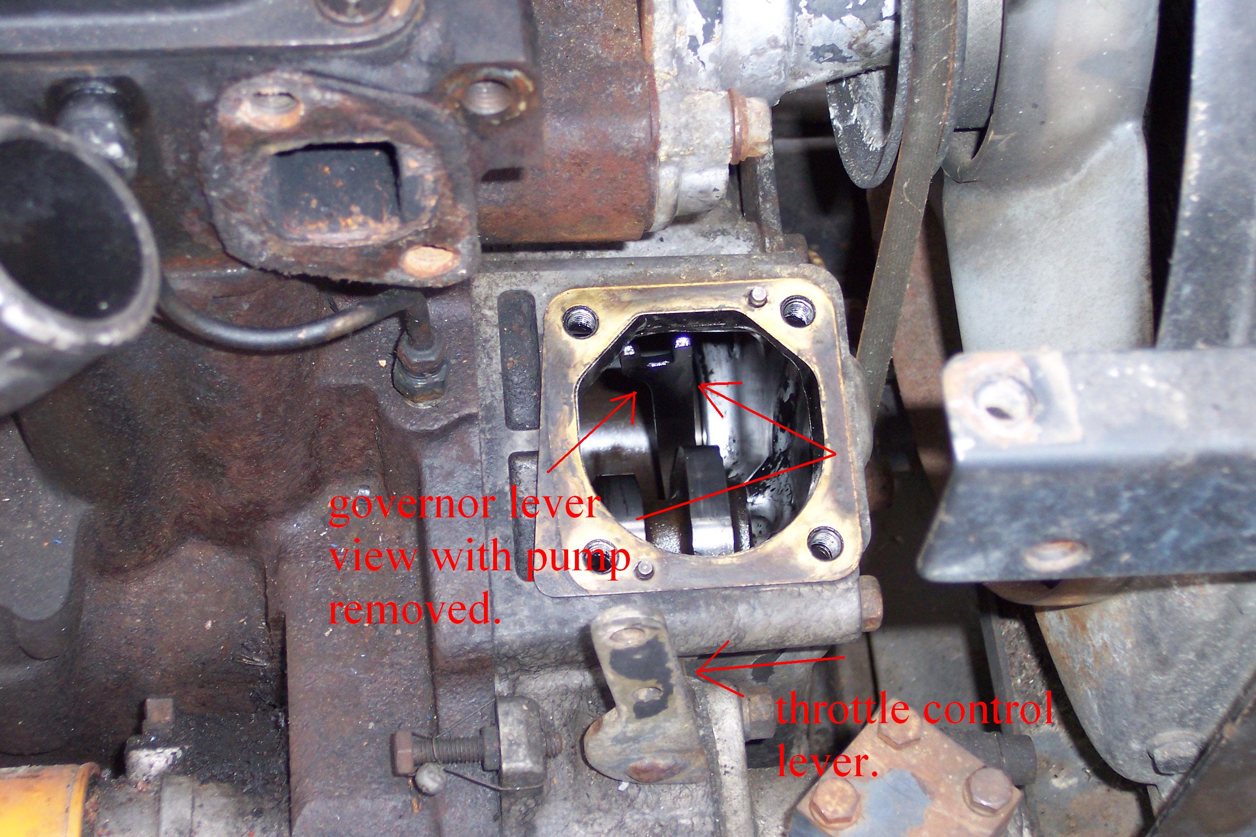

   / HELP!!!!!!! how to remove an injector pump on a KE75 engine #5
Ah , A little bit of info that would have helped earlier.
If the control rack is frozen in the off position then
it will not clear the timing cover were pump bolts on.
Check this picture. the governor lever is just to
the left in the opening. It would be under the top
left bolt hole around the opening if left in the off or closed
position and would not clear the case.

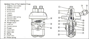

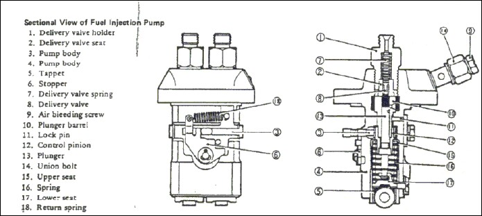

   / HELP!!!!!!! how to remove an injector pump on a KE75 engine #6
If it is rusted and stuck then maybe you could pull pump
up as far as you can and spray penetrating oil on the
control rack area of pump body. Check picture below
if you were careful you could loosen the delivery valve
holder and spray penetrating oil in that area which
looks like it could work its way down to the control
pinion or anything in there that might be frozen.
Don't worry about any penetrating oil getting
into the crankcase, you are going to change the engine
oil anyway if you get it running.
Thanks for you help.
Looking at the photo you sent the governor arm is the only thing that has contact with the injector pump fiscally to control injector pump!!!!
The throttle control arm on the outside of engine is not connected in any way to the injector pump directly it only is it connected via the governor below the injector cam lobs . Hence if my thinking is correct after the 4 bolt holding down the injector pump to the engine are removed one just needs to align injector control rack at the back of injector pump with the checked out piece I can see there and lift injector pump out. nothing else needs disconnecting.
can you confirm are you able to move the control rack freely should i be able to move it with a screw driver pushing it backwards and forwards manually
