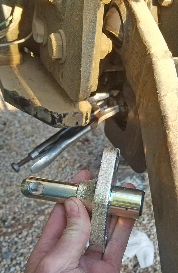

One of my attaching pins for my 3 point lower draft link arm snapped. I've had this happen before and it was an easy replacement. This time however, I took out the two bolts and the pin won't slide out. It feels really loose and rotates easily but it will not slide outwards at all. Ive tried prying it with a screw driver and pulling with vice grips... no luck.
Any suggestions?

There is no easy way of getting behind the pin to force it out. The round shaft opposite end of the pin side slides into a round receiving socket in the trans axle housing, and there are simply 2 bolts that fasten it.
It snapped because I was grading in reverse with my box scraper and hit a stump. That part of the attaching pin which broke is the weakest link. It happened another time in the past and took me 2 minutes to fix it.Deere Pin.jpgDeere Pin.jpg

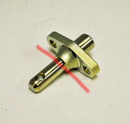

Here is a photo of a new pin. The red line shows where the pin side (on the left) broke off. The base (right side) remains stuck in the tractor.Deer Pin break.jpg
Once I removed the two bolts it should just easily slide out. If feels very loose and rotates each direction. It just won''t slide out. If that (right-side )shaft got bent, I can see why that might stop it from sliding out but I can't imagine that could bend being so thick and bolted flat to the housing/

I figured it out. I just took a better look with my flash light. I have a large mounting bracket fastened to my frame and casing for my backhoe attachment. Apparently I hit the stump hard enough that it shifted the mounting bracket just a bit to now block one edge of the mounting pin to slide out. I just need to loosen the backhoe mounting bracket and the pin should slide out.
