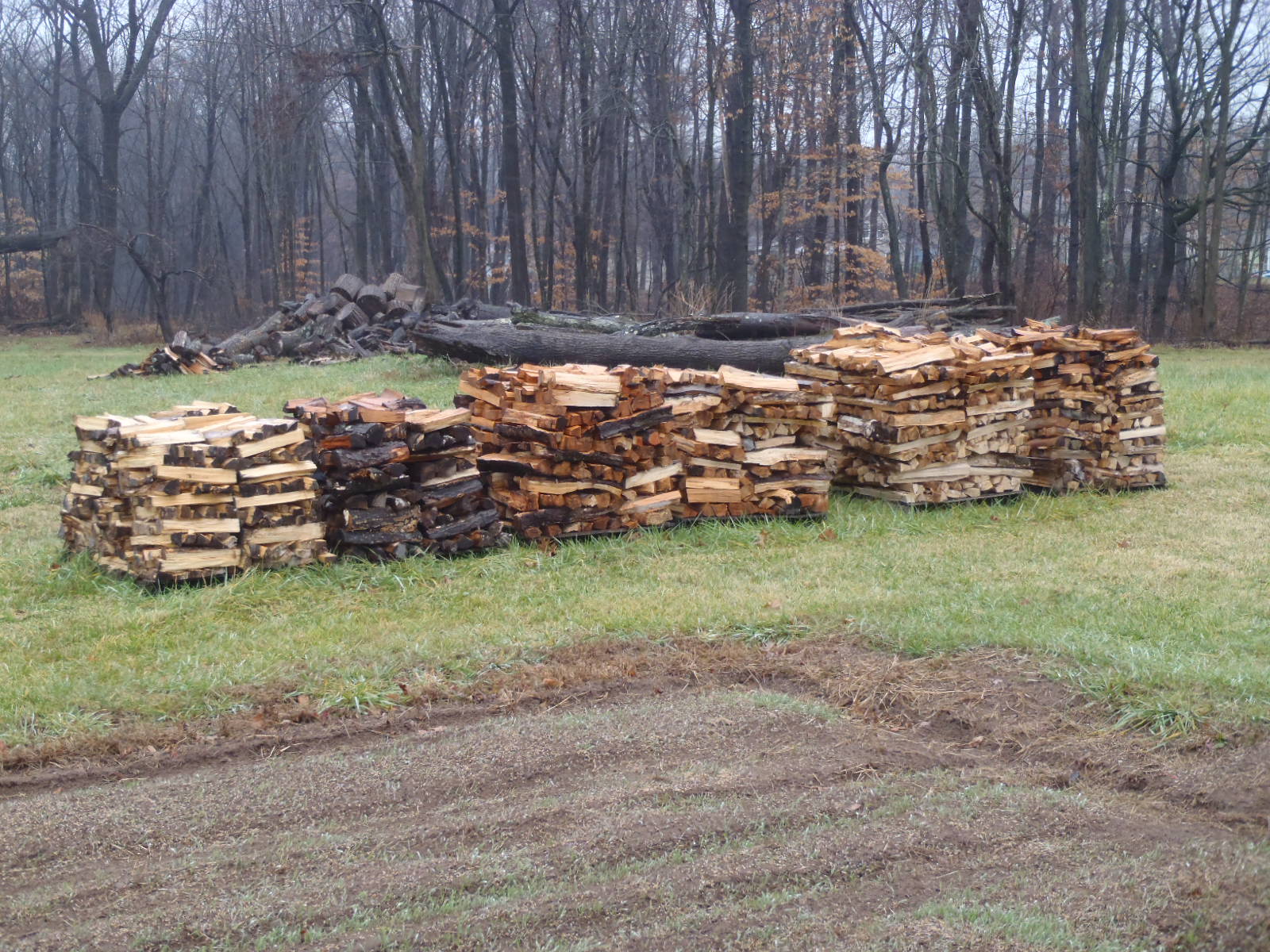

I just bought my first set of pallet forks for my L3540 Kubota tractor. They were used and thrown in with another purchase. I thought they might come in handy for moving fire wood from the splitter to the house. I am looking for proven methods that others have used and hope to find an idea that will work for me. I am thnking I could keep my wood in the back yard away from the house, and bring down a pallet load as I need it. Has anyone designed a box or rack that green wood could be piled on and moved later when dried?

Plenty of solutions in this one thread:
http://www.tractorbynet.com/forums/projects/157504-cheap-quick-firewood-storage-transport.html
Lots more ideas:
Do a Google image search:
site:tractorbynet.com firewood
Thanks of the link,that is what I need to do with our wood. I stack in the garage basement,our furnace is in the basement. My wife asked what are your gonna do with that extra wood that is left in the garage,I dont want it in here after wood burning season is over,afraid snakes will get in it. So that threw a red flag up.So these ideas will help next year. Bring it in on pallets. Whatevere is left,take it out on pallets. LUTT

   / Help for moving fire wood wth Pallet Forks #5
Just single pallets works for me.
You get the hang of stacking after one or two pallets and it's really not much added effort.
Only trick is don't drive too fast over uneven ground.
I do this is using 3pt mounted forks.

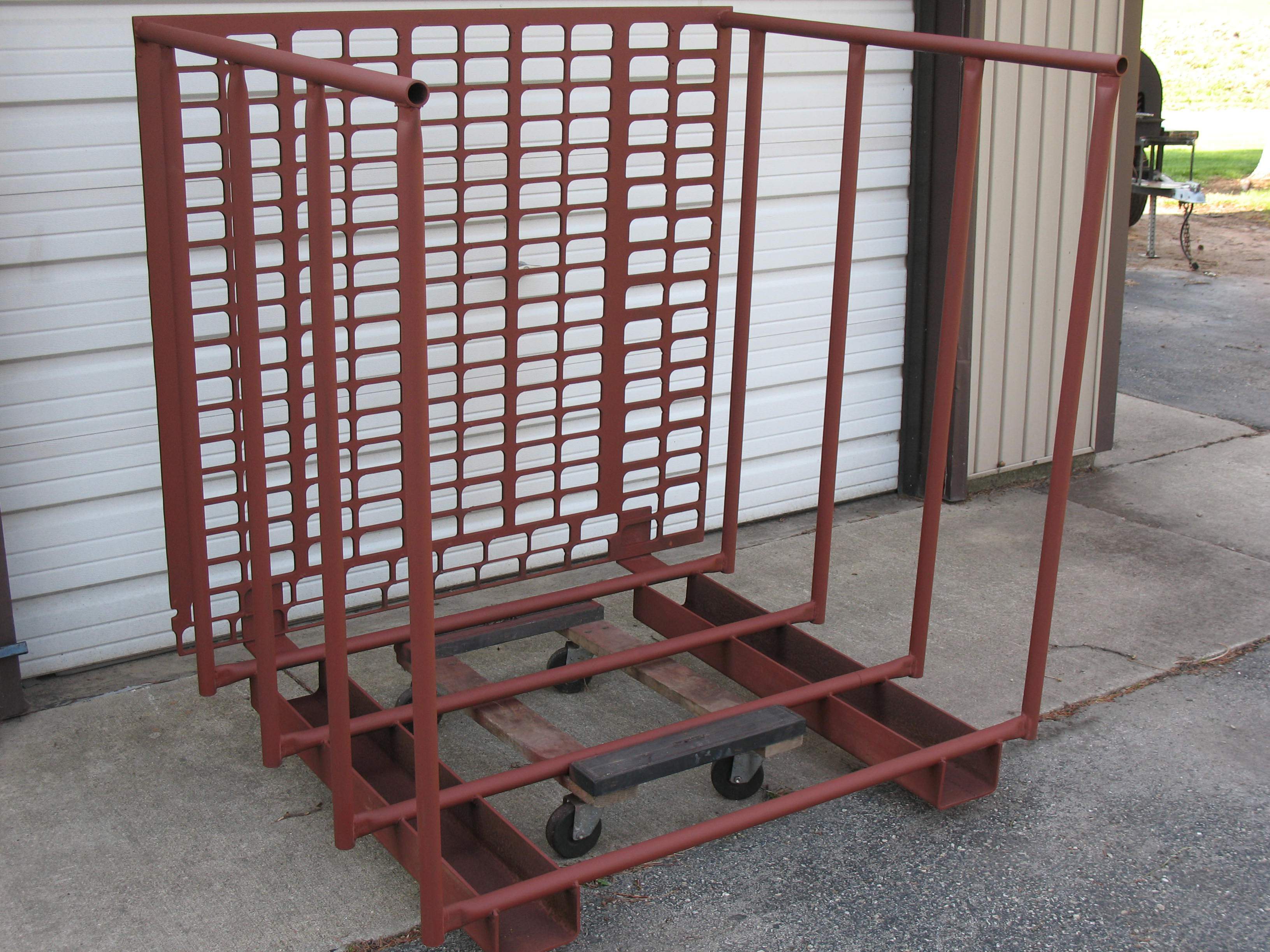

   / Help for moving fire wood wth Pallet Forks #6
Here is one made out of scrap metal 4'x4'x4'.
In the second pic I added some rebar between the pipe to make it eazier to walk into.
