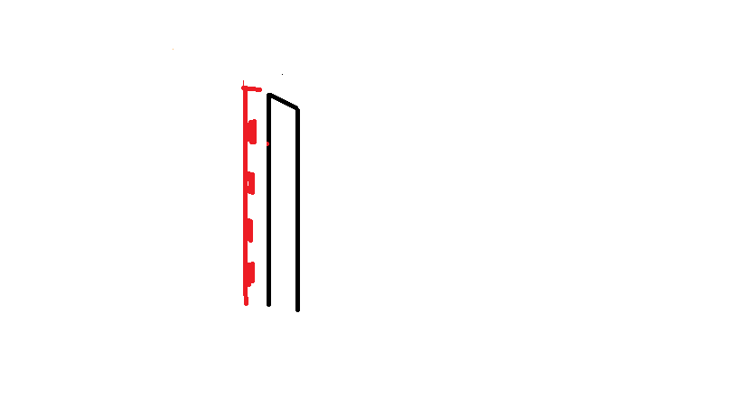

I agree cutting with chain saw on the angle. Another tip since you have your posts in is to run a line say 2" below the top for about 80-100 feet then cut above the line before you put on the rails.
This allows you to follow the grade changes and use a jig that hangs from the top of the post with spacer boards for equal rail spacing. I would make 2 jigs - one on the previous and one on the next post
Also you will probably find that not all posts are exactly 8-10' apart and your rails will need to be cut so attach the rails then cut with a skil saw in the center and use the jig as a side rail (for a straight cut) by screwing it to rails top/bottom.
