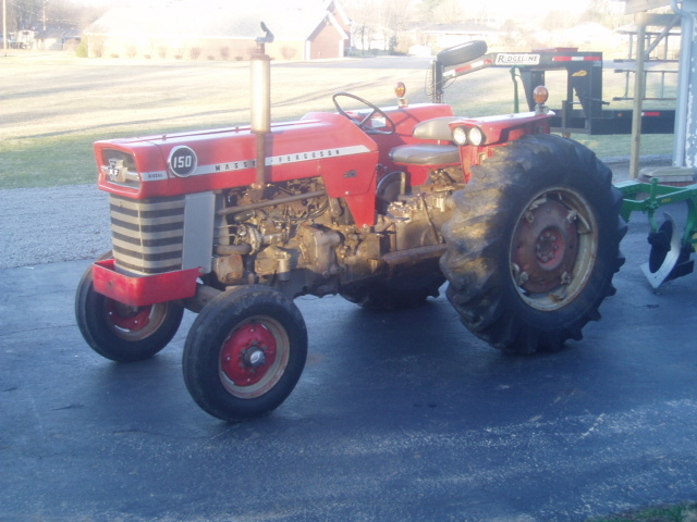

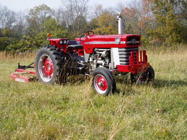

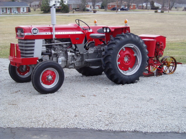

Keep your eyes, ears, and options open. There are several Masseys that would fill your needs and they all show up from time to time in the price range you're looking at.
I farmed for 35 years and now maintain 45 acres with a 1971 Massey Ferguson 150 diesel/8-speed. They can be found in the $3000 to as much as $6500 range.
Other options are, TO35, MF35, F40, MH50, MF50, MF65, MF135, MF150, MF165, MF230/235/240/245/250/255. They are all very good tractors, (individual used condition not withstanding)
Excellent fuel economy, long life, ease of maintenance, simple opeation, and availability of (relatively) low priced parts are the reasons why these tractors are the most copied tractors in existance.
