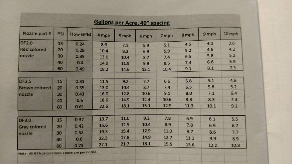

Interestingly, they provide you a pair of unmarked grey nozzles and a pair of unmarked blue nozzles but in the instructions they mention grey, red and white nozzles and provide a chart to refer to that also is based on nozzles that see not supplied in the box.
So I filled it up and tested it for function and verify that we are leak tight. All is well. I then filled to 25 gallons and added 100 oz of Gordon's Trimec Lawn Weed Killer.
So I ran my Rhino at 5 to 7 mph, sprayer pressure at 20psi, used the blue nozzles that appear to be smaller than the included grey, and covered around 200'x120' and the tank was fully depleted.

I did not do a science experiment to determine time to cover distance/area and then use buckets to measure volume sprayed over that time. I instead went with the manufacturers instruction od the 4oz per gallon. I know, there are more precise ways of establishing a flow compared to travel speed than mix, spray and hope.

calibrating a sprayer is not rocket science I've seen old men with a 3rd grade education figure it down to the row. You will never know what you are applying without calibration .
   / Help: Country Way 25 gallon / 7 foot sprayer #4
First, you MUST accurately calibrate your sprayer. There is no option other than to 'give it a shot' and repeat as necessary. However, you WILL end up both wasting money AND inappropriately treating whatever you are working on. Especially a NEW sprayer. You obviously were applying more than you intended and with the 'wrong chemical' you could be killing your lawn to the point that it could take several years for the herbicide to dissipate. Its unlikely given a RK purchased product because they dilute them down from the beginning, but it is not a given.
