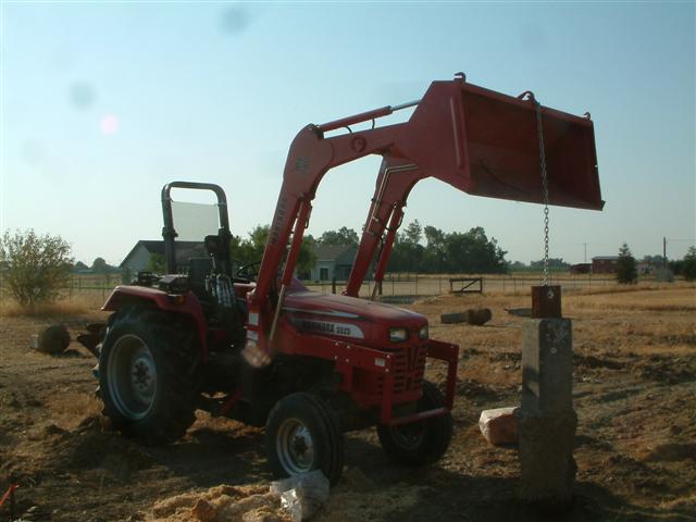

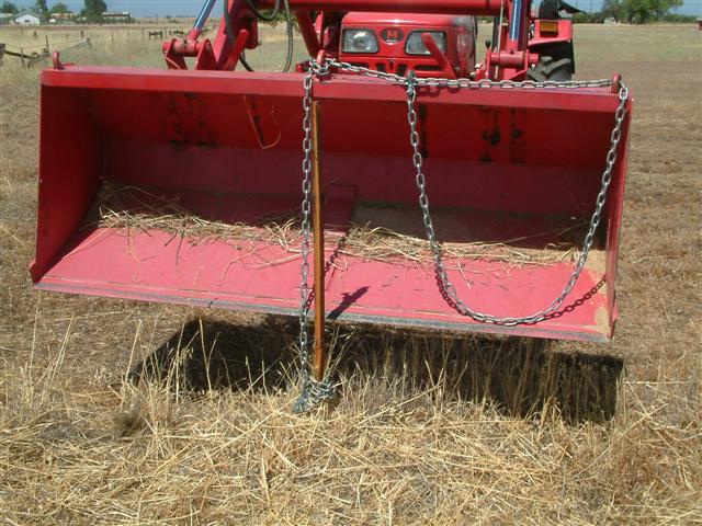

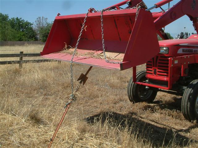

Chain hooks come in handy. Here's what I have on the Mahindra 5525--two grab hooks on the outside and a D-ring slide hook at the middle with 1/4" reforcement welded to the bucket to attach the hooks.
They come in handy for lifting things
and pulling things from the ground
You get the idea. The hooks extend the usefulness of your FEL a lot.
