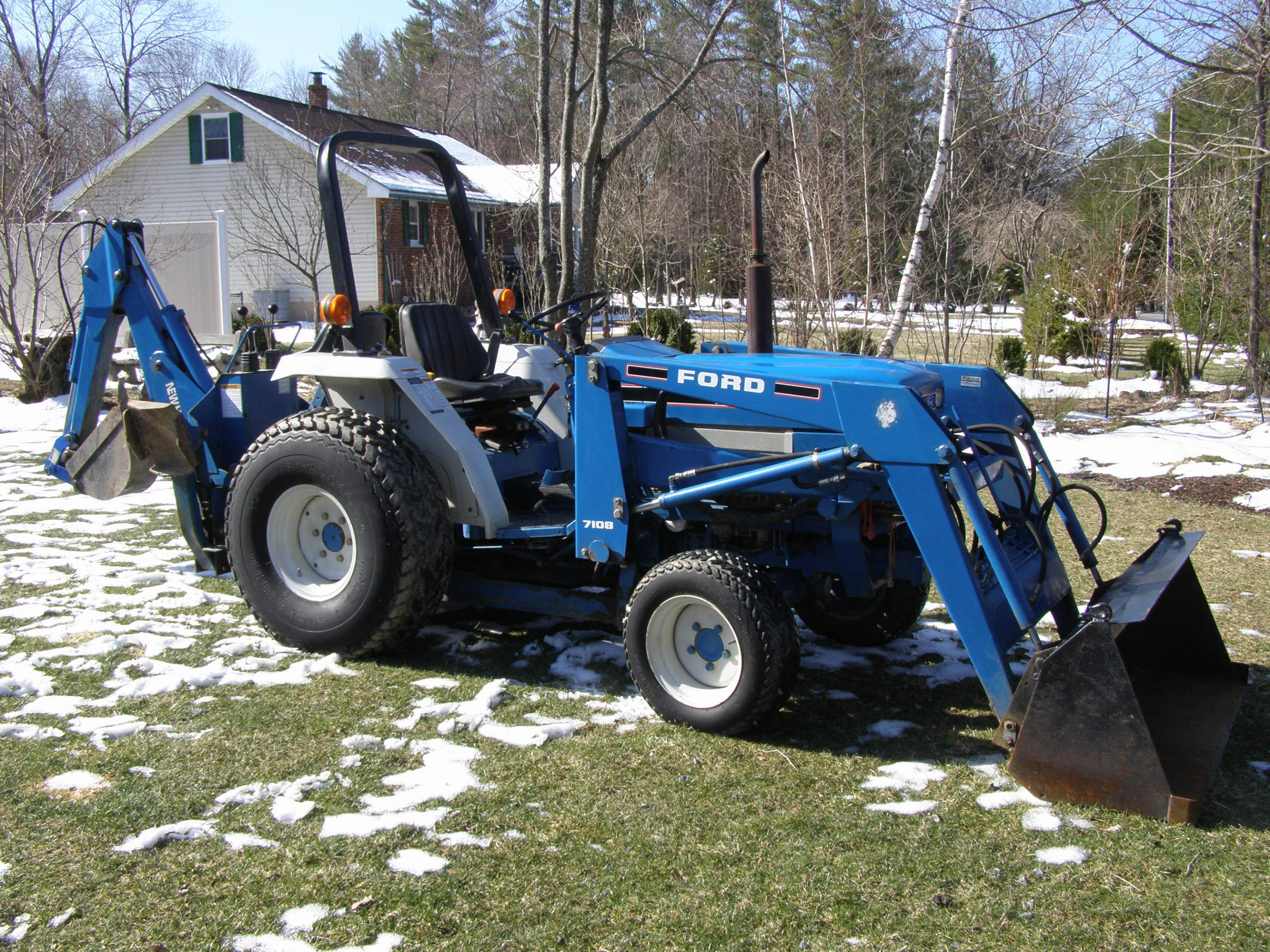

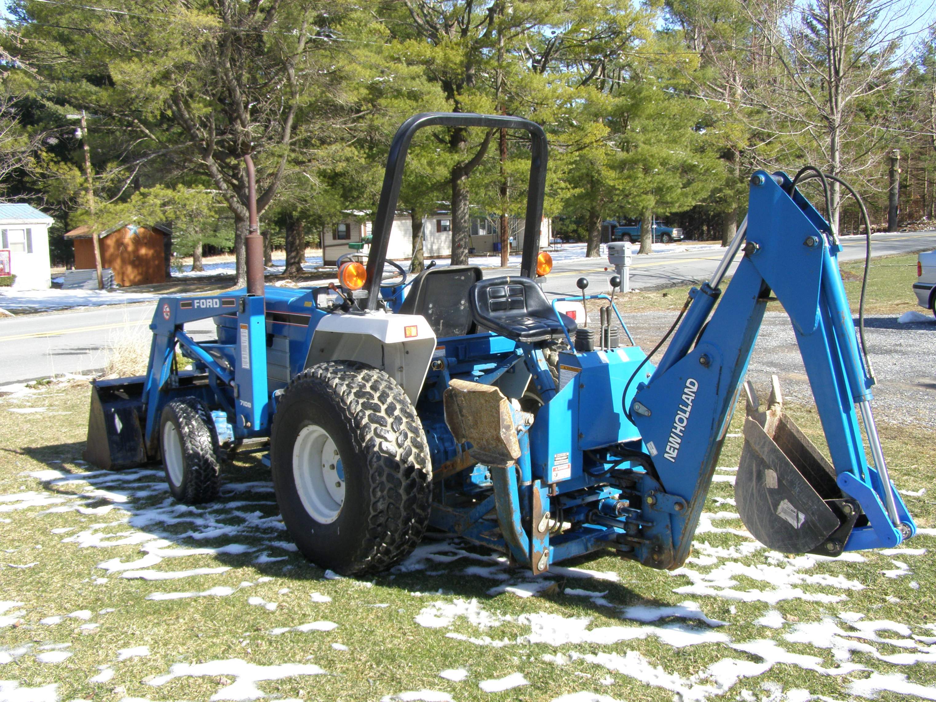

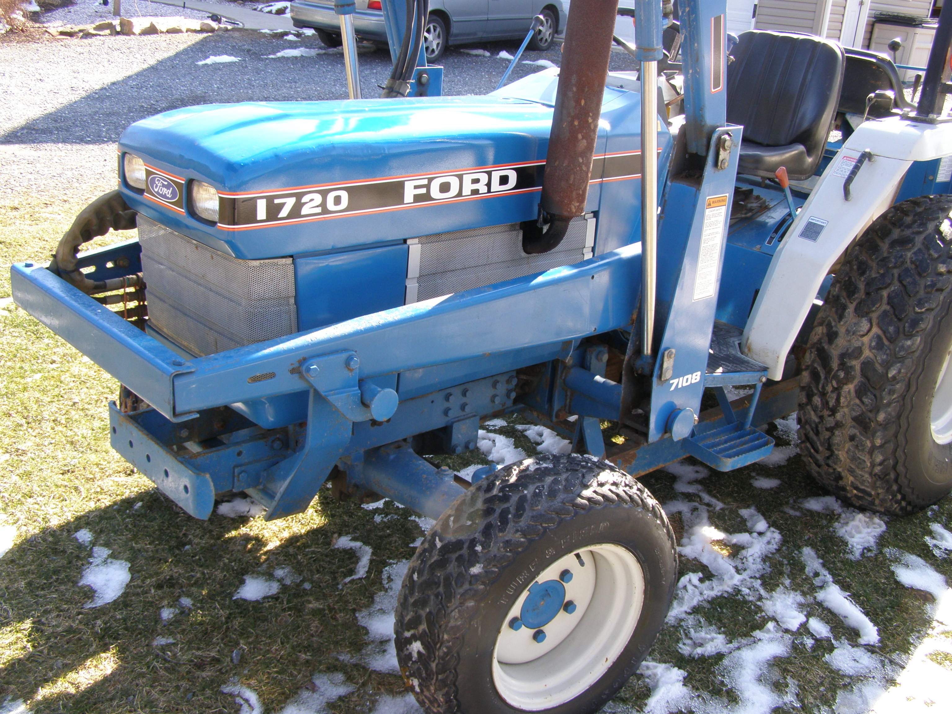

I just posted mine on craigslist.. .. here are some photos.
