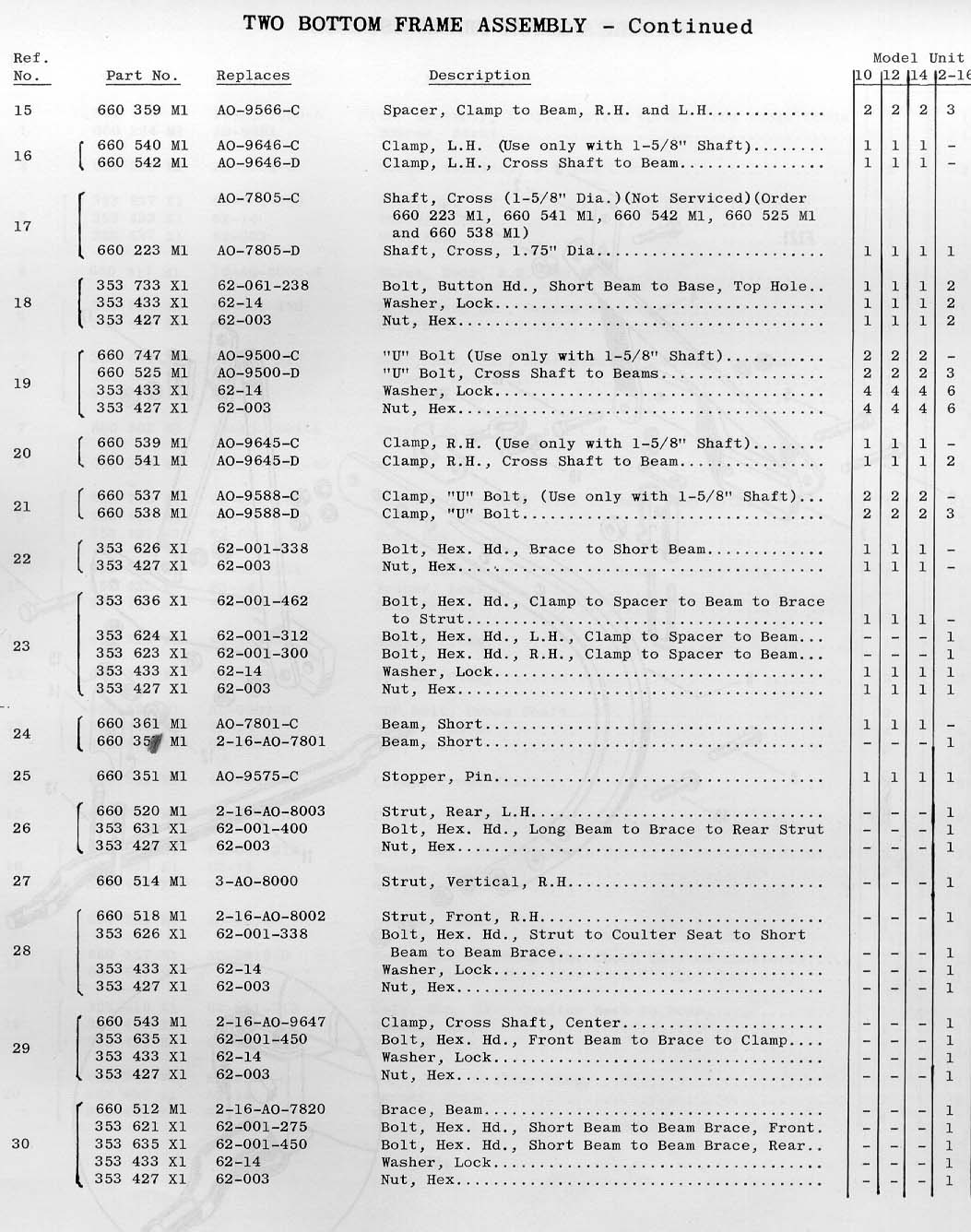

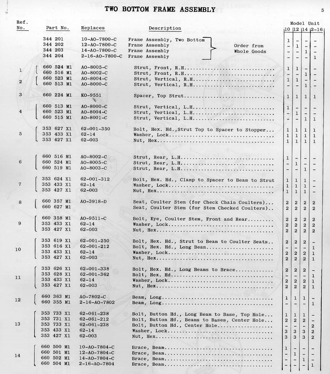

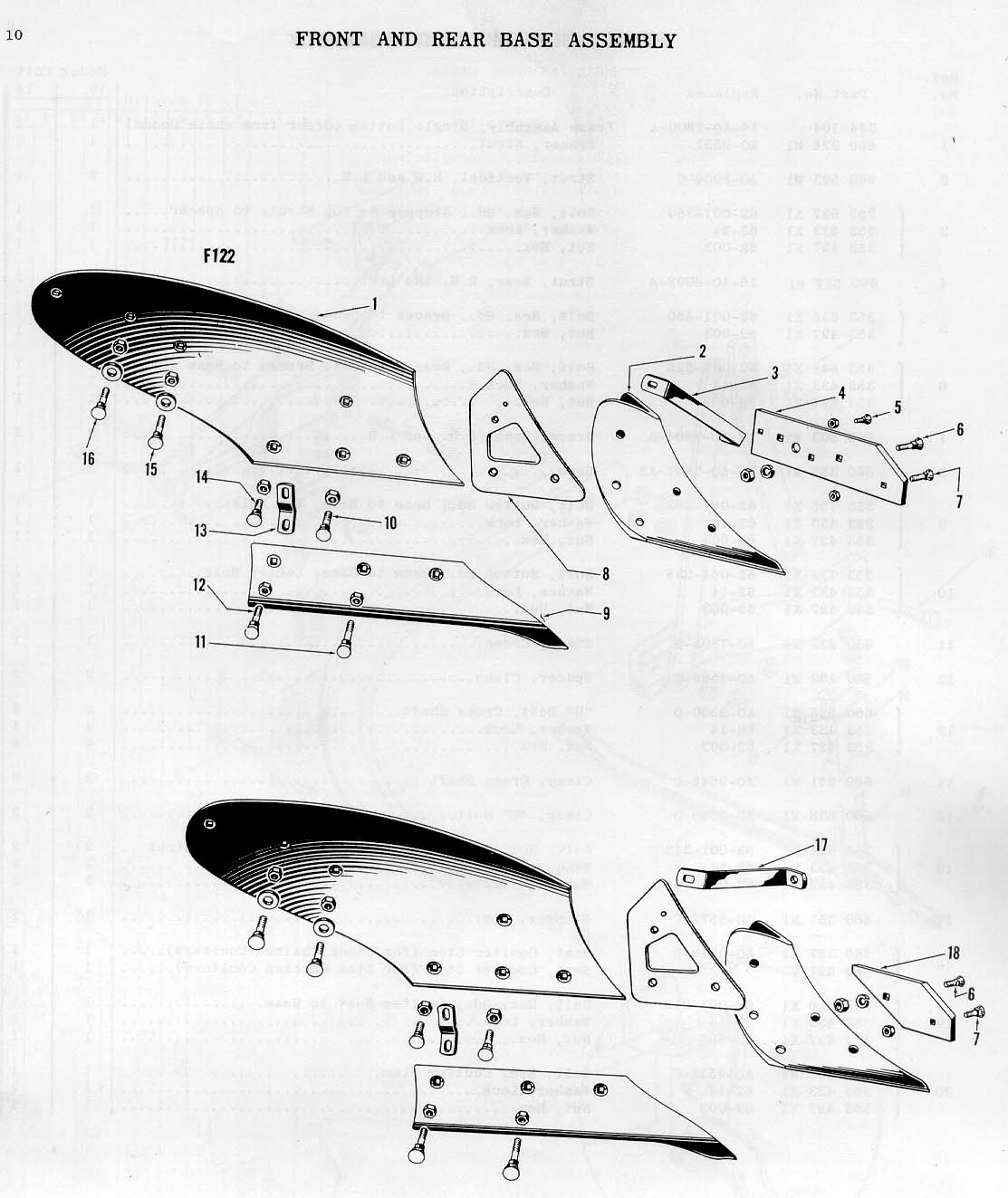

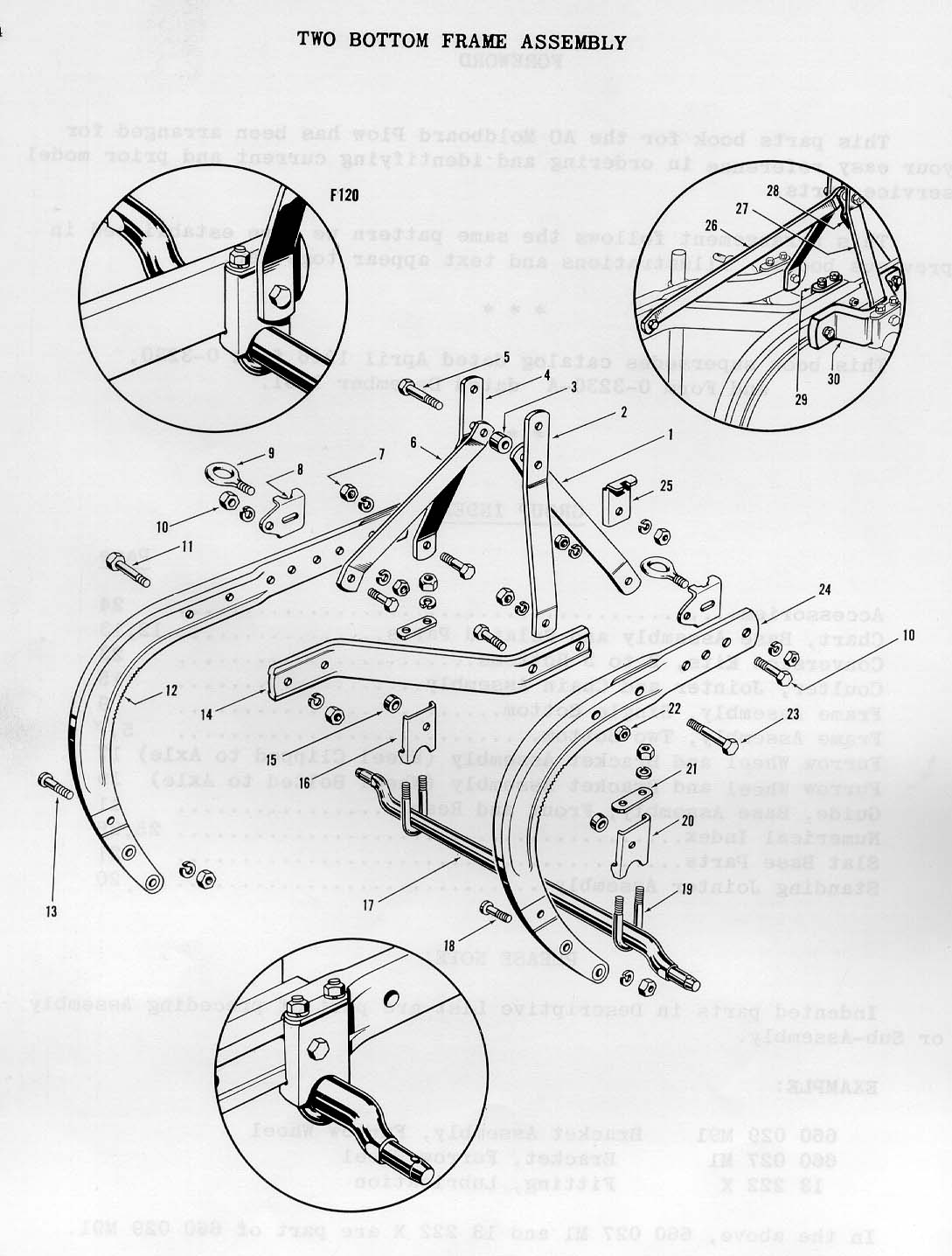

No ideal where to get parts but here is a part break down. Just might be helpful.
