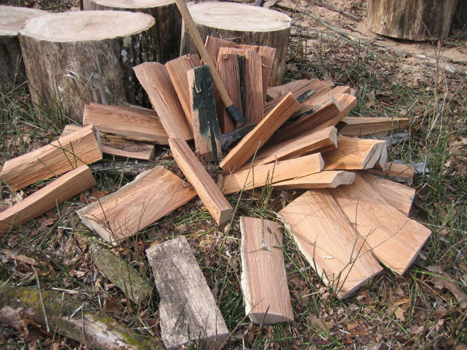

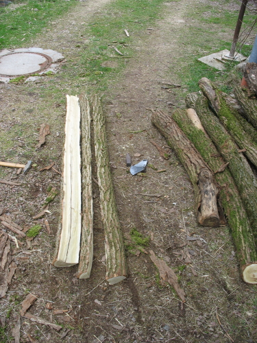

Judging by these two pics its pretty obvious the difference.
I can't say for sure about the locust, but the red oak around here resembles
the first pic.
These are googled images BTW.

Thanks for the photos. The supply we received today seems to be split between two species. One is yellowish in color and has very little smell to it. It seems a bit harder when I pound a nail into it. The other posts are a bit more pinkish in color and they have a stronger odor. They really do look like two different types of wood.
