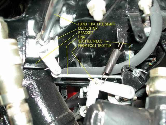

Hmmm... think mine may be different than yours Andy, but I'll attach two photos of mine and it may help locate stuff. This photo is from the side.

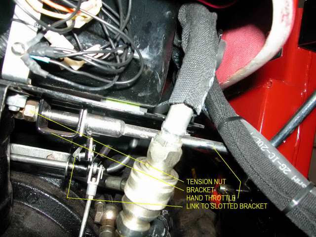

And this one is looking under the dash from the drivers seat.

Dear ToolManRick, I'm impressed. Those photos, text and arrows are quite the business, thank you. Now that's the way to solve a problem. I wish I could attach a photo of my problem right now, but the tractor is in a friends workshop and it's not going to be possible until Monday. However, we do not have the same set up. You have a horizontal shaft/bar that must stick out on the right hand side of your tractor. Going up and down at the handle/arm end. Mine comes out of the instrument panel and move forwards and backwards. My bar is almost horizontal. I recognize parts of your setup that I have, the bracket for example, totally redundant now with the change from horizontal to vertical shaft/bar. RickO, does your tractor have shuttle shift? All the best Andy
