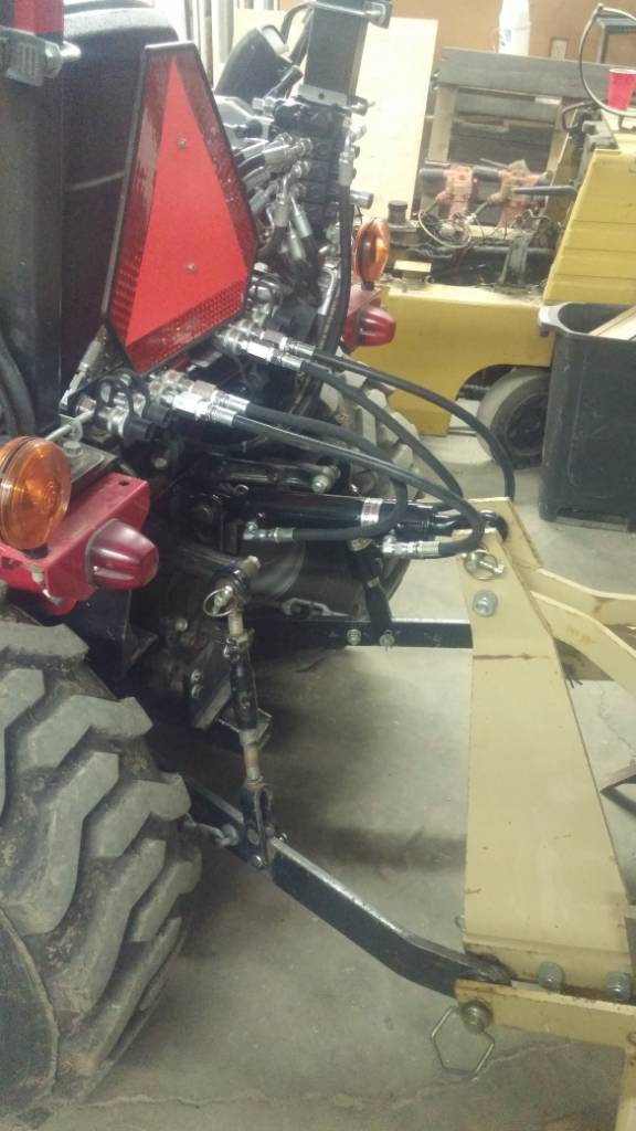

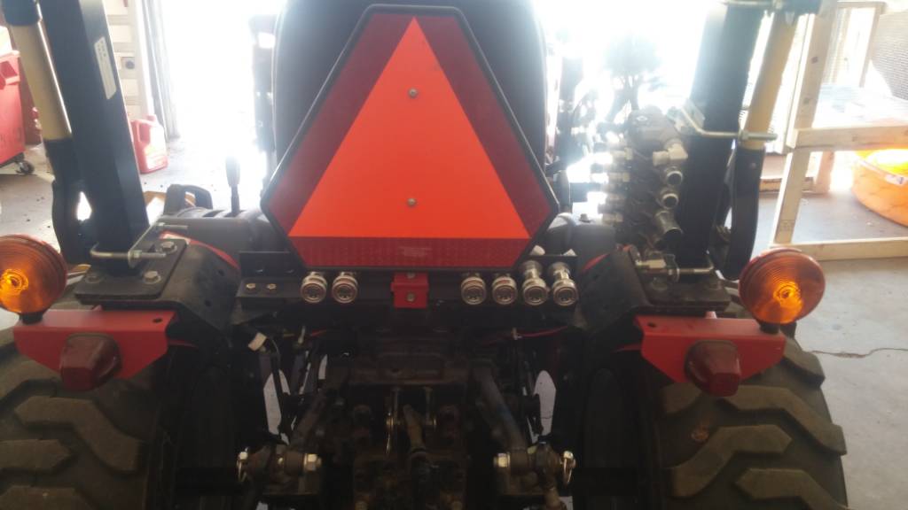

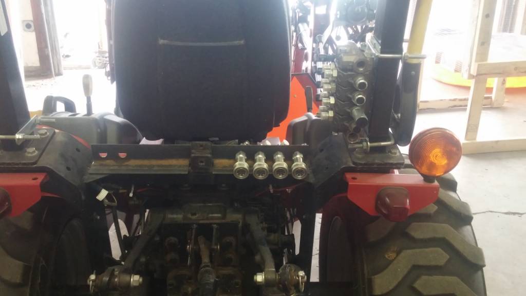

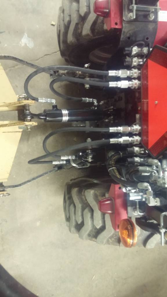

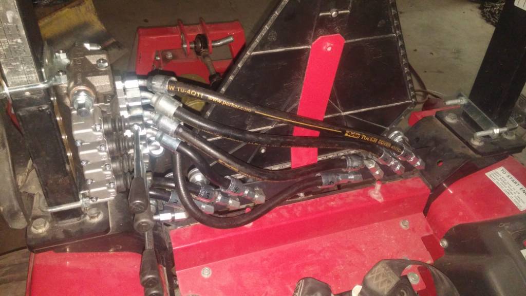

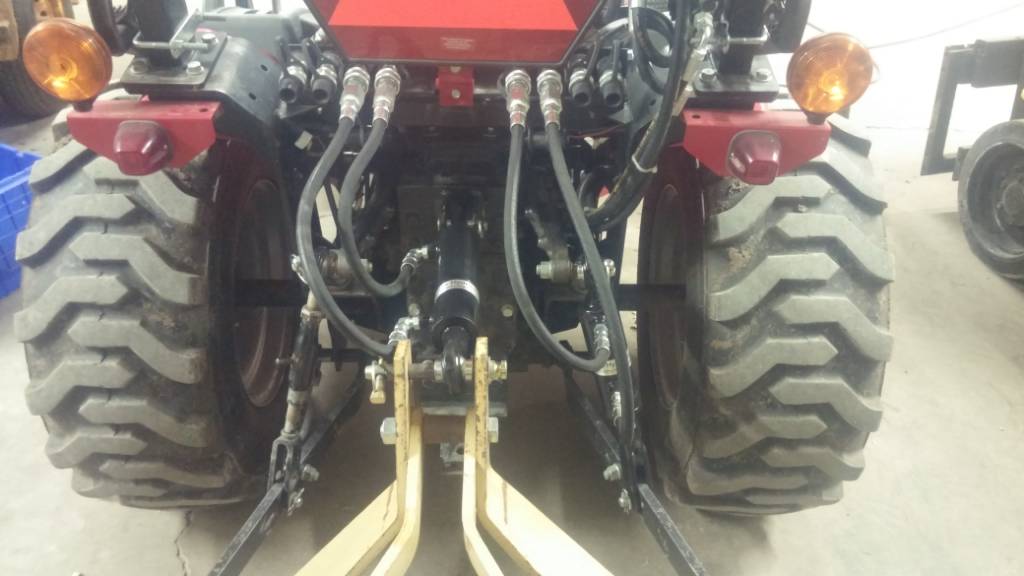

Hello millzentor I also own a mahindra max 28 and love it. I have personalized mine quite a bit one of which rear hyd was one. It is an open center system so it wants to have a constant flow to function or tank. I Plumd mine in between the loader and 3pt order of operation. Geting pressure from power beyond port on loader valve running to valves in back. Then placed a T in the tank line. So loader valve and rear valves share back to tank. Then because you need pressure going back to the 3 point I plumbed power beyond from rear valves into the line that originally went from power beyond off loader valve. I hope that makes sense. Because you have a backhoe it should be much easier you already have pressure line and power beyond the two you would have to connect together if removed backhoe and the other is just back to tank. So loader on mine takes priority then my rear remotes then 3 point. I have a top and tilt cylinder they are the best highly recommend. For the third function up front I have yet to motify but it would be about the same with just a electric valve. I hope I have helped a little .

AJ623max28, love your setup! It looks like you've a 4-spool? What attachments are you using on the 3 point that you need the rear remotes for? I thought a 3-spool with one having a float would be nice. I could connect the float to the top or side link, depending on needs. What size cylinders did you end up with for the top and side links? I had thought about using one of the remotes for BH hookup if that's possible. Guess I'd have to tee into the return to tank and have a quick coupler for the backhoe return to tank line? Apologies for so many questions.
   / Help a Hydraulic Newbie #7
Yes I have 4, 2 are normal spring to center valves, 1 is spring to center w/float, and the last one is a motor detent valve. I use mostly 2 for top and tilt cylinders I hope to get another tilt cylinder some day so both arms on my 3pt are hydraulic allowing more angles. I got mine from Fit Rite Hydraulics I could have made my own but for the money and time I would be into it, I figured I would purchase them and work on other projects. I'm glade I did the quality and support is amazing. Only down fall is the wait time. I have many projects on my list I need hyd's for to list a couple log splitter, press,pipe bender,etc... The way I was going to operate those was the motor detent to another valve on the attachment. Meaning I could start the tractor detent valve in direction needed hope off the tractor and operate the valve on the splitter or press. I hope that makes sense. I personally wouldn't run a backhoe off the motor detent because the flow will be restricted a lot more through the valve causing oil to heat up a lot. If I where you I would some how make the valve block quick attach so unhook backhoe and instead of reconnecting lines together attach all 3 to valve block for rear remotes.
