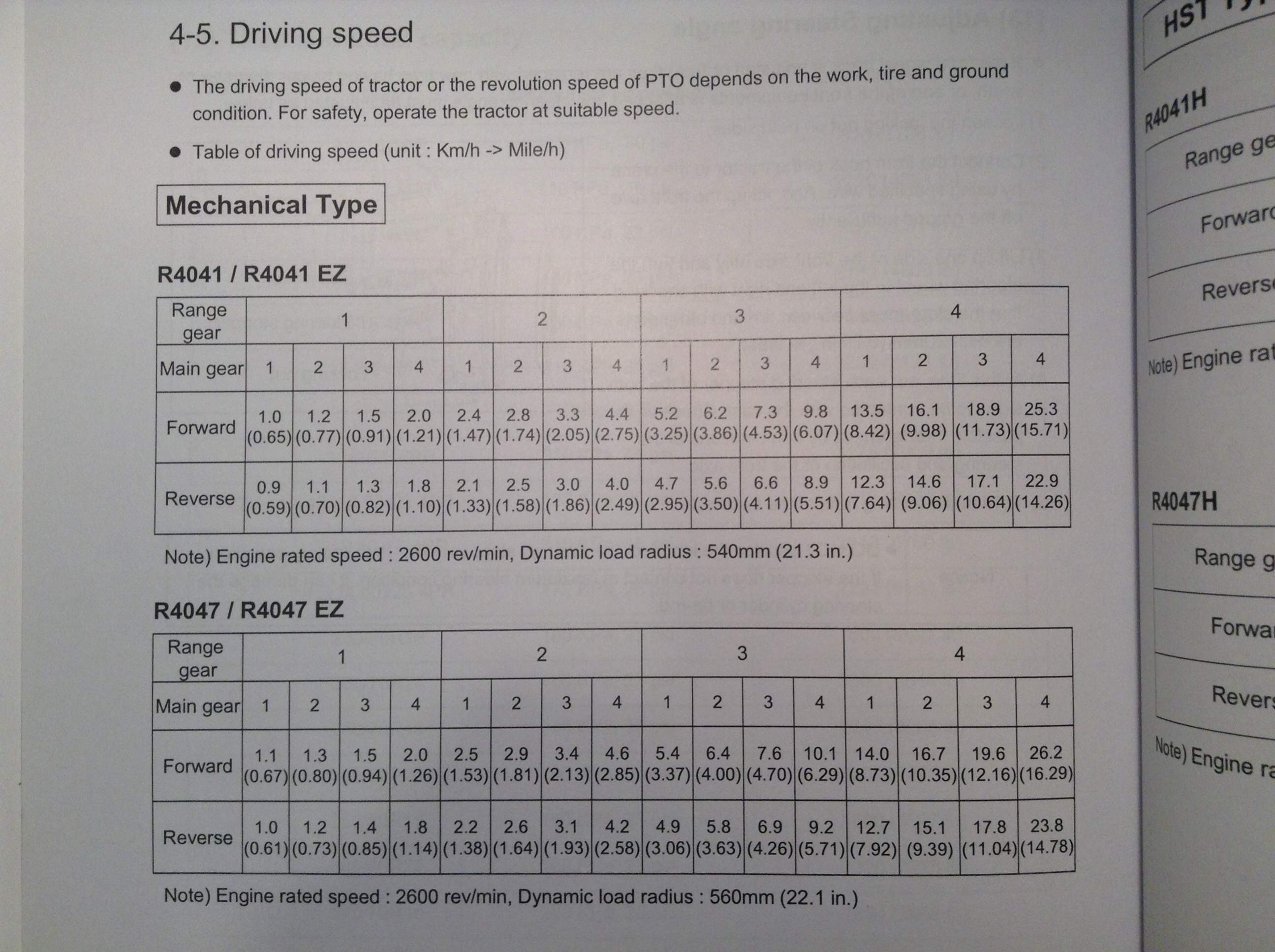

I bought my tractor used and did not get the owners manuel.I need to know the speeds for each gear so I can set my fertilizer spreader for seeding wheat.
Any help would be appreciated.

Here is a picture direct from the operators manual. Hope this helps.

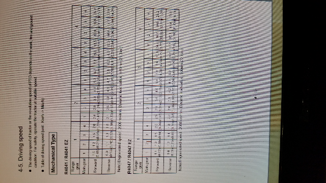

This might be a better picture from my manual;

Thanks guys got my wheat seed spread tonight.Ordered manuels this morning should have them next week.
