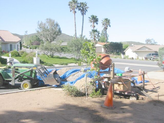

I ended up mixing the concrete with one part Portland, two parts concrete grade sand and two parts 3/4 inch rock. I purchased a Harbor Freight Mixer that was on sale. It worked great, pretty light duty, but mixed the concrete well.
Last summer, I stopped at the local Taco Bell for a Burrito. Their flag pole had been hit and knocked down the previous evening. Happend that the manager waited on me and when he asked what I wanted, I replied "Thought you might have a flagpole for sale cheap". He said to "take it, just get it out of here as soon as you can". Next day, I took the trailer and picked it up. A little research on the internet valued the pole at about $2000. I removed the broken part remains of the cast aluminum mount, found an 8 inch steel pipe 5 feet long that I made up sleve (next post), put together a re-bar framework, dug a hole 36 x 36 x 42, built a form to extend 2.5 feet above the ground (makes up for the 28 inches of pole damage (most of which I repaired).
It worked out very well so some time in the next couple of weeks, I will set up the pole. I have made up a boom pole to mount on my John Deere 420/Johnson Loader to help set up the pole.
I will post more photos then. (Photo of sleve/form on next post.

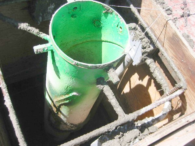

This is the sleeve and form. I had started mixing when my wife took the photo.
I will post more photos when I set the pole up.

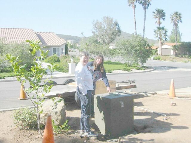

The attached photo was taken Monday morning after "de-forming" the base. My wife and mother-in-law gave me their approval for the work. It will be covered with veneer stone. The cement seems to be curing nicely. I have a blanket covering it and wet down several times a day.
More photos when I rase the pole in the next couple of weeks.

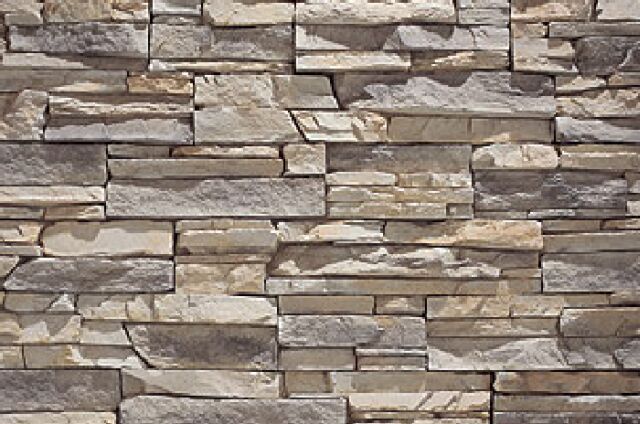

I have done a lot of building with wood and steel but my masonery experience is pretty limited. I had planned to use Eldorado Stone (probably their Alterwoond Stacking Stone).
This is a photo of the Alterwood Stacking Stone
