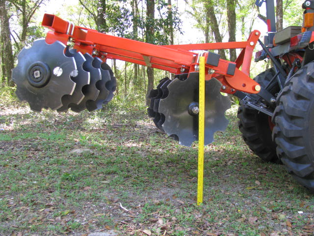

The lifting capacity of FEL and Three Point Hitch hydraulics decreases rapidly with height. You may be able to pick up a pallet of bricks from ground level with your tractor FEL, but lack hydraulic power to lift the pallet of bricks to the level of a pickup truck bed.
The advantage to a higher lift on the Three Point Hitch is the ability to handle heavier implements. Bear in mind that long implements, such as Disc Harrows and Bush Hogs, protrude far the the rear, requiring much more lift capacity than implements mounted close in, such as Cultipackers, due to adverse leverage.
When loading a trailer with a tractor and a mounted implement it is often necessary to lift the implement very high.
BUY ENOUGH TRACTOR.

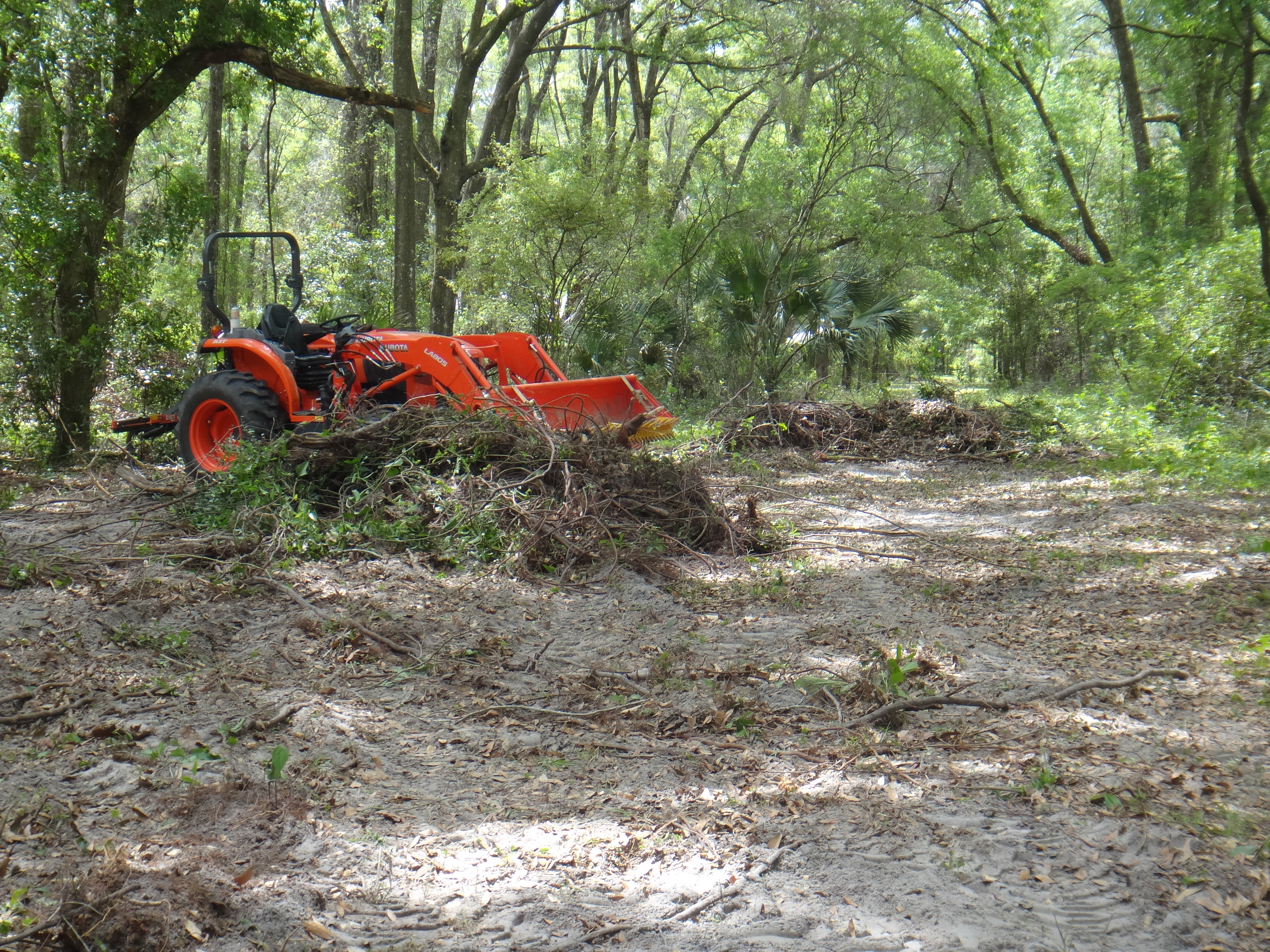

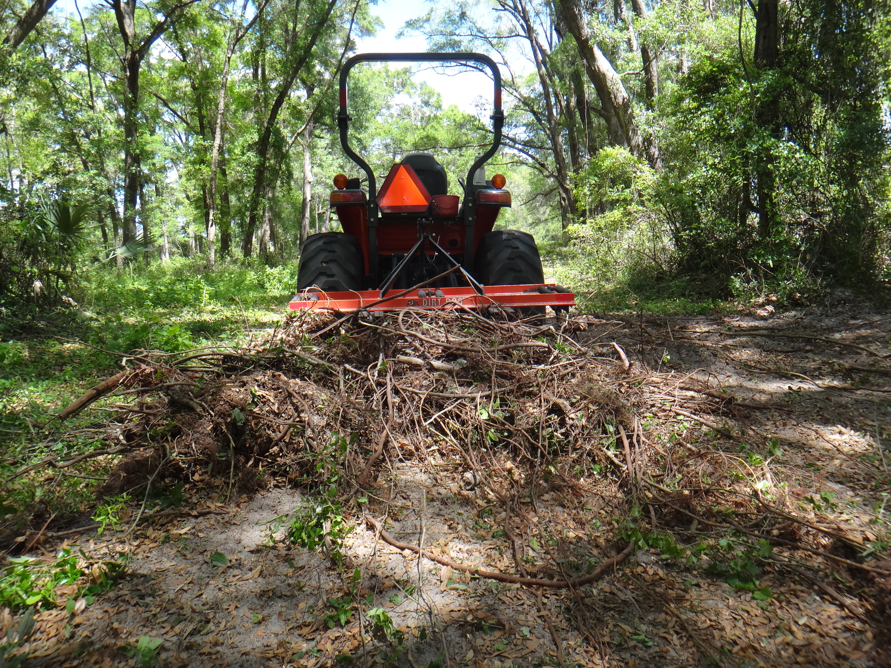

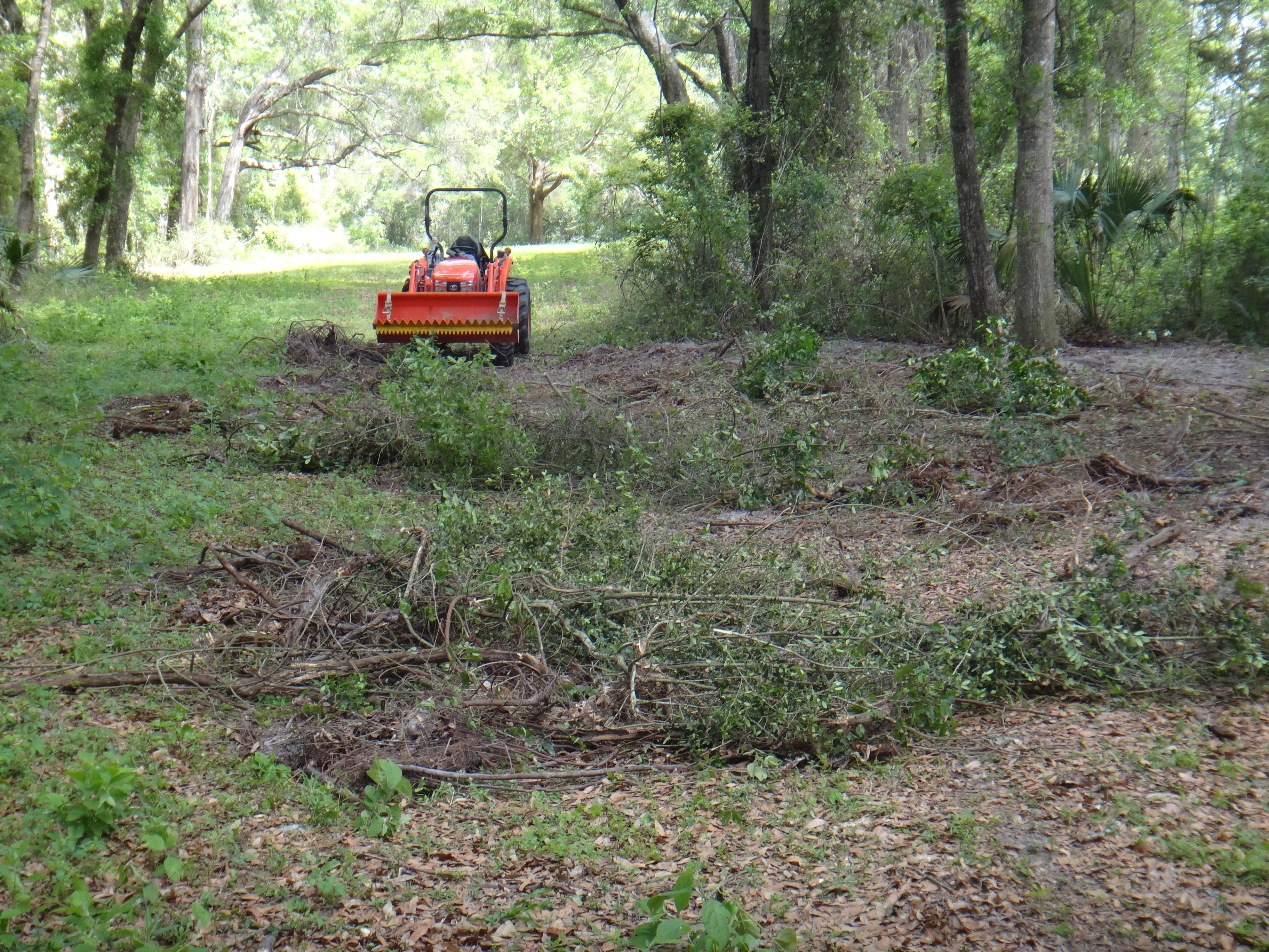

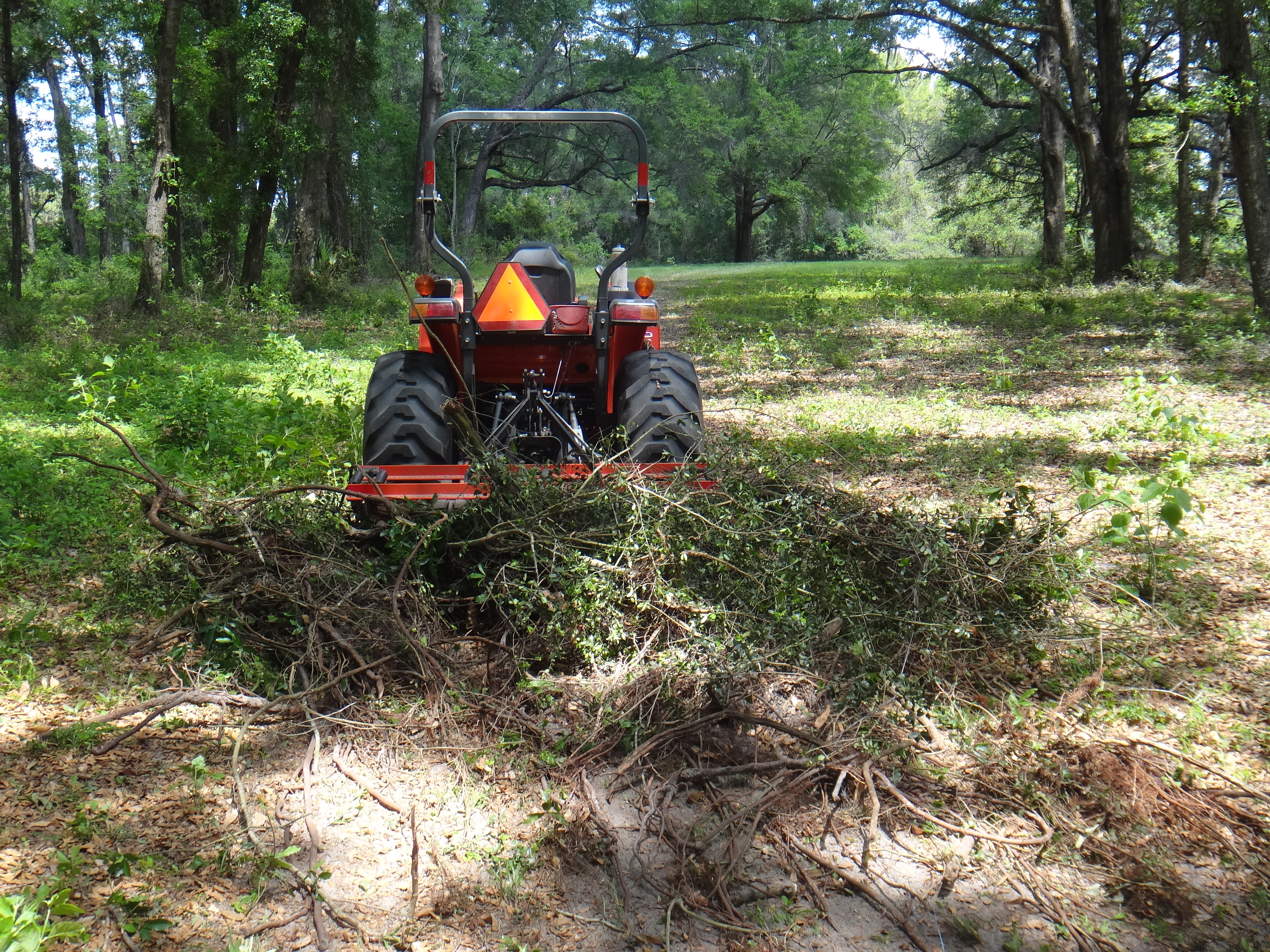

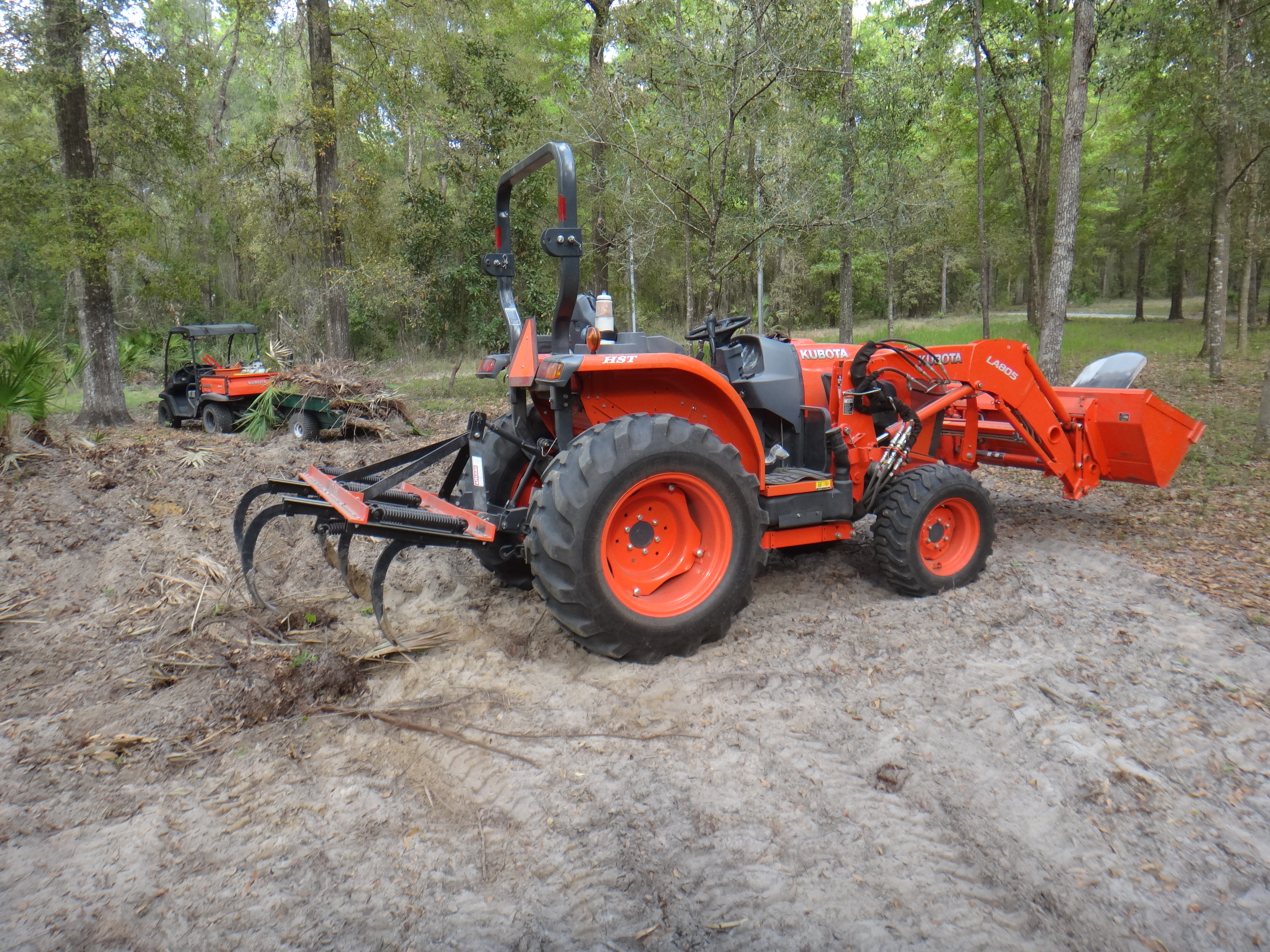

My neighbor believes I need a 60 HP tractor to clear out and maintain the 6 acres of undergrowth in the pines. He says I'll end up tearing up a 35-40 HP tractor working that stuff. The 60's - by Kubota & JD - have MSRPs well above what I would like to pay.
Check out Kubota MX series.
Horsepower is irrelevant until operating a PTO powered implement. The key metric is tractor weight.
I have 37 gross horsepower but 5,400 pounds operating weight, not bare tractor weight. Greater weight derives from thicker steel in constituent components.
Ratchet Rake bucket attachment is the premier tool for clearing and piling undergrowth, work I was doing yesterday. Alas, Ratchet Rake does not serve to transport debris 1/4 mile from this site to our community burn pile.
For transport, I use my Field Cultivator mounted on the Three Point Hitch to drag debris without dirt. Fish hook tines grip snarled debris piles.
