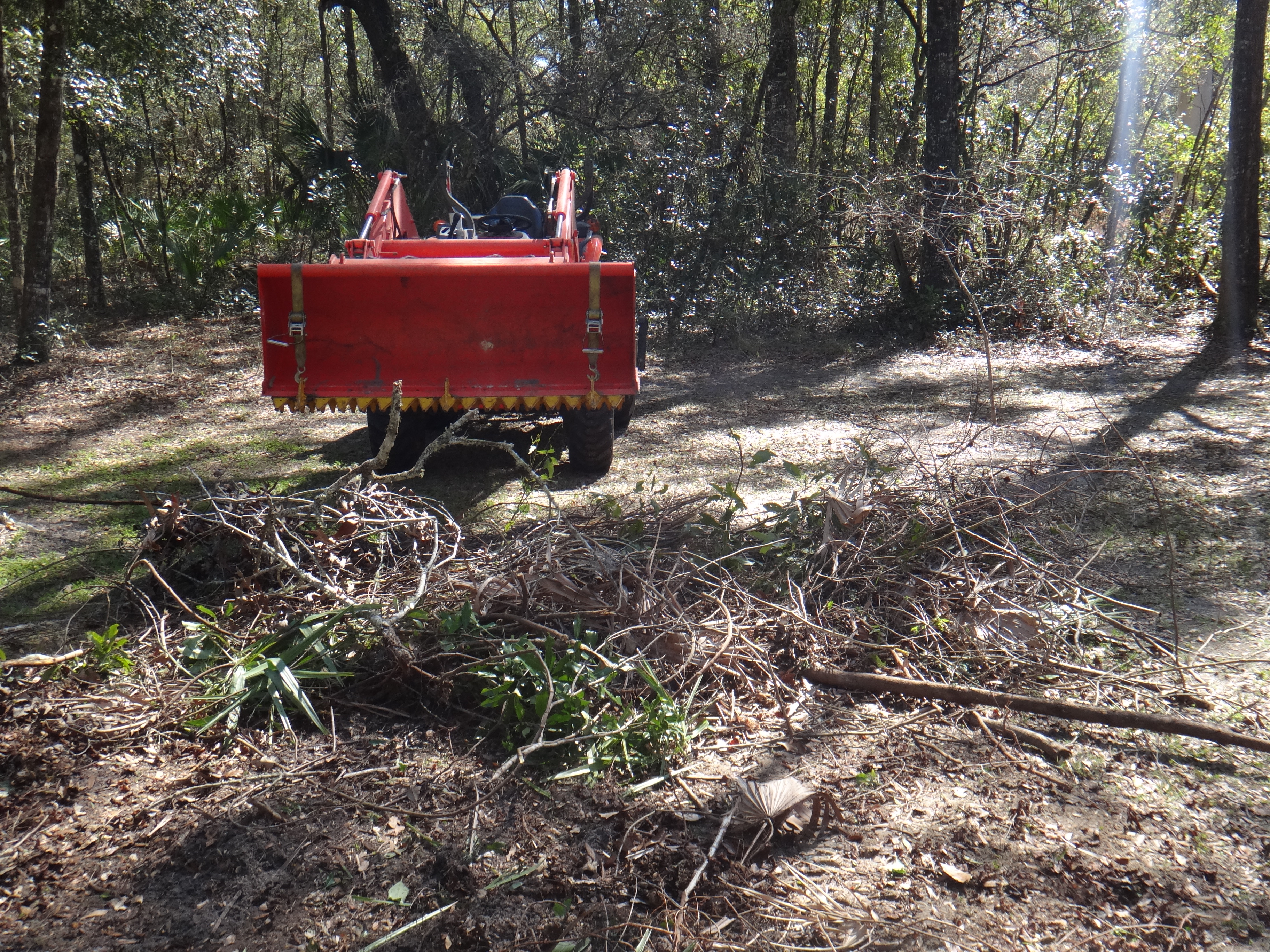

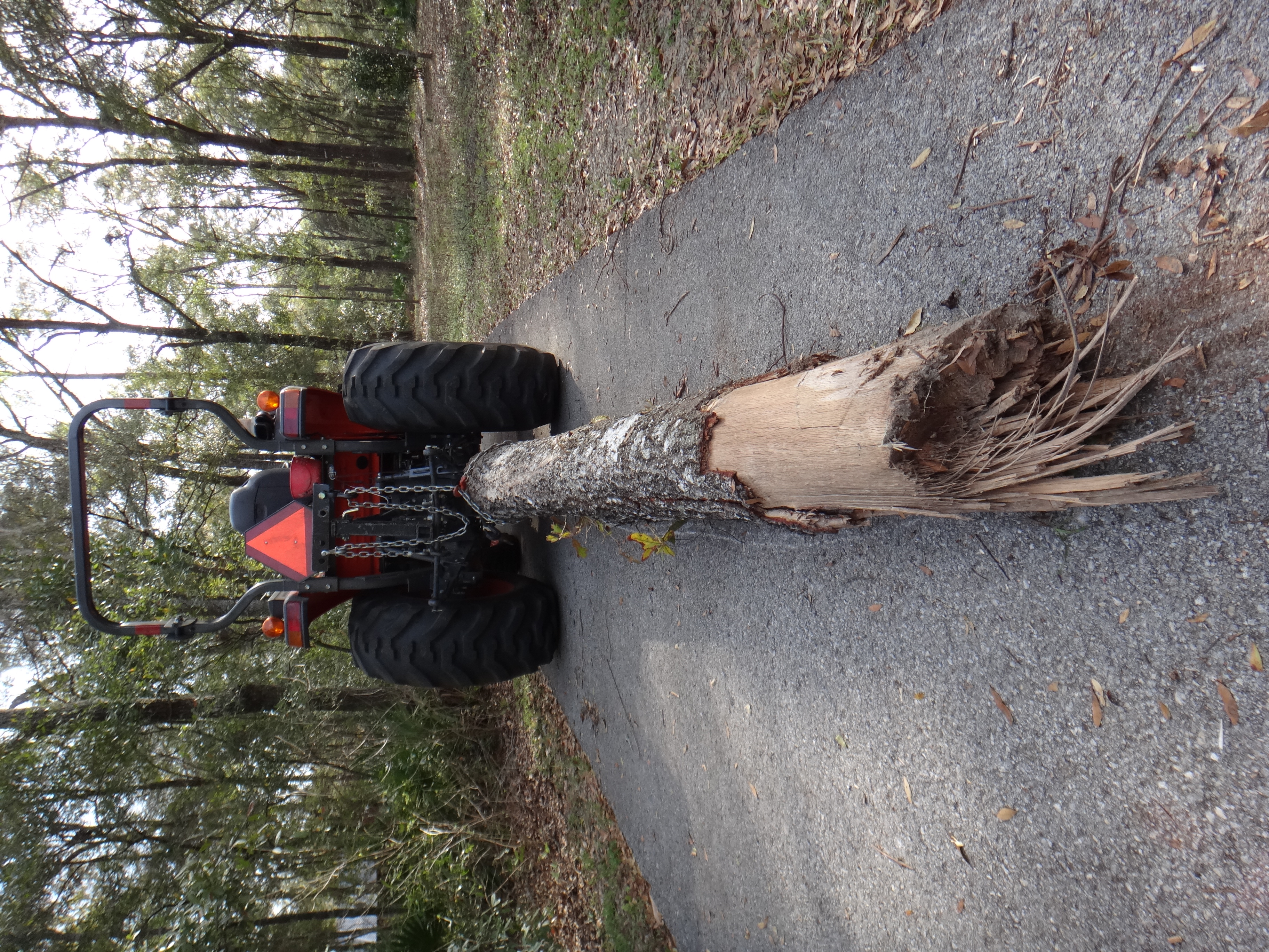

Sorry, inadequate proof reading. I have an L3560. It has split rear wheel brakes on the left and the single HST pedal on the right.
http://www.kubota.com/product/LSeries/L60.aspx
http://kubota.com/assets/product/Comps/L60/GrandL60ModelsCompPDF.pdf
As for age I'm 46 with back, knees and shoulders already aching. 23+ years on steel decks and steep ladders of Navy ships taking its toll.
You will probably rejoice after spending the additional money for one of Kubota's Grand L models.
Most tractor manufacturers have a fully featured model in their line up.
My L3560 was $27,500 in January 2013, with following options: LA805 FEL, L2296 Heavy Duty, Round Back bucket, Draft Control, R4/industrial tires, dealer install of aftermarket Stebl horn. No sales tax on tractors in Florida.
kubota grand l 6 series tractors - Google Search
Tractor weight is your friend.
