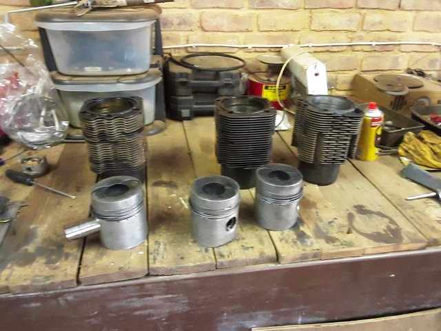

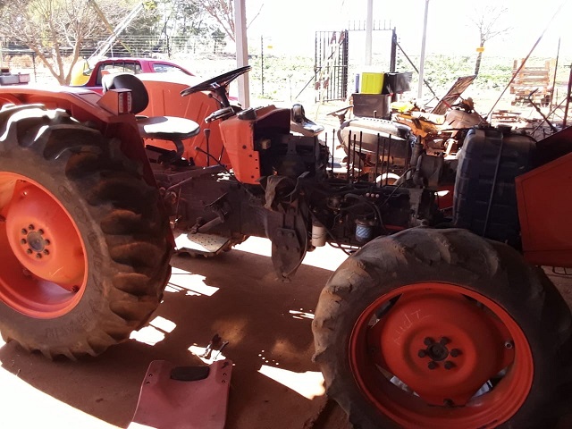

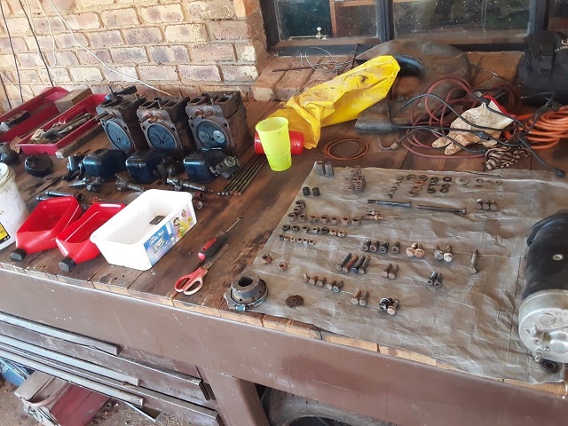

So a friend of mine had a Same Falcon 50 with a broken engine. He offered it to me, still parked at the repair workshop, disassembled for R10 000 ($500US) on the never never terms. We fetched it, and in all the excitement did not tie it down properly on the trailer, so it ran forward into the back of our bakkie (pick-up). It damped the spirit a bit, but we of loaded it and started packing out the parts like lego.

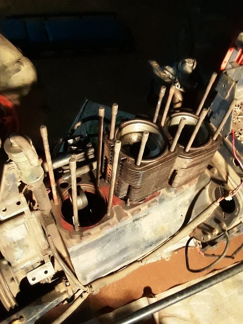

After checking the engine no and bore we realised its a Mintauro 60. We realised some of the piston rings were stuck due to being fitted upside down. After a whole day of cleaning, honing and burs removal, we assembled it and it runs good! thumbnail_IMG_7345 (1).jpgthumbnail_c55a9658-645e-4868-84c8-47aa0d8e33af.jpgthumbnail_388829bf-13cc-4ae2-a48a-50bfb1f999f6.jpgthumbnail_71965df0-203a-4433-974c-2e99c5e0348e.jpgsmall.jpgthumbnail_5cd2aac2-8514-4574-b57d-023057083d53.jpg

You mean Air cooled? It's a 4 stroke Same 3 cylinder air cooled engine. Very similar to the Deutz, VM and several others of the same vintage. These old air cooled engines will run forever.
