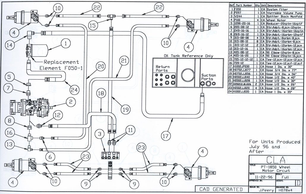

IMO, and that is pretty inexperienced, I too would look at the pump as being the culprit. 3K hours is a good chunk of time for a hydraulic motor. But, before you send it, I think JJ Will step in with a way to test it. My confusion is wether you would be testing the PSI or the flow on this one. If you can stop a wheel by hand then you are not holding pressure to the wheels. I guess JJ will say to put in pressure guage, maybe dead head the output pipe on the tram.

I have included a diagram for my tractor. Not sure about yours but it should be similar.

Two of the hyd wheel motors are in series and those two are in parrallel with the other two.
One or both motors in series could be bypassing/leaking.
Do your wheel motors have case drains?

As for your wheel spin, I THINK ( but can't be sure about your unit ), that the left front and right rear wheels are in series. Then your right front and left rear are in series. And those two circuits are in parallel. It looks like your left front is spinning. I'd think the right rear would be spinning a bit, too. If not, your right rear wheel motor is passing fluid to the left front instead of turning the wheel motor. When you are going up hill, more weight is transferred to the rear wheels. So your rears should be driving you up the hill. They aren't.
