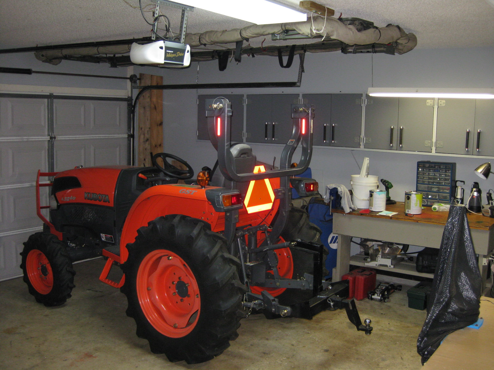

Can any owners of the L3240 or the L3540 please tell me the height of the tractor from ground to the folded rops? Let me explain why I need to know. Wondering if the Grand L's 3240/3540 would fit in a standard size garage door so of course it could be under cover?:confused:

Great question Devil Dog. I was looking at the L3540HST specs just this morning and circled the stated height of 94", wondering if that is with the rops up or down. I have 8' doors but 2" isn't much padding. I'm looking forward to replies to your question.

94" (aka 7'-10") has to be the height with the ROPS up.
With my L3940's ROPS folded down, it's close to head height, or 72" (aka 6') for me.

I grabbed my Grand L brochure:
L3240 overall height with foldable ROPS: 94.0"
L3540 overall height with foldable ROPS: 94.0"
L3940 overall height with foldable ROPS: 94.4" <-- for reference :)

If you intend on adding the sunshade at any point, please note that the ROPS will not fold flat. When the ROPS is in the down position the shade protrudes fairly high.
   / Height of Grand L3540 HST-3? #10
I have the 3240 and it is 77 inches with them folded.. I just measured mine.. I keep my in the garage and it is a standard height door and fits fine...
