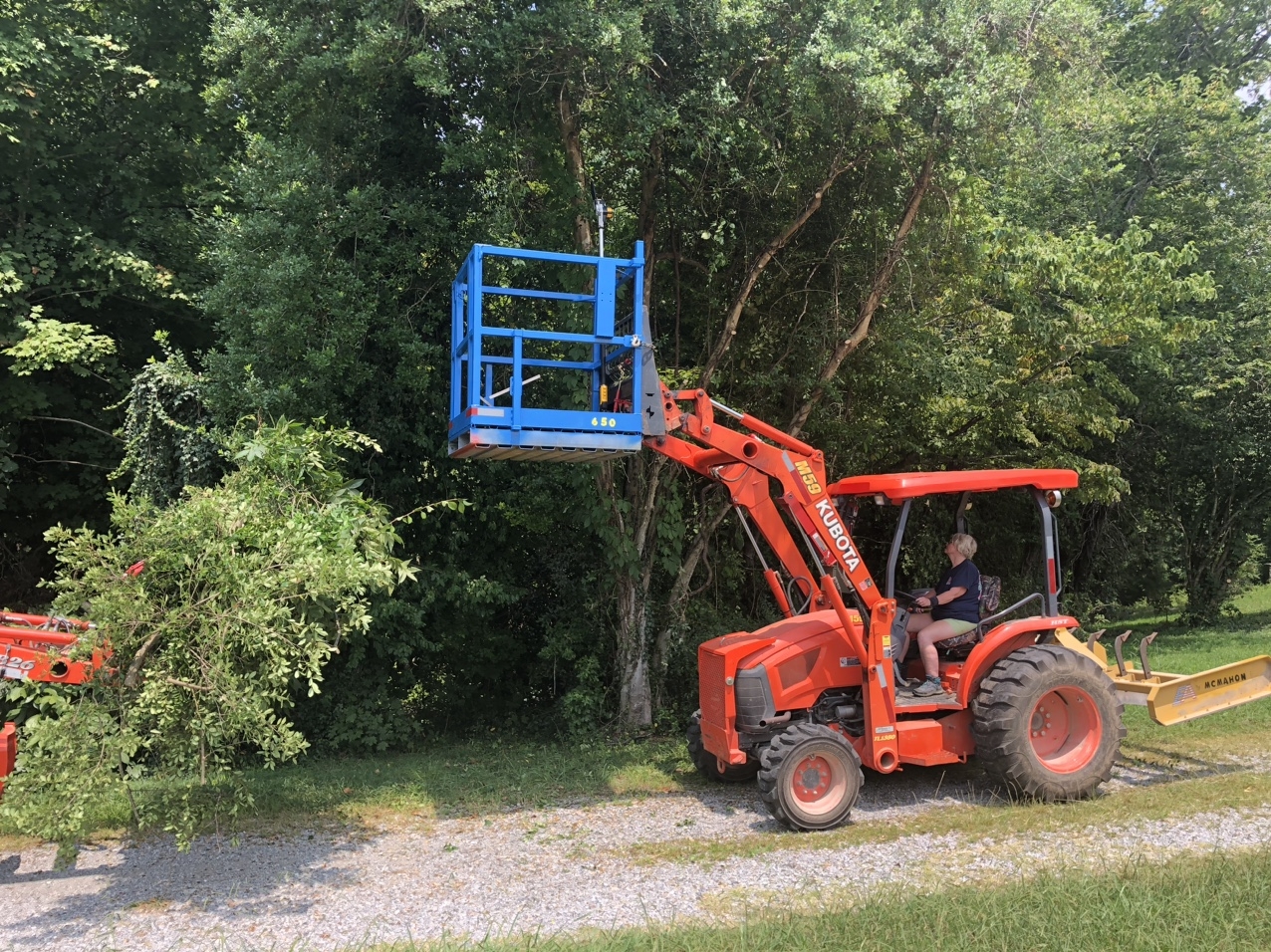

   / Hedge trimming - 3 point vs bucket mount #9
   / Hedge trimming - 3 point vs bucket mount #10
Two person trimmer. The DeWalt 20v polesaw and hedge trimmer works good.
