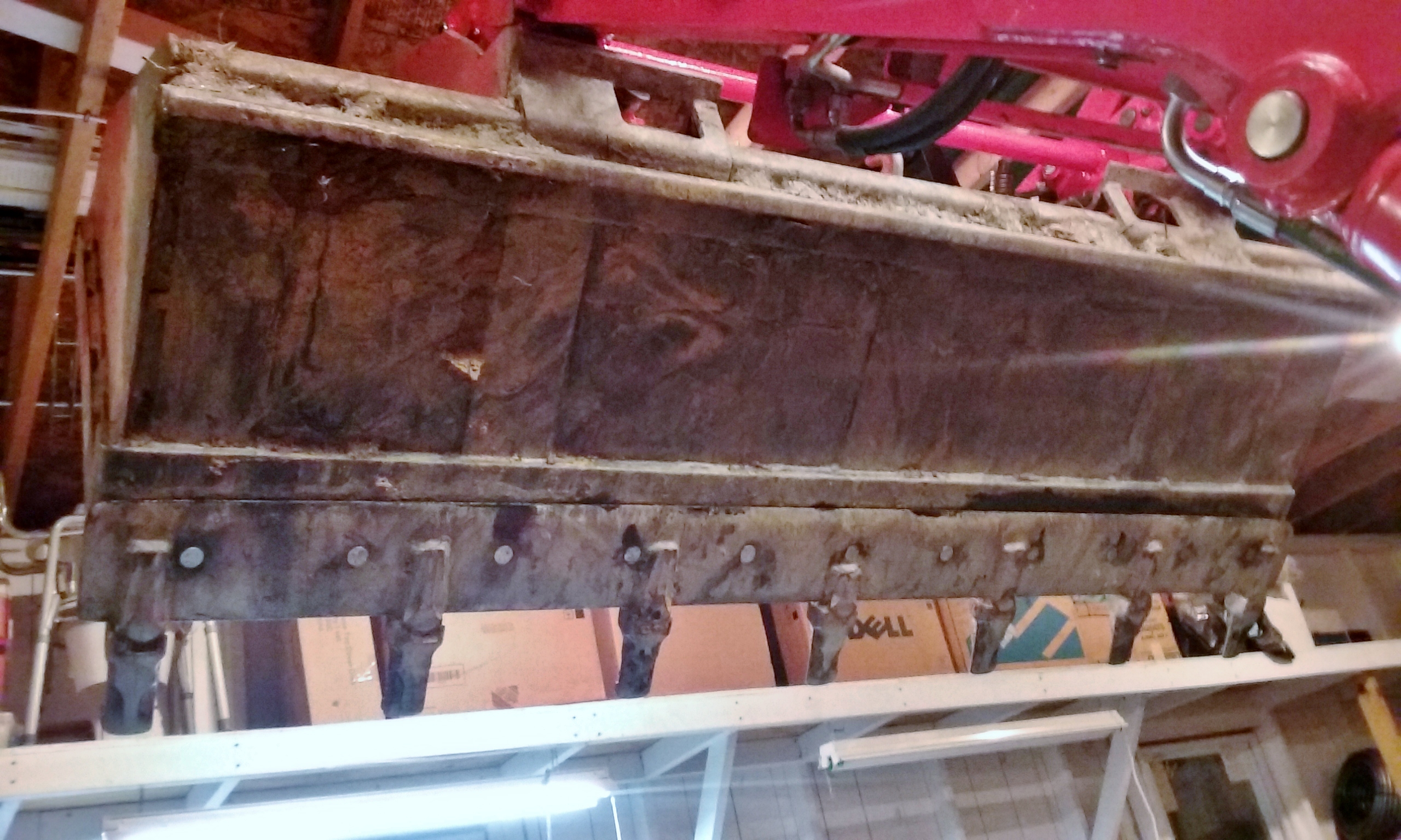

Just get an extra cutting edge and add ESCO teeth.
Much cleaner in the end
